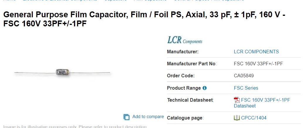

One final question. There are small mica caps (30pf, 200pf) that look to filter high frequencies. I hear they can be microphonic. Should these be replaced with PP or polystyrene?

It really depends what they do in the circuit but such small values suggest they are used for defining stability somewhere. Generally small poly or films would be better than mica.
Those are critical parts although 220pF and 33pf should be fine.
The ones I would use are these type. Put the striped outer foil connection toward the low impedance part of the circuit:
https://cpc.farnell.com/lcr-components/fsc-160v-33pf-1pf/capacitor-160v-33pf/dp/CA05849?st=capacitor
