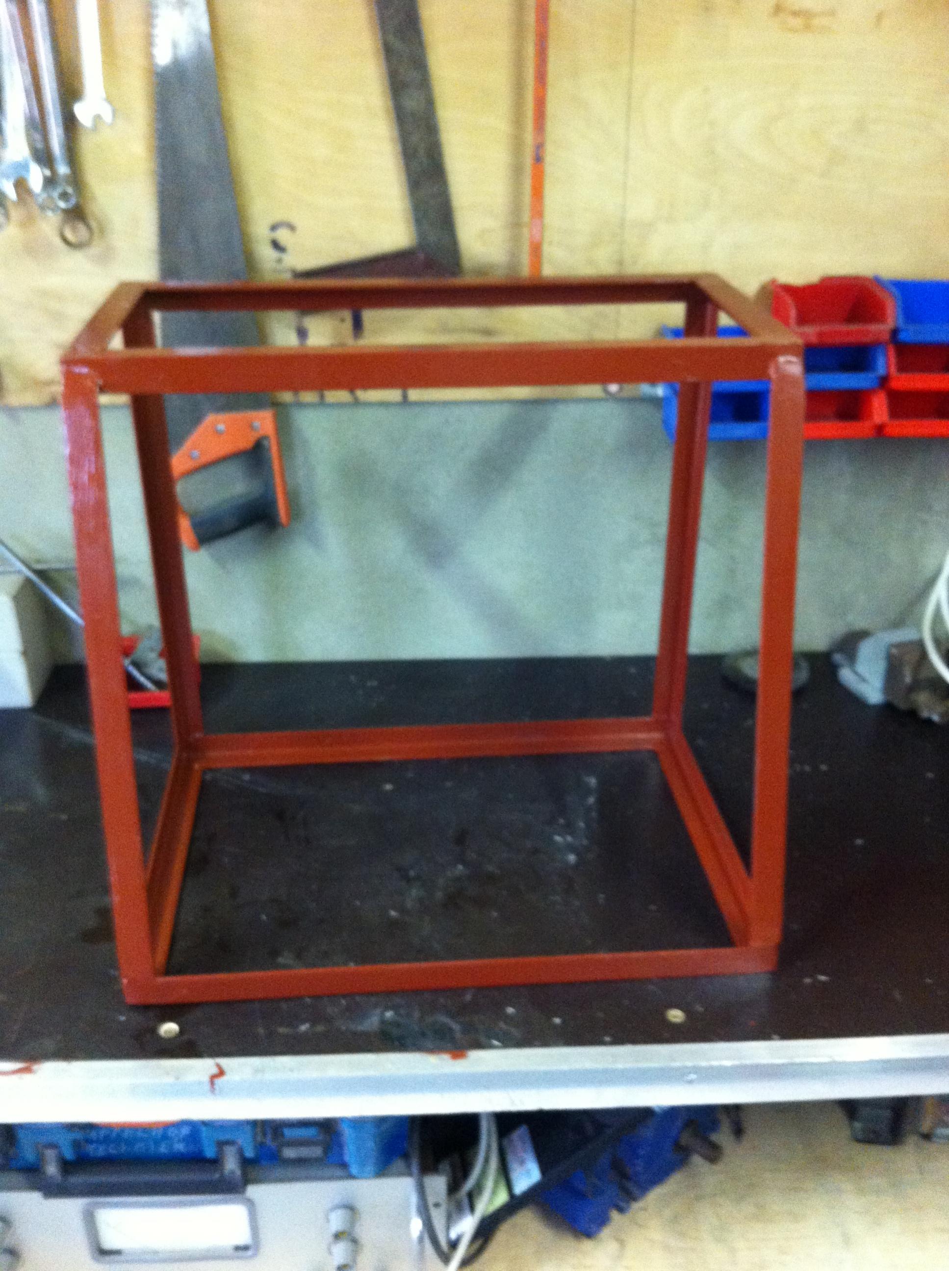

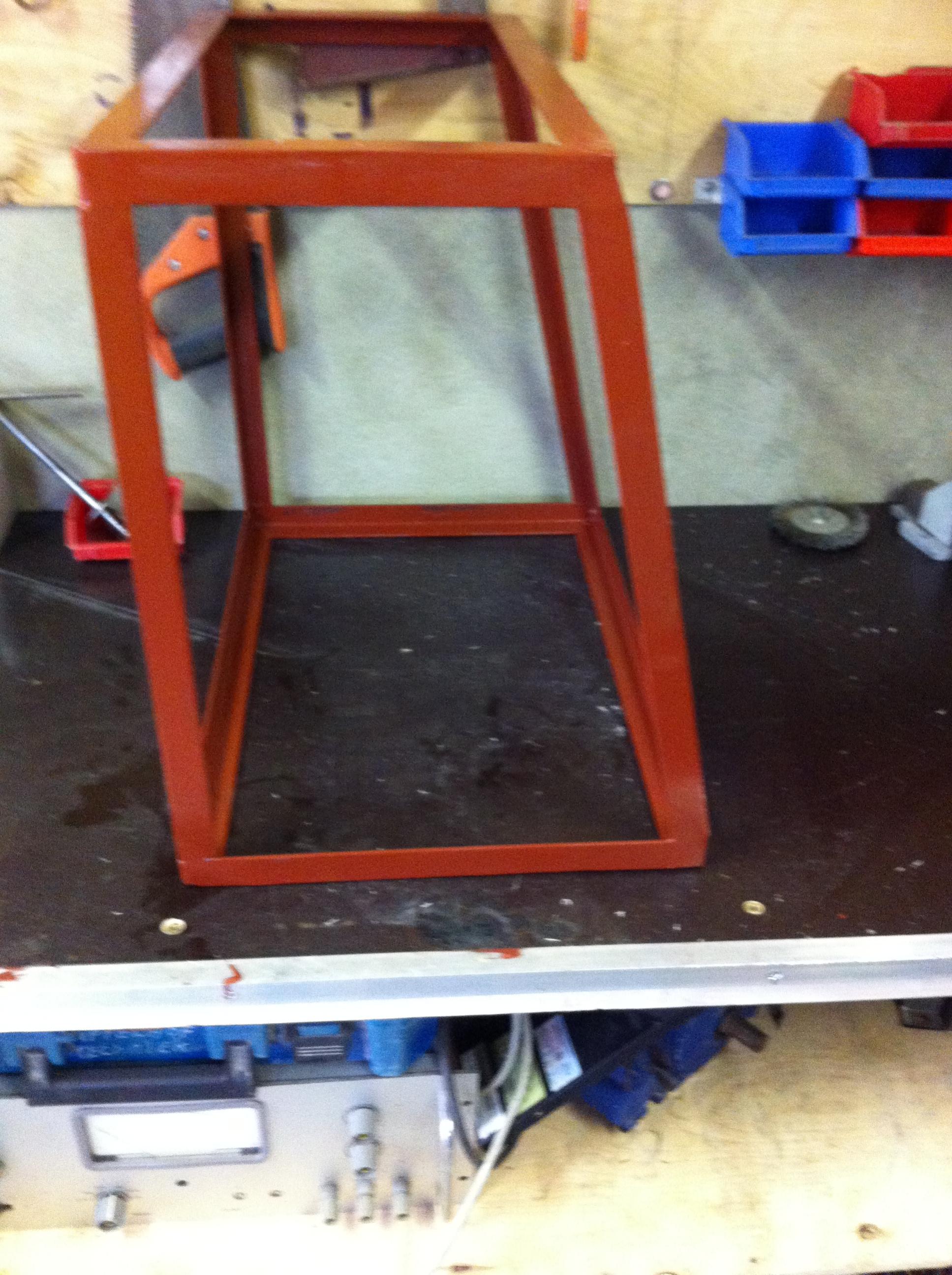

Recently I've started work on my own version of said tester.
I've so far completed the framework. dimensions are 50x35cm base 46cm high whit a 25x50 top plate.
I'm still in doubt whether I should have regulated screen and anode voltages as in the Metrix U61 or just variac controlled ones. Recently I've acquired two 0,7A variacs which are perfect for the job.

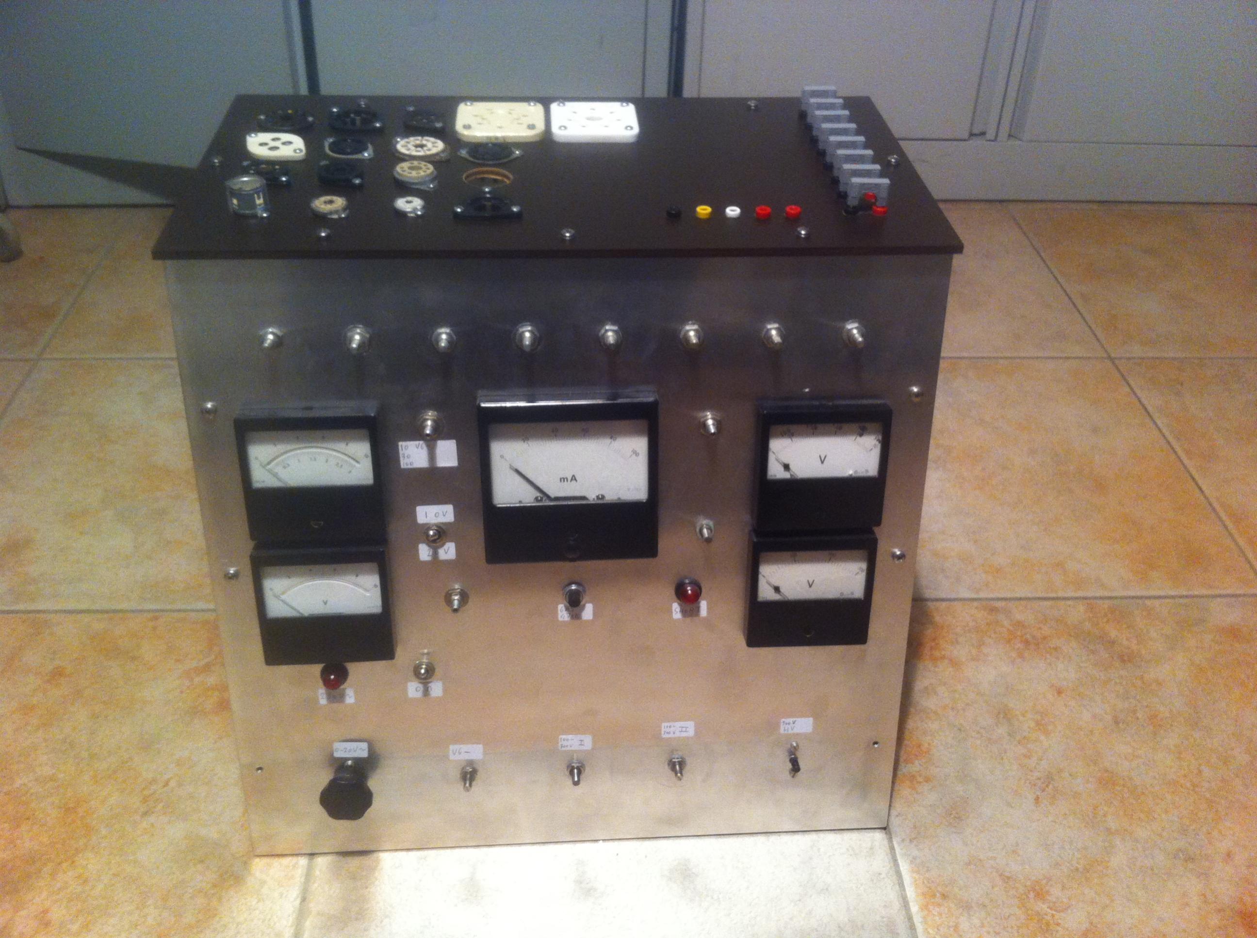

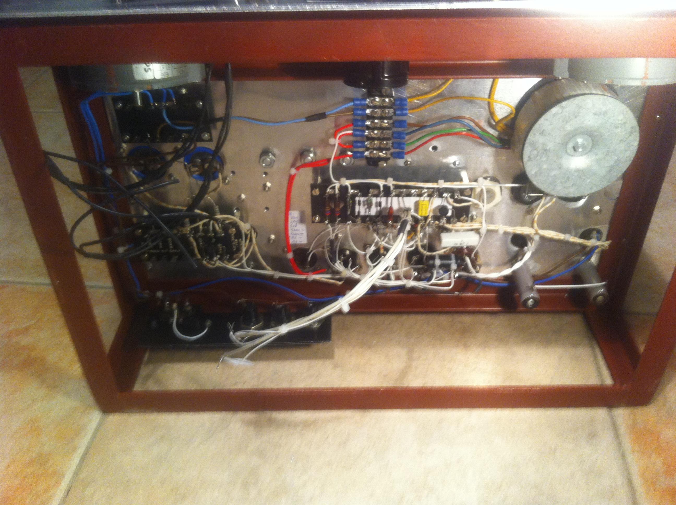

The tester is nearing completion, and needs another 20 hours or so to get it done.
I've opted for a variac adjustable high voltage and filament supply.
So far, all the supplies are in working order, the unit features two valve regulated supplies capable of 90-320V one capable of 45mA the other 90mA (1 vs two 6v6 pass tubes)
and a variac adjustable supply of 0-500V 300mA CRC filtered.
Most of the knobs on the front are for range switching on the analog meters, and adjusting the supplies. There is a knob that acts as a shorts test, which individually connects every electrode to a high voltage potential through a neon bulb which will light up if the electrode is somehow shorted to the other elements.

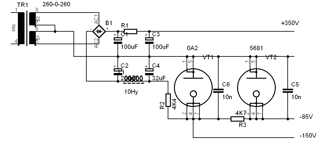

The grid supply is a solid state shunt regulator for 0 to -85V I am unable to find schematics for it right now.
I have not drawn schematics for the major part of the tester because its merely a collection of power supplies, meters and a switch matrix to select the tube electrodes. The high voltage 0-500 volt supply is trivial to design if you want to build one of these boat-anchors.

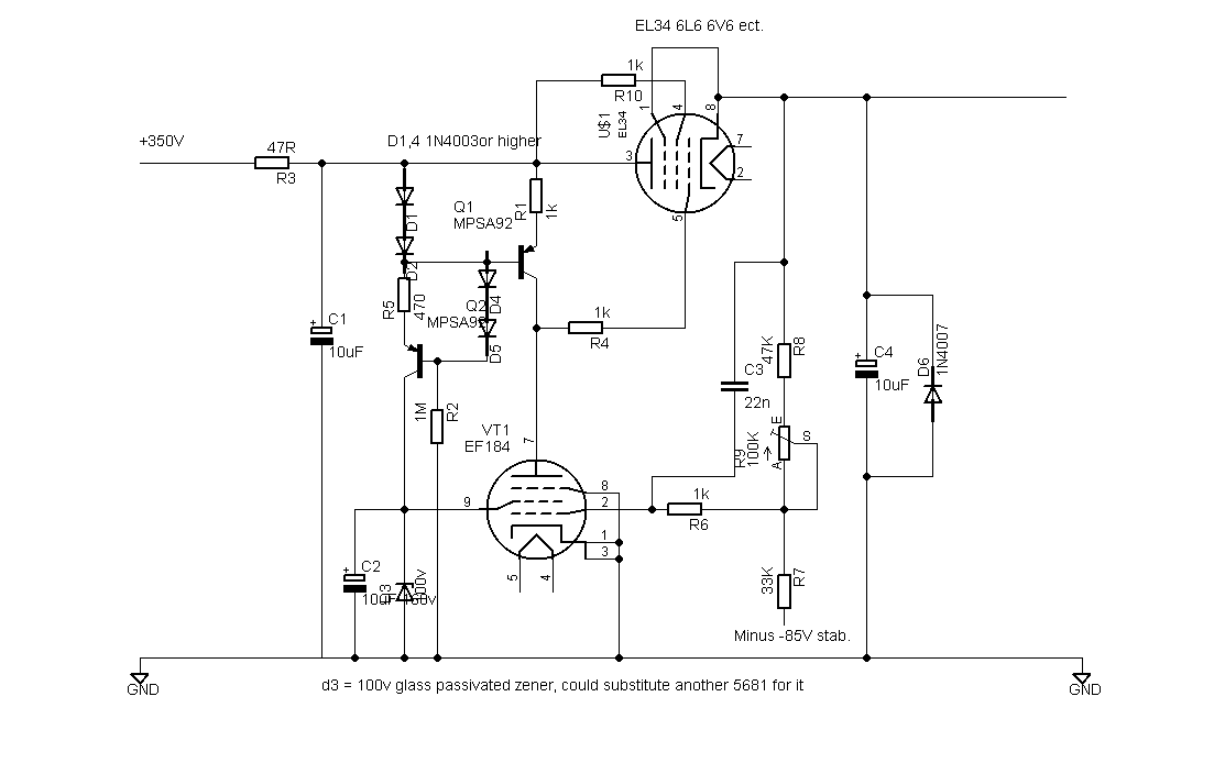

The tube regulated power supply deserves some attention though, it consists of a classical tube regulator, enhanced by two constant current sources that increase the loop gain and line regulation of the regulator section. I have chosen E83F pentodes for the regulator tube mostly because of their stability over lifetime.
The -85V stabilized by a 85A2 (5681) is double stabilized against mains variations by means of the 0A2 tube.
