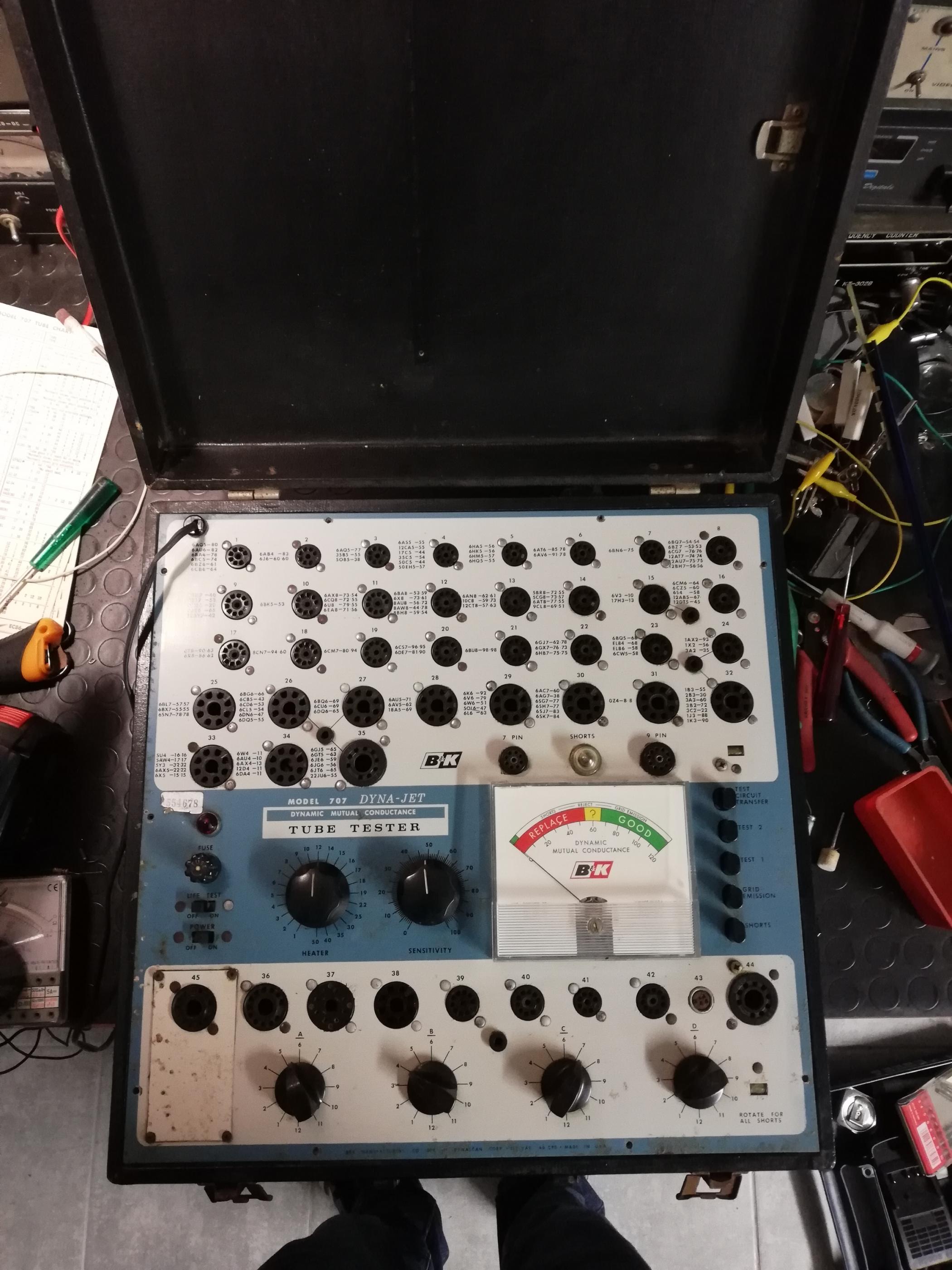

I've a B&K 707 on the bench for servicing, was given to me by an old tv/radio tech.
I've already replaced caps and resistors since they were out of range, calibrated the unit sucessfully, so I think is working fine. I haven't replaced the 83 rectifier with a pair of SS 1n4007 for keeping it all original...

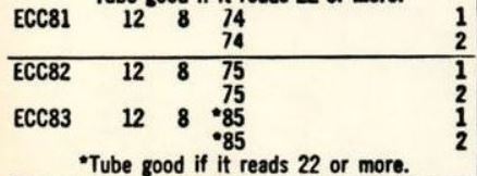

Now, if I test a 12AU7(ECC82) or 12AT7(ECC81) they measure fine on the meter,
If I test a 12AX7(ECC83) (tried some new JJ / EH and also some Nos Siemens) I read around 25 (chart states * good if 22 or more) still a 22 on 120 scale seems odd .
So, I want to ask you guys, is a B&K an accurate tester? It's worth keeping ?
I don't understand how can you measure a 12AU7 and a 12AT7 (different beasts)by just turn the shunt by 1 cent ? 75 vs 74
Also, how can you measure a 12AX7 on it?

First of all I must admit I like B&K test equipment I have a B&K 467 CRT tube tester /analyzer , their equipment in quality is a step up from standard builds of the day and that includes Hickock,s .
If I was American and lived in America I would buy that n model or one like it from the B&K range , don't put it down my CRT tube tester still works okay and if push came to shove it can be converted to a tube tester .

Please scroll down to the "Red " section commenting on Jet-Check mu sockets they are meant for a quick test --okay there are more technically superior tube testers with more control but I have seen the problems some of them have when repairing them ,It took me months to go through my old AVO VCM MK4 to get it "up to scratch " .
Here you can download the instruction manual &the tube chart & schematic in PDF.-

Thank for your reply
I've already visited bama, same documentation as mine, same calibration procedure, the tester is ok.
The "tubesound" page talks about a 12AX7 mod, same as described here :
Antique Radio Forums • View topic - 12AX7 Test Modification For B&K 707
So I may keep this instrument since is in good condition and this instrument is fast for the purpose of testing stash of old tubes which need only a pass / reject test
