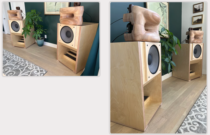

Amplifiers were the Triode Labs 45 tube mono blocks. In this review of that driver/horn combo at 25:01, Troy describes what he heard by adding that 6uf cap.
In the 10 or more recordings played I experienced more neutrality than warmth. ymmv.

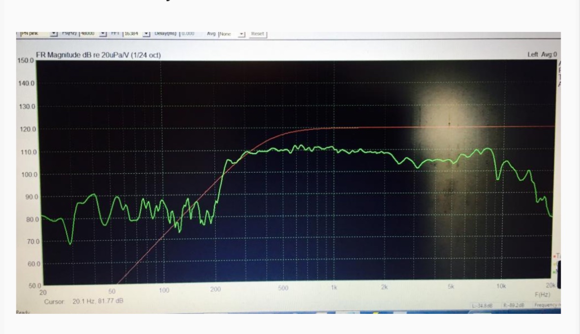

I used it in Autotech tractrix 200 from 400-3000 Hz. Sounds endlessly effortless and warm. Best midrange compressions driver I have heard.
And yet it's only a 2" diaphragm. https://bcspeakers.com/en/products/hf-driver/archive/2/8/DCM50 Or might the masterful sound of its midrange be due to having a 2" rather than a 1.4" throat?I used it in Autotech tractrix 200 from 400-3000 Hz. Sounds endlessly effortless and warm. Best midrange compressions driver I have heard.

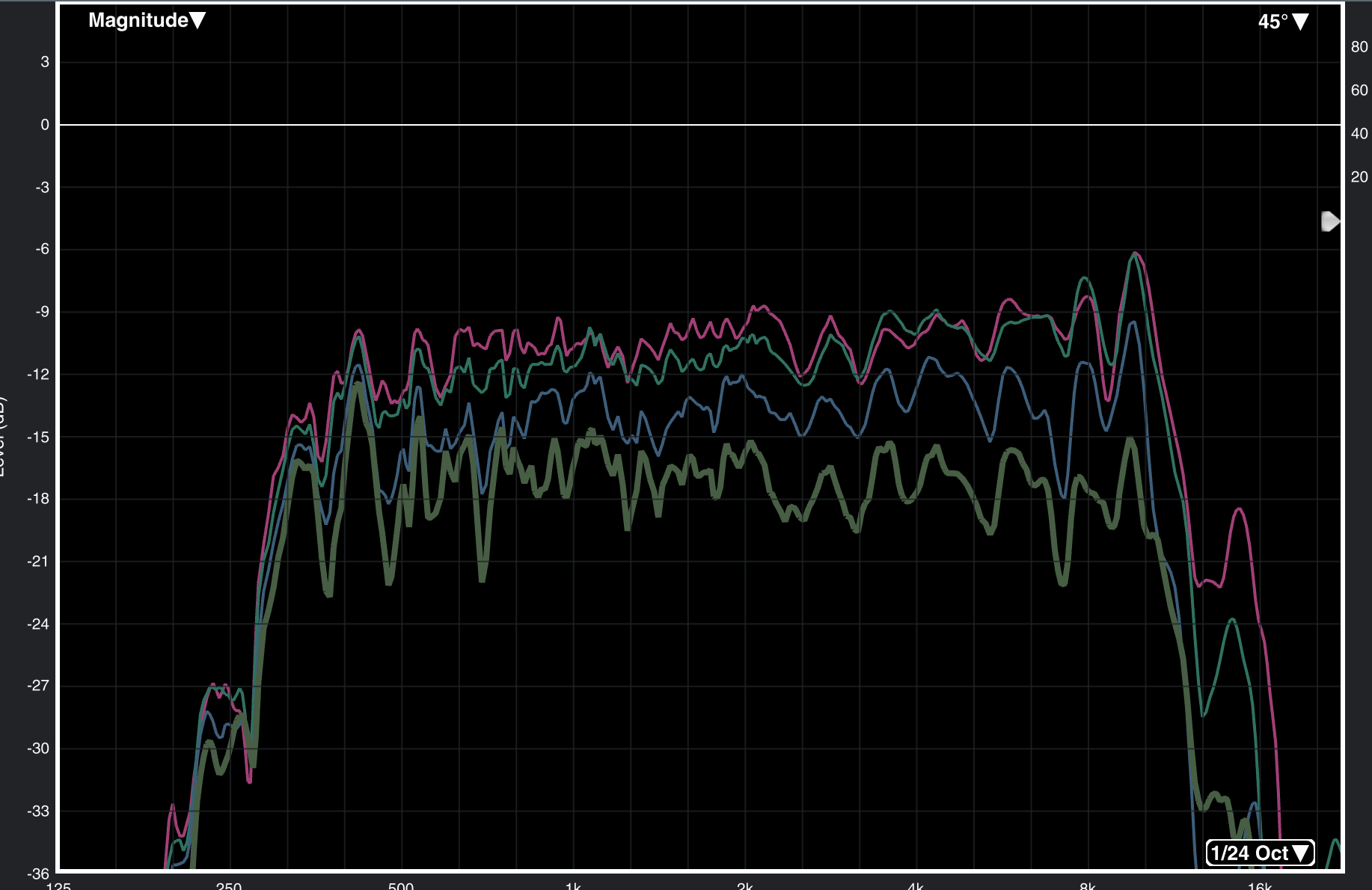

Indeed, note in the conclusion of this review where Troy Crowe seems to have discovered the exact converse with the B&C DCX464 https://bcspeakers.com/en/products/coaxial_hf/1.4/8/DCX464
https://josephcrowe.com/blogs/news/b-c-dcx-464-16-with-es-600-biradial-horn
1.4" throat provides wider off-axis coverage in the upper treble than a 2" throat.
But would that statement only apply to the DCX464 because it's a coaxial driver?

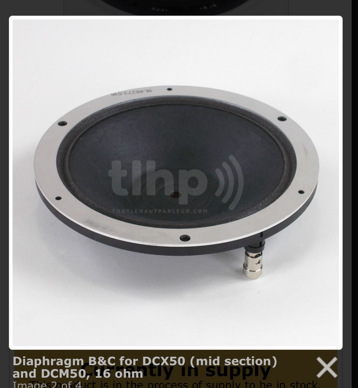

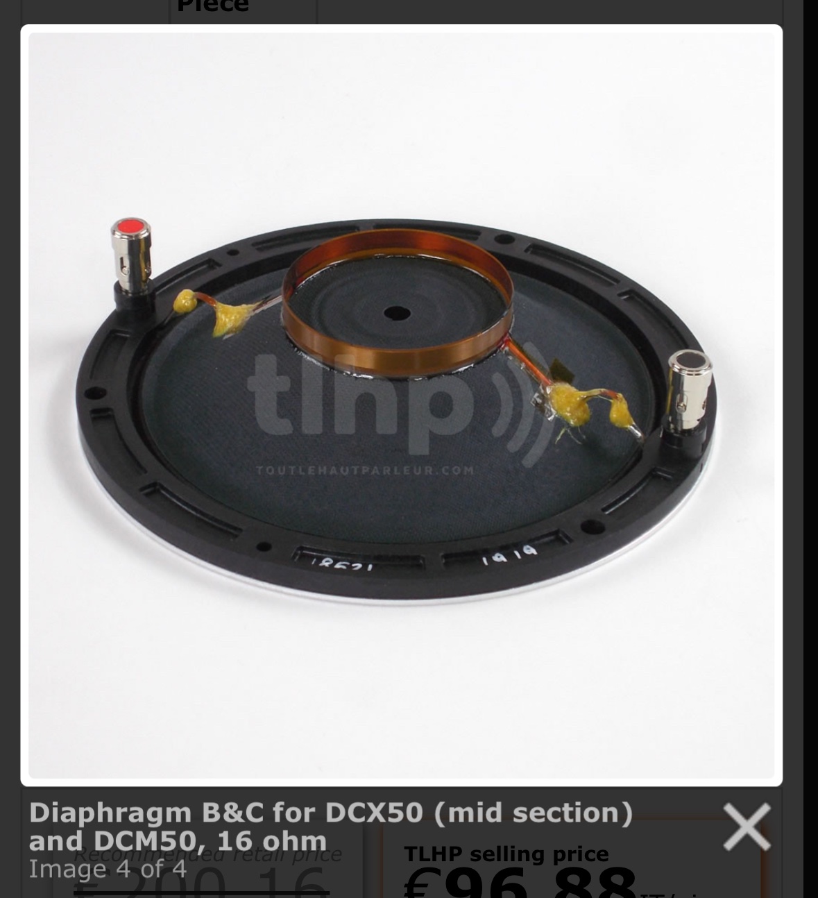

B&C DCM 50 is not a standard compression driver. It is more like a small fullrange driver (paper/composite) with small closed enclosure and a slot in front of the cone.
I presume fs and x-max is something completely else than a 2 inch exit CD.
My experience from Tractrix 200 with JBL 2446 confirms that.

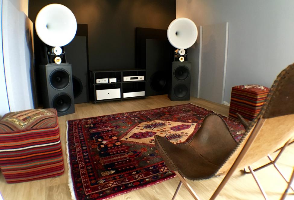

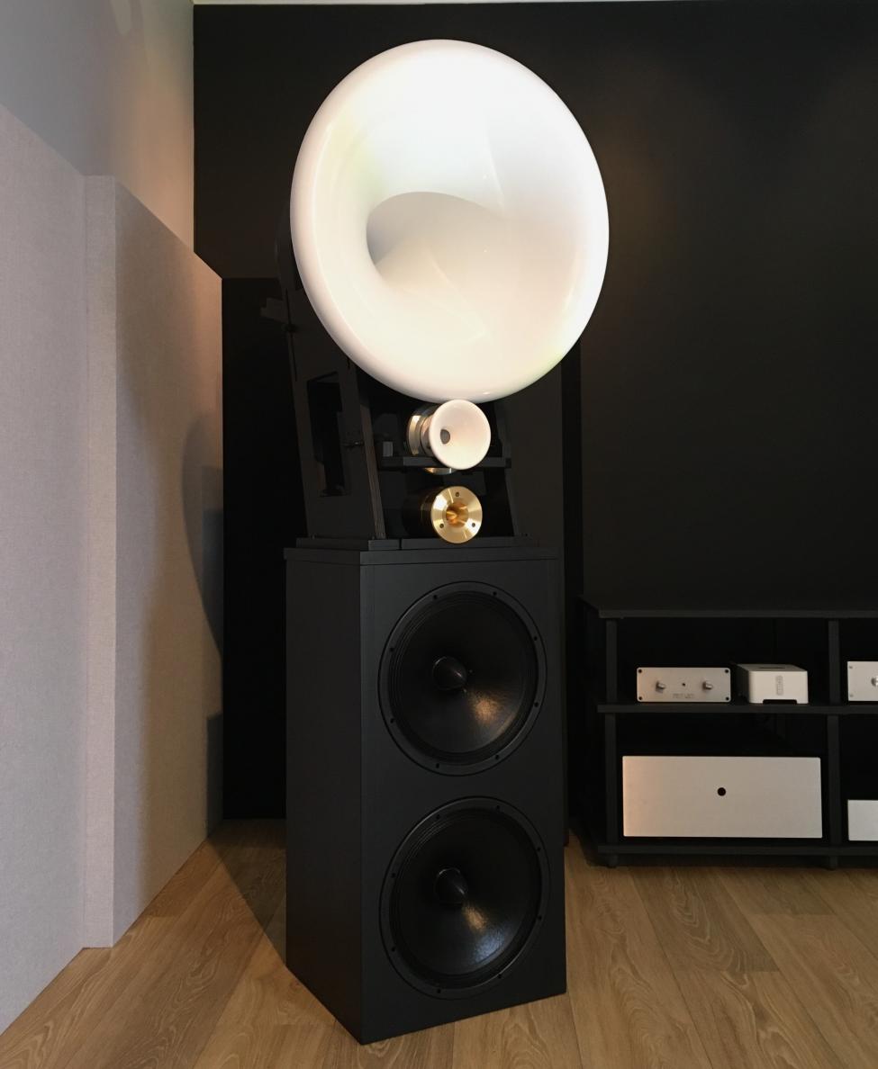

Might that be the First Watt B4 active analog crossover on that shelf? If so, was that online for use with those speakers? What hardware and software needed to fine ballpark and then precise crossover points? Lots of trial and error?I used it in Autotech tractrix 200 from 400-3000 Hz. Sounds endlessly effortless and warm. Best midrange compressions driver I have heard.
Do you still use this or other analog crossovers for this or the newer speakers with the JBL 2450Js?
Or which DSP model (s)?
