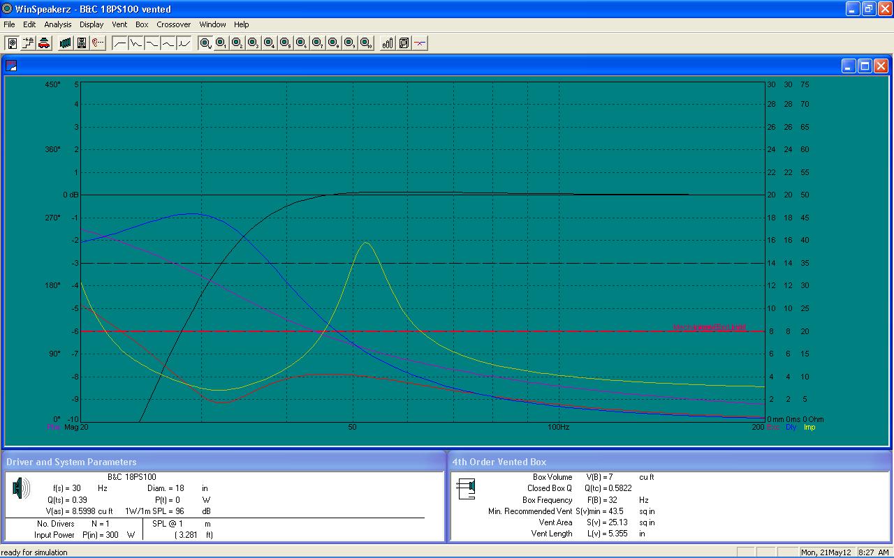

I have the 18PS100 in a 7 cu ft vented box. I really like it, but have not listened to the other drivers so can't compare. It is driven by an O Audio 300 watt plate amp. It will put out enough SPL that it feels like my head is being squished. It will shake the floor also. It's good for a musical subwoofer, but home theater folks may want it to deeper. Two of these would fill a really large room with deep bass.

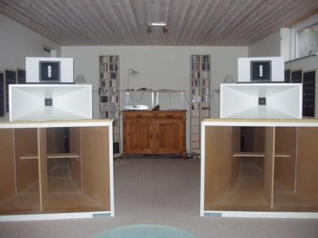

I completely agree with your preferences. Actually, until recently I had the bass horns displayed below - each mounted with double 15" pro woofers. However, I am now forced to downsize the setup due a move🙁
Your sub look cool!

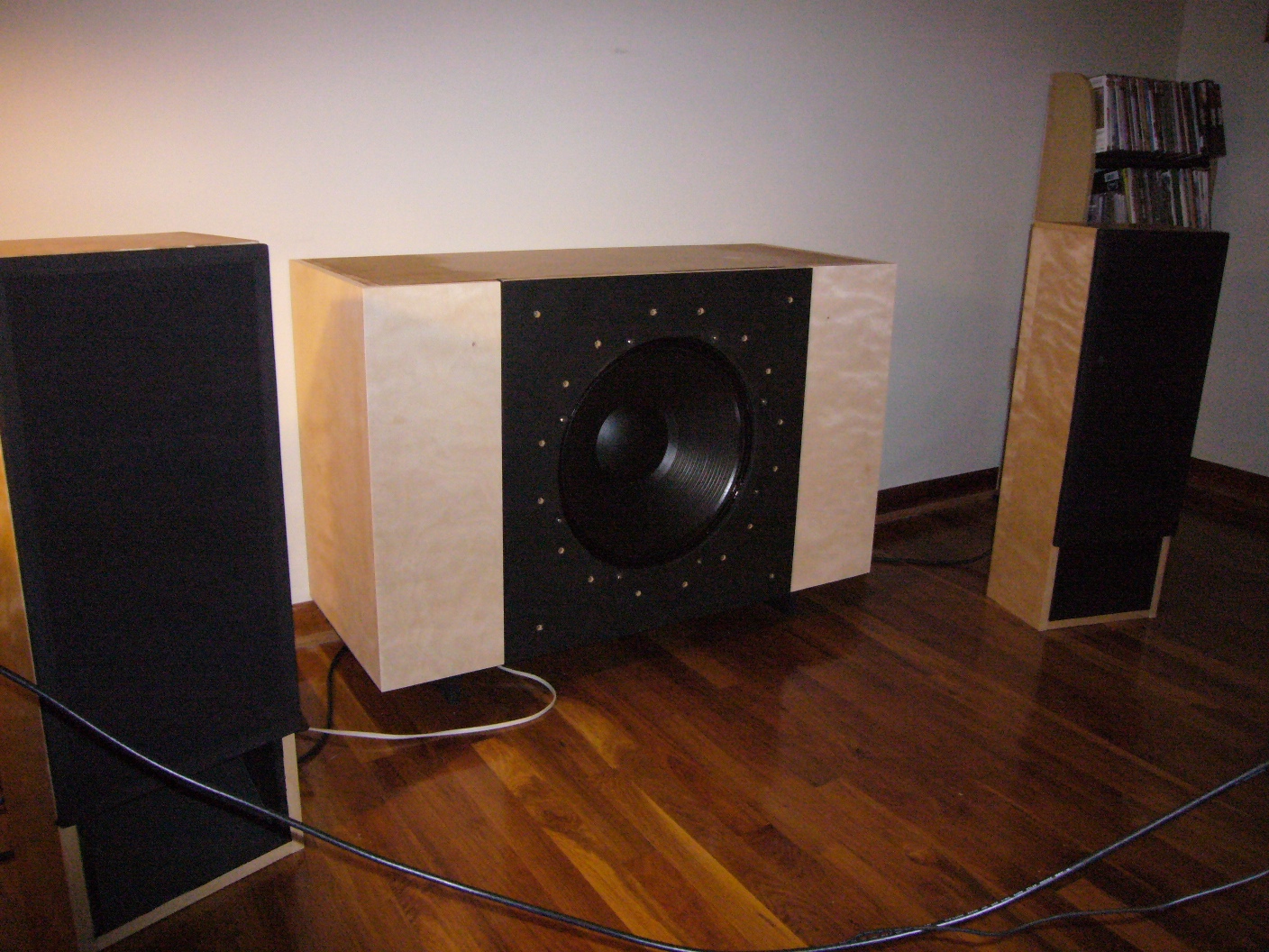

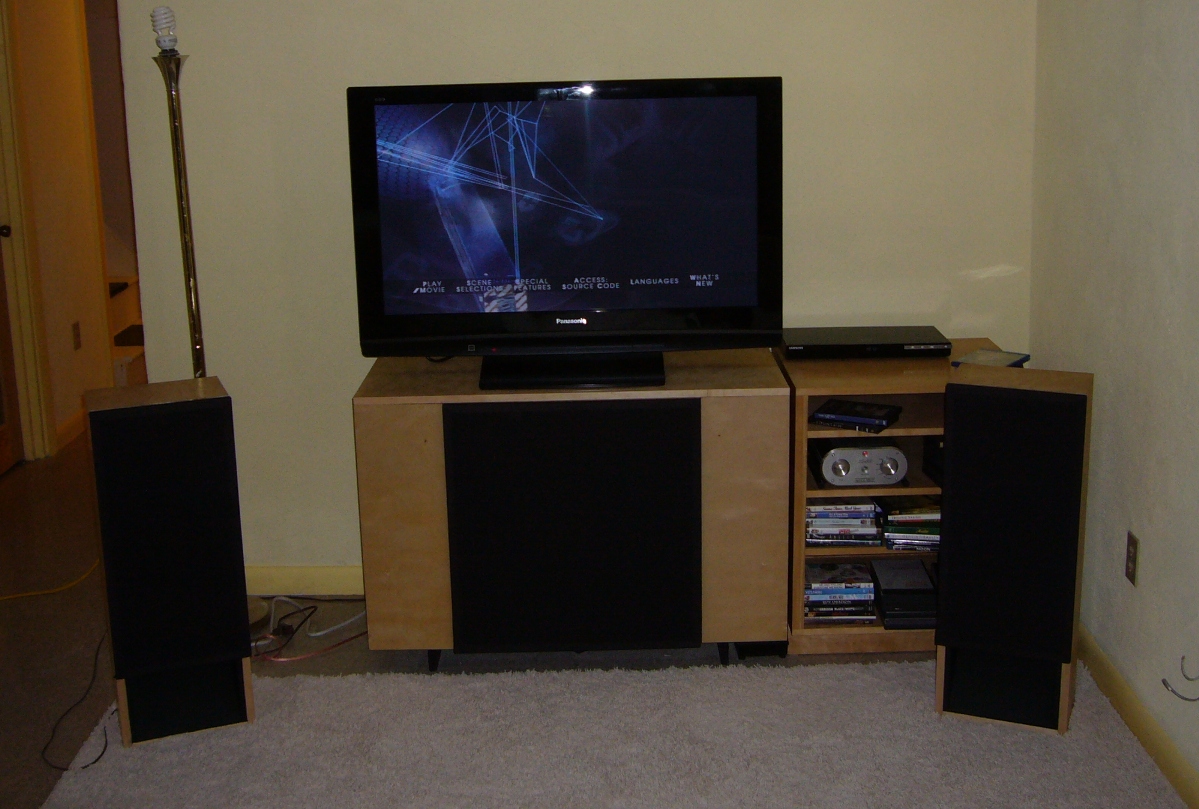

Thanks. Yeah, horn subs are just insanely huge. I had to assure my wife that this 18" subwoofer wasn't going to be so huge that it would be a problem and that it could double as a table or TV stand. I also made sure it was pretty. It's made from 3/4" mdf with another 3/4" birch ply laminated over it. So, I built a box out of 3/4" mdf first, and then covered most of the sides with a layer of 3/4" birch. The vents open at the bottom.

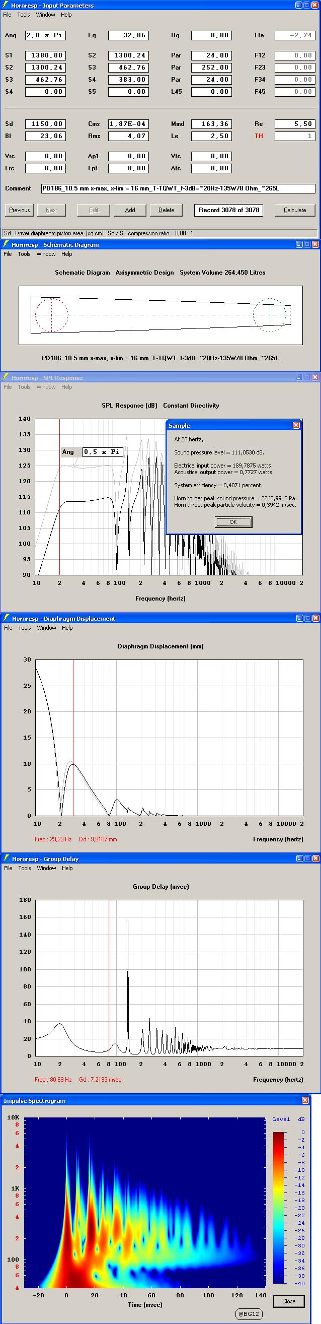

hey bjorn, what is it ? a tapped horn ?
PD.186 might not be ideal to cross very high, but I would sure like to cross a bit higher than 80hz
