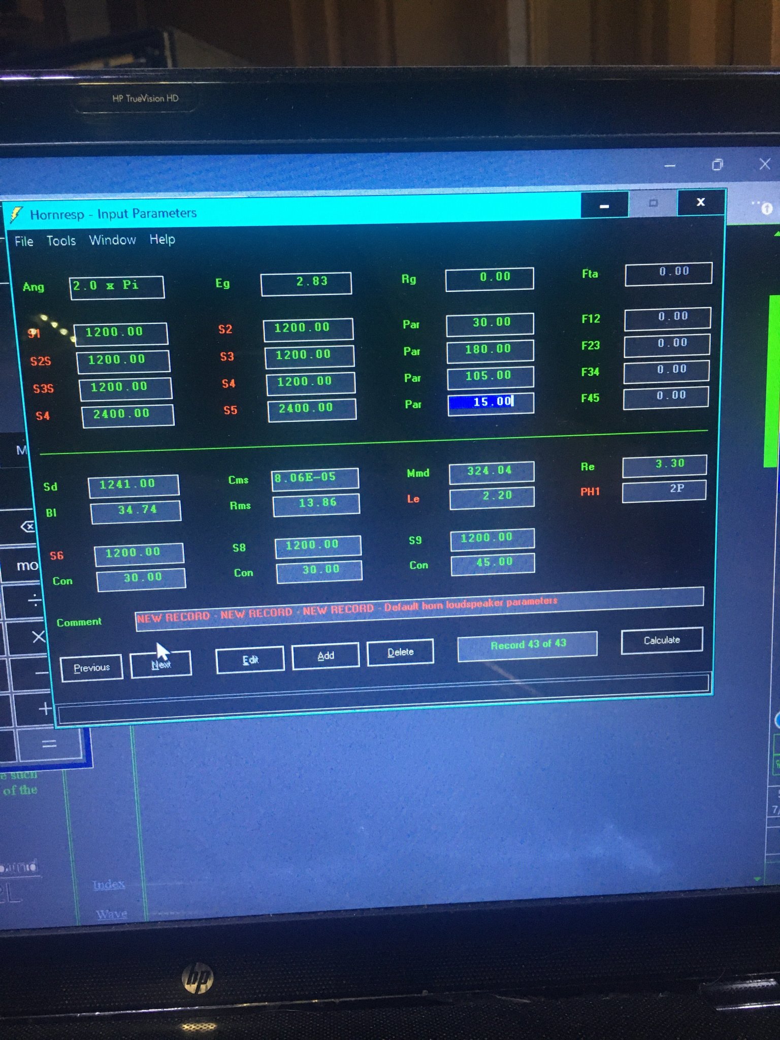

Any good ideas? No restrictions on size, no requirements, anything you got ill consider? Appreciated in advance.

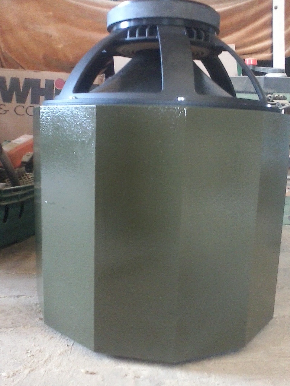

Response looks very similar to my B&C 18PZB100 in 55l, as it would! Driver externally mounted to reduce power compression, and I only use a low frequency HPF if the system is being used for vinyl. It will sound very, very good indeed, and is dead simple and cheap to build. Super inefficient, but what price perfection? 😉Sealed in 2ft3? With an EQ and a BW filter at 30hz?

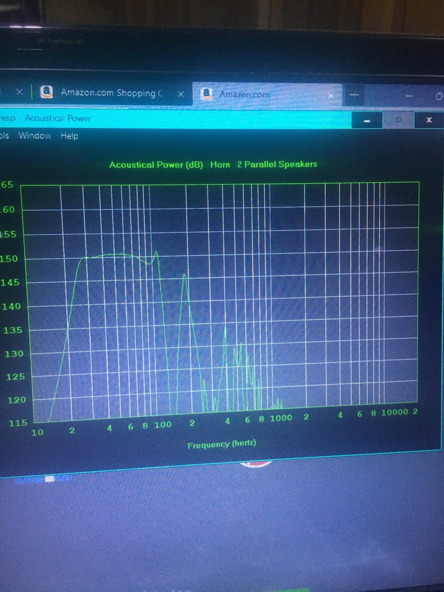

With those specs i would say a folded horn is the best suited. But a sealed wit a lot of eq can also work on relative lower power (xmax is the limiting factor here).
Reflex won't work well, just like TL type won't. Bandpass i don't know, i'm not very knowledgable of this type of alignments, i don't like those so no interest in learning them.

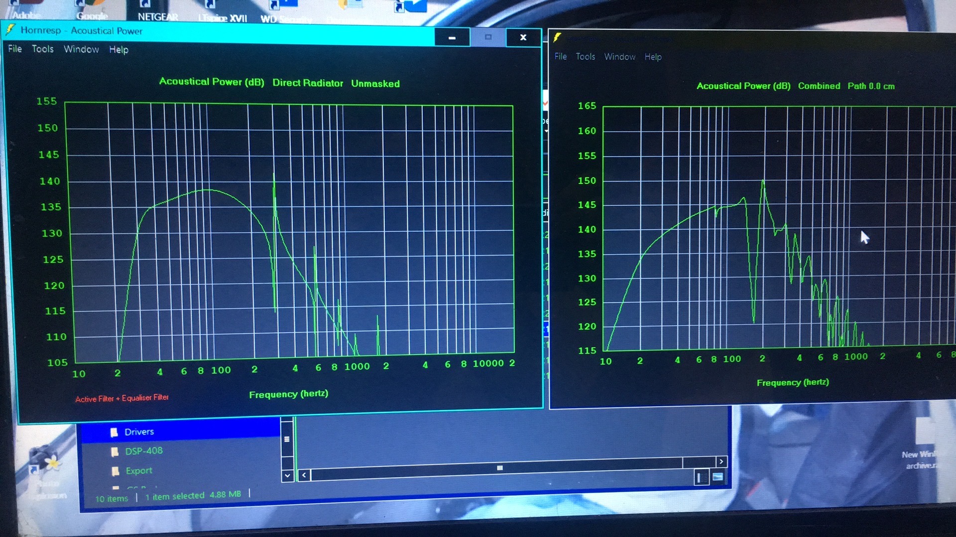

Try this? I play with miniature versions initially(4” drivers) because of apprehensions in the higher order stuffWith those specs i would say a folded horn is the best suited. But a sealed wit a lot of eq can also work on relative lower power (xmax is the limiting factor here).
The cone control is rediculous. Its never going to be mechanical fail, gonna have to be thermal at high outputs and neglect of that it seems.Try this? I play with miniature versions initially(4” drivers) because of apprehensions in the higher order stuff
so distortion per output is super low and group delay is 26-30m/sec at ~Fb spike alone. these enclosures seem to have a window of opportunity and then a whole bunch of other methods to built them that tend to suck if not appropriately designed.
