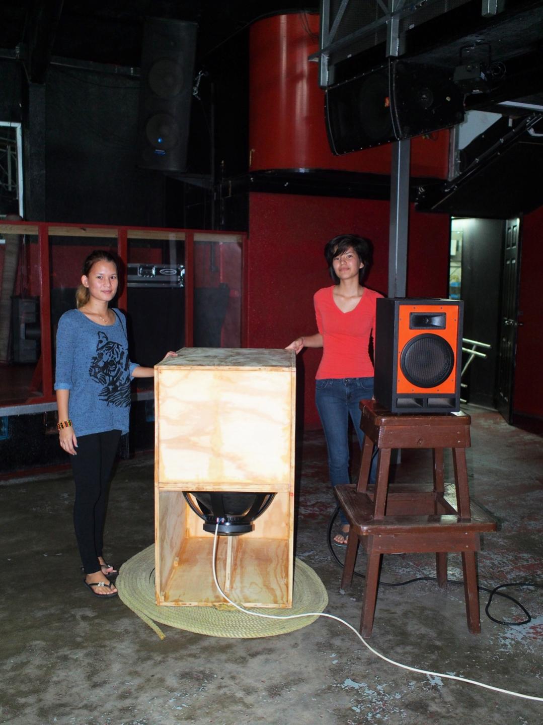

FWIW, my POC4 TH was designed around an 18TBX100, because that's what this particular client was using in his other bass horns. More information about it here: - The Subwoofer DIY Page v1.1 - Projects : "Proof of Concept #3"
The box for this TH is quite large, but this is aimed at a semi-permanent install in a club, so...
During high SPL testing, the box was giving up before the driver (it was starting to walk, hence the temporary "rope" base in the image at the link above). The final version of the box will be modified to take this into consideration (oh, and the builder did take a few "short cuts" with this build too, LOL).
Listening to Oliver Heldens' "Pikachu" with its 32Hz tones on this TH at high SPL (tested as seen in the image) was a visceral experience, and the plan is to build three more to meet the club's needs for both output and reliability. I recommended that the first party they have with all four THs firing be called "Structural Adjustment"...
Powerplant for testing was one leg of a Behringer iNuke 6000DSP.
A quick'n'dirty FR test suggests a response that's almost dead-flat between 40 Hz and 100 Hz and it's not too badly behaved above that either, all the way to 200 Hz.

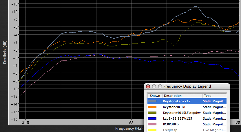

Note that theoretically the TBW100 can produce more output, and with a smaller box size. You'll have to provide quite a bit more power to achieve it however.

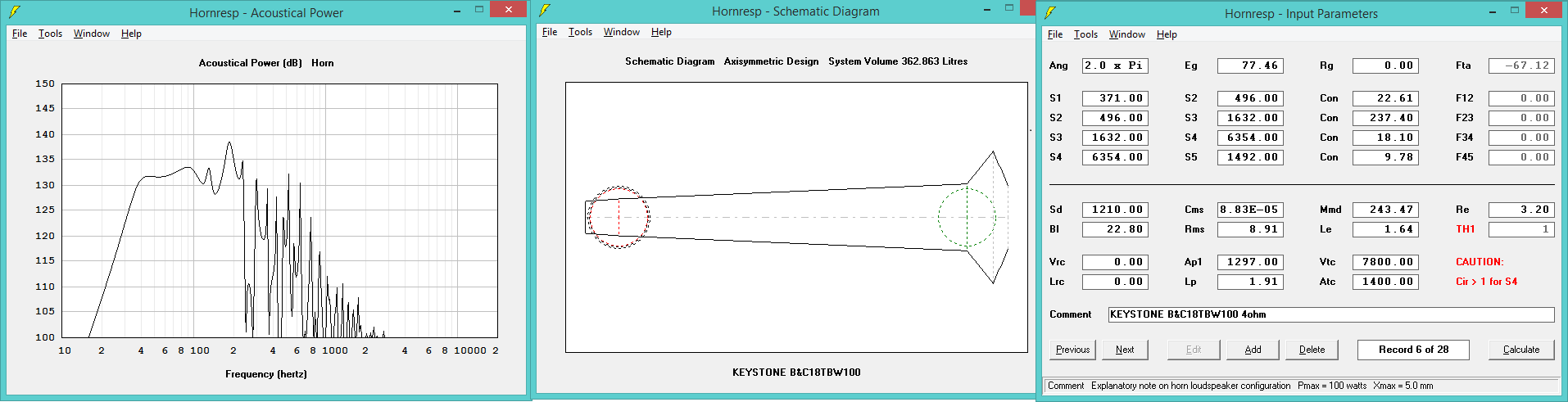

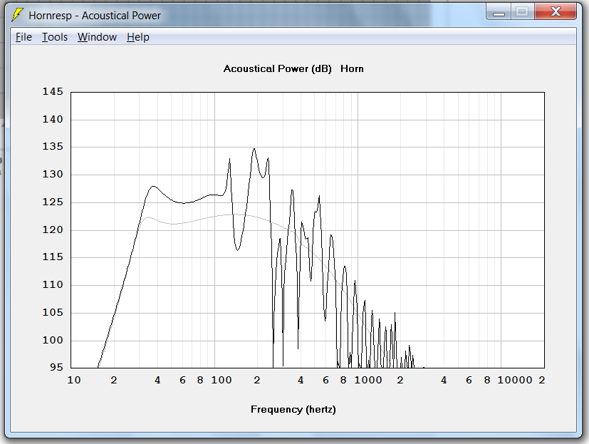

Here is a sim shootout of the 18TBW100 vented per B&C spec in grey vs Keystone in black. The beauty of the KS (besides rigorous testing and development) is that the build is far easier than most TH designs and about the same work as BR.
