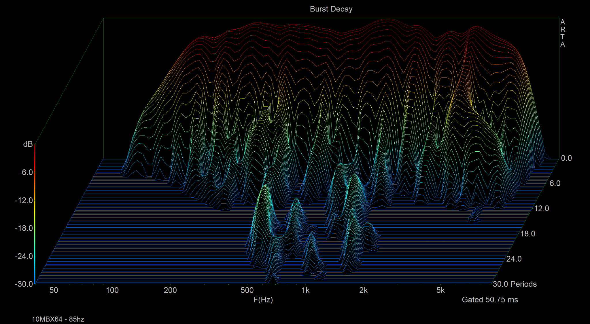

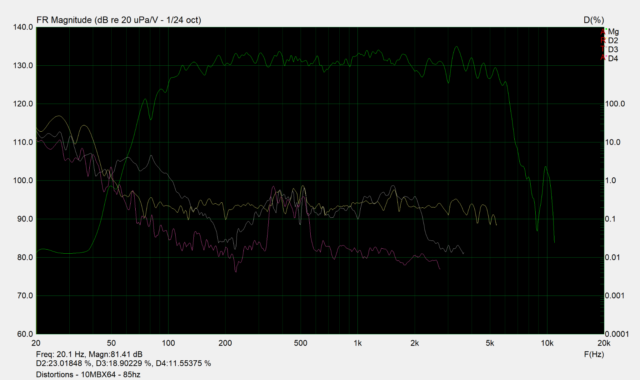

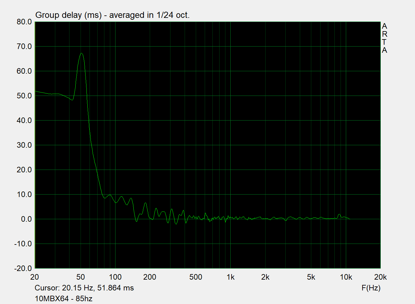

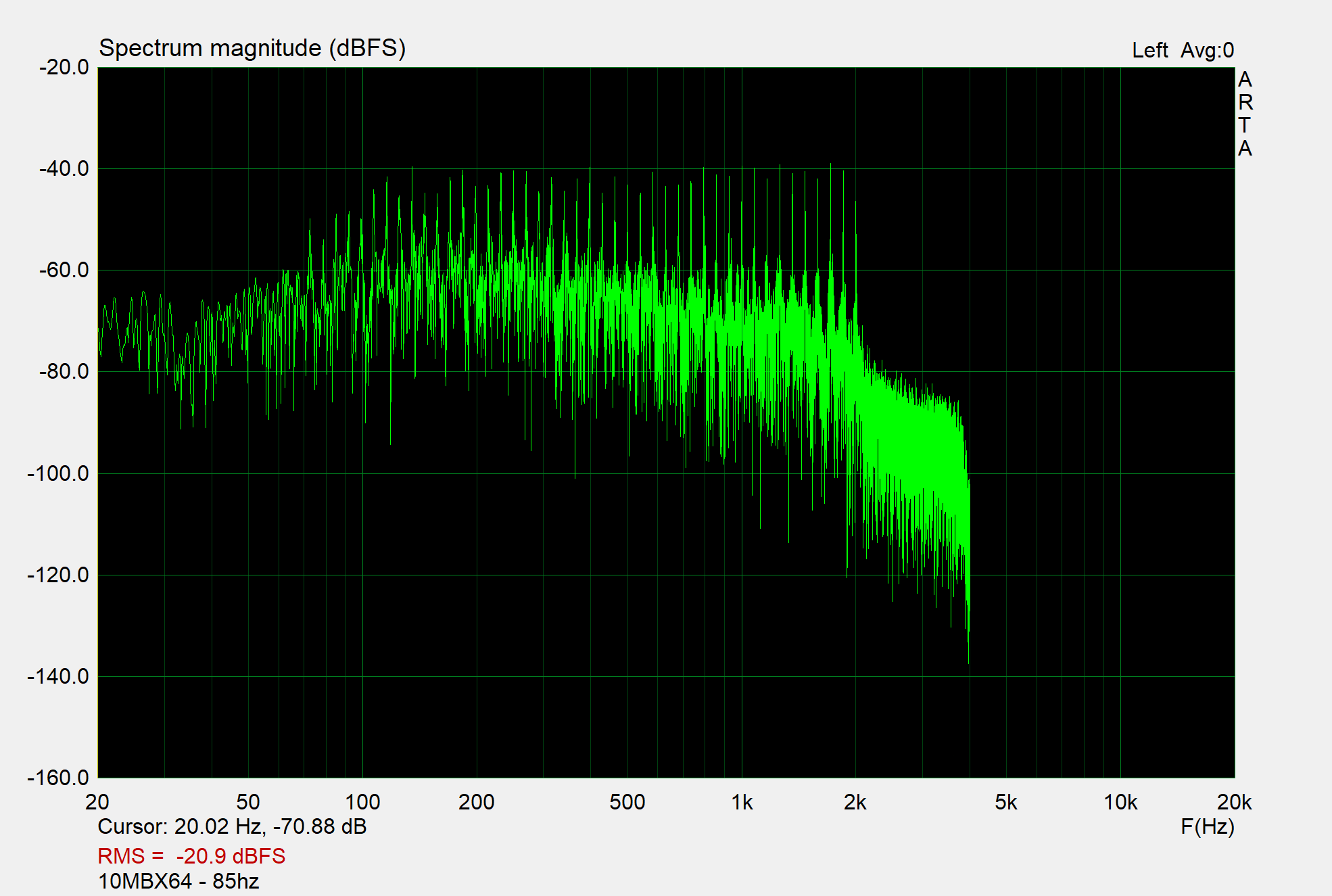

B&C 10MBX64 10" Driver
Did some test measurements of the the B&C 10MBX64 8 ohm version in a 85hz tuned box.
