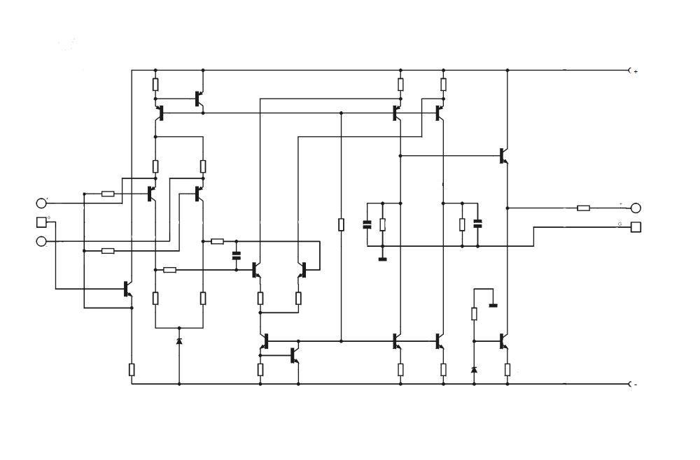

Been down that path Bernhard, big dynamics and drive sacrifice not to mention added noise.
The only way I found to get the rear end singing with a good current output dac chip, is a proper discrete Trans Impedance amp for the I/V stage and a good discrete class A bipolar output amp, with no caps anywhere between the dac chips output and the rca outputs.
If one cannot build it yourself, the an expensive but perfect ready built one is the LC ZAPII, it has the discrete I/V and output, and a shunt regulated supply.
Cheers George

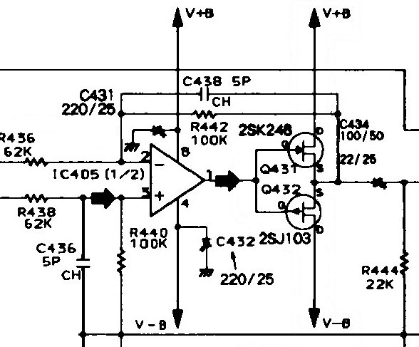

I have reasently had the good fortune to try the AD8599 (possibly AD897 (single) related), which I obtained from the manufacturer in 2pc. samples. Now there's a thing! There is another thread regarding just that item and started by humble yours. BUT it only comes in SOIC, so you would need a 'brown bear' or similar adaptor to get it to fit a standart DIP outline. Again this is a pure bipolar device with relatively low input impedance like 1458, 4558, 4559, LM833N, LM4562, NE5532A/P, NJR2068, NJR2114 etc.
AD827, OPA2134, OPA2604, TL072 are all FET input with very high input impedance, which in turn means their current demand on the previous and FB curcuit is very modest at audio frequencys. HF if another story, since it takes some current to charge a capacitor, but the input capacitor values on these IC are very, very low. The deviced curcuit is interesting, but I'm not sure it would be the anwser in this case. Normally would would have the FETs on the other side of the IC, in order to boost the imput impedance, not as current 'dumpers' on the output, where bipolar transistors is normaly used, due to their far lower internal impedance. Thge distortion distribution for Bipolar vs. FET 'current dumpers' is however very different, so their might be an argument here.
