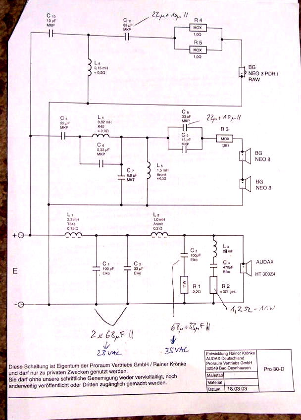

B & G Dipole
I have the xo schematics for this dipole design, and some text, that unfortunately is in German and a scan so not Google translatable. I am very interested in this design, but lack the time to build a pair. The woofers are discontinued but I would guess a similar spec could be found. I can send scans if you are interested. Its a bit complex but may be of help.

Dipole x-over
I would love to see a copy of the x-over for that design, as I have been interested in that design for some time. Could you post it here or email it to me. Thanks.
dtaylo3
The jpg is too big to post, and compacting it renders it illegible. So I will email you both the schematic and the text.

Have been experimenting with the Neo 8's in a car stereo setup.(ok,back off you purists!) Have tried crossing them over at 700 and I am getting some distortion at high levels.Also,after looking closer at the specs,they start rolling off around 1k.I will be raising my crossovers up to 1k and will let you kno what happens.
I would also be interested in the crossover schematic.(Will be building a home setup soon.)

I'm using 2nd order LR crossovers.Could be I need to go to 4th order? I,m putting 60 watts a piece to the BG's and the 5 1/4" mids.Could also be too much power to the BG's!

amt, I would really appreciate it if you would email the crossover document to me as well. I have a pair of GR research Alpha LS speakers that I built over a year ago. They use 8 Neo 8's per side. They sound fantastic but are a little rolled off at the extreme high end. I would like to try putting a single Neo3 in the middle of the Neo8 array . My email is nancybert@shaw.ca
you are kidding right?how does one get to the "htguide.com forum?"
Just in case anyone cares, the plans have changed, the classic woofers have been replaced with two rs225 woofers, which will go into a transmission line, and the neo8 will be dipole with a neo3 to top it off and negate the need for a sensitivity robbing notch filter. Not sure if the neo3 will be dipole yet or not, might experiment, might ask the people at the B&G forums.
To be honest, I was not happy with what I saw when I opened the neo's up. Having done some sheetmetal work in the military I know how simple this kind of structure is and someone is making a killing off of these, $62!!! They are so simple that im not worried about quality, or tolerances or anything but dang, cheap rivets visible from the front, conducters/kaladex in the screw holes ( not connected to the signal path im sure), these are definately mass produced cheaply. Im definately going to be building my own planars now. I was wondering why the FR was so ragged, hmmm maybe someone spent more on marketing than R&D.
Anyways Ill let you know how they turn out😎
