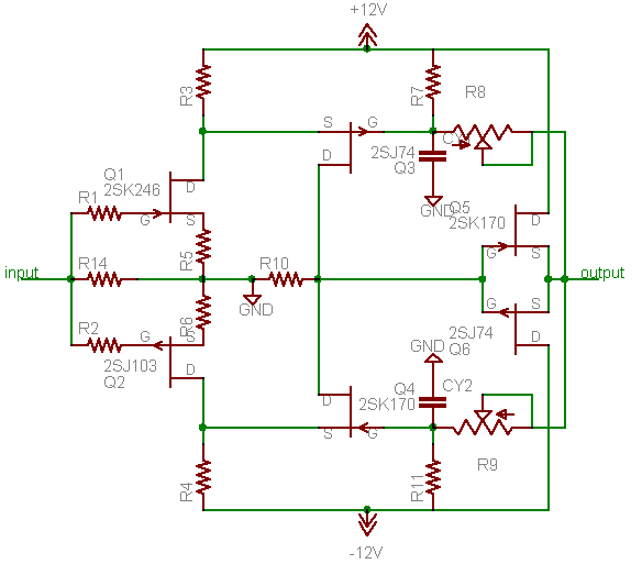

Hi guys,
this is the schematic, i don't need balanced input. Does it can work? Thank you! Maxpou
In principle, you can use the amp's topology to create a preamp, but I don't see that you're following the V3 topology--at least as I remember it. If I have time, I'll dredge up the schematic and see if I'm right.
You're putting a signal in the Source of Q3 & Q4 and taking it off the Gate? There are several oddities about your schematic.
