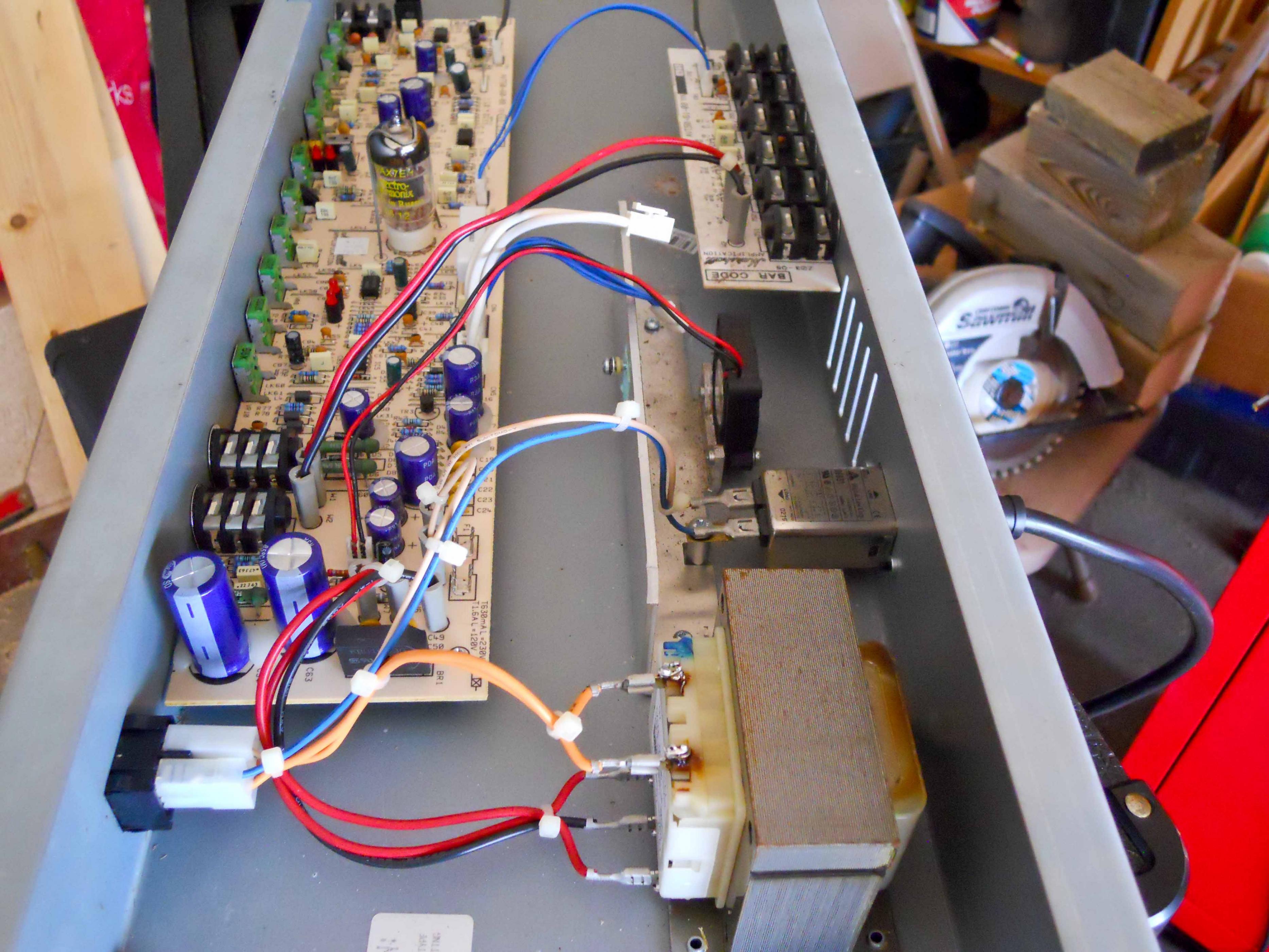

I have a Marshall AVT50 that keeps blowing fuses. I unplugged the leads to the TDA7293 board, and the fuse does not blow, but I removed that board and inspected it very carefully, and I can't find any sign of abuse, heat, or other distress. It looks new.
Should I replace the TDA7293 chip anyway, or can I test it first? Do they sell some that don't have the mute function, or will I be ok as long as the chip is a TDA7293?
Is there a cheap place to get these fuses?
Thanks.

Check the chip with an ohm meter.
Or any diodes or bridge rectifiers if there is any on the board.
Most likely it is shorted otherwise it wouldn't be blowing any fuses !!
Replace it with the required chip ,I.E. TDA7293

So, is there a key somewhere that tells me which leads to check impedance across? Also, would I have to remove the chip from the board to get an accurate impedance reading?
The power supply pins to ground and the output pin as well.
if any of these combinations show a dead short then the chip is bad.

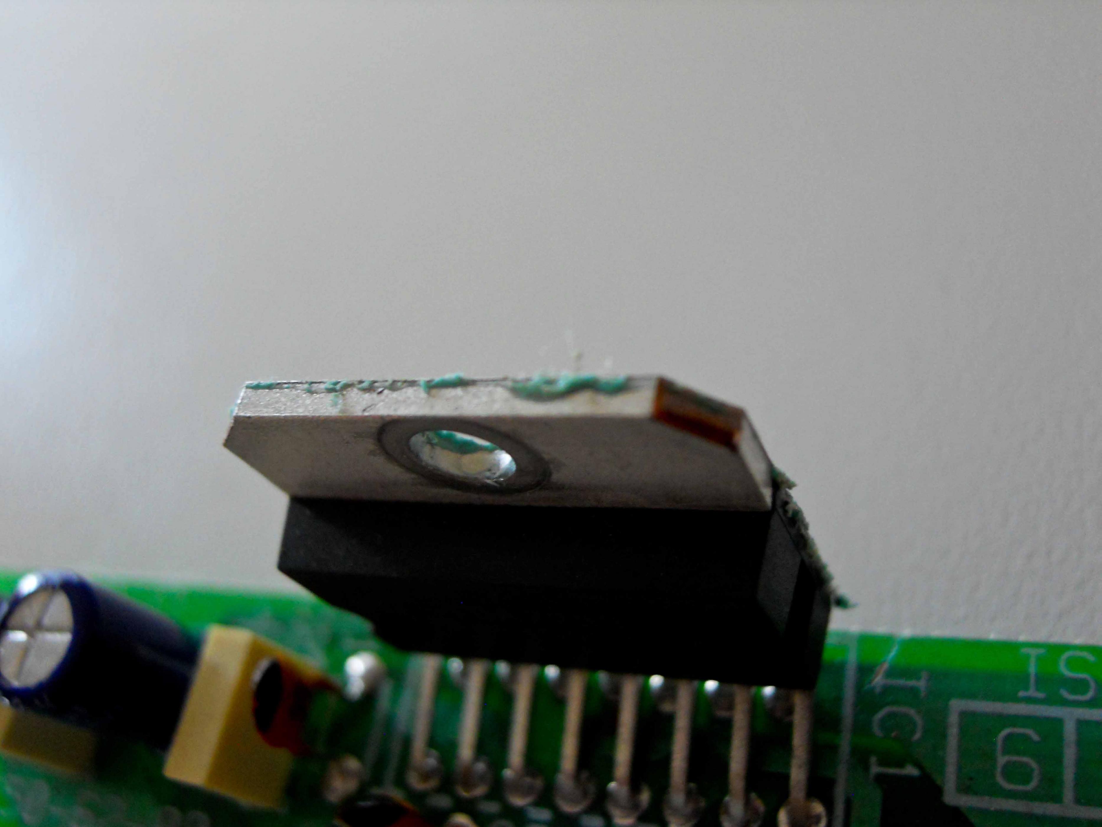

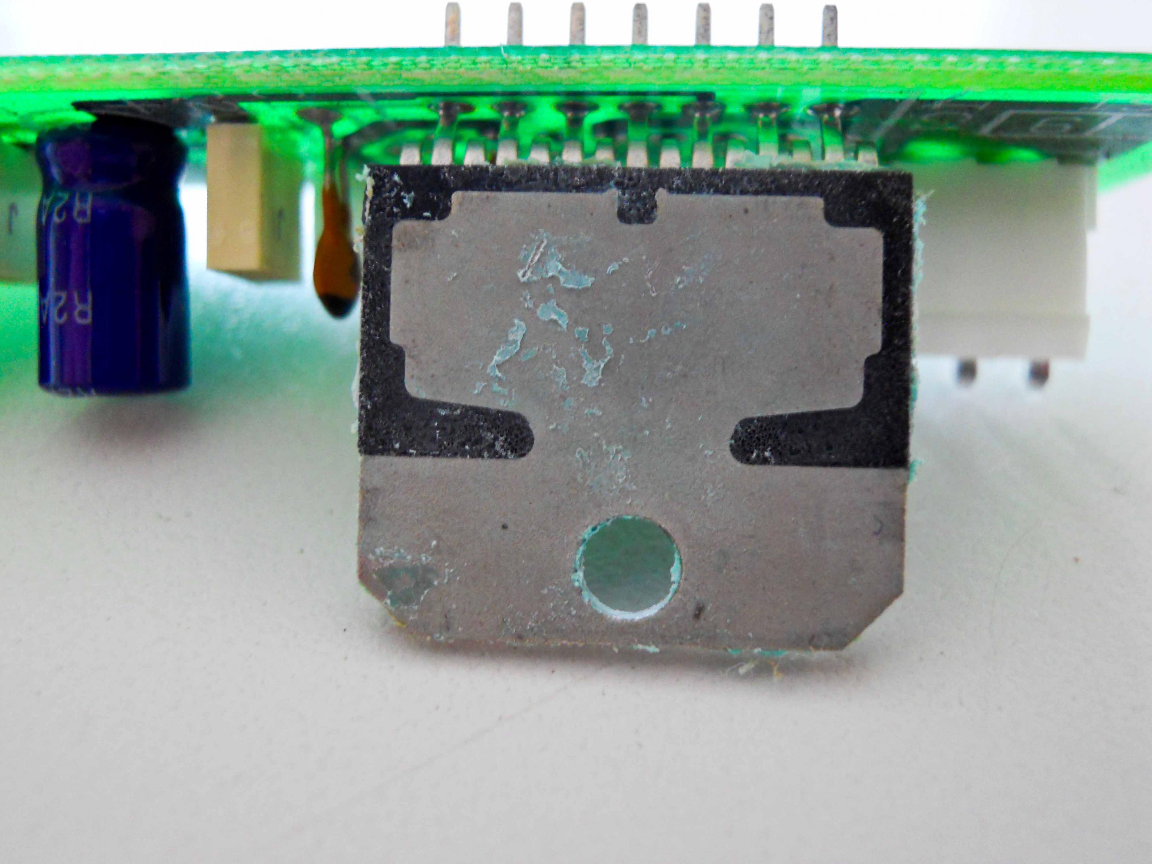

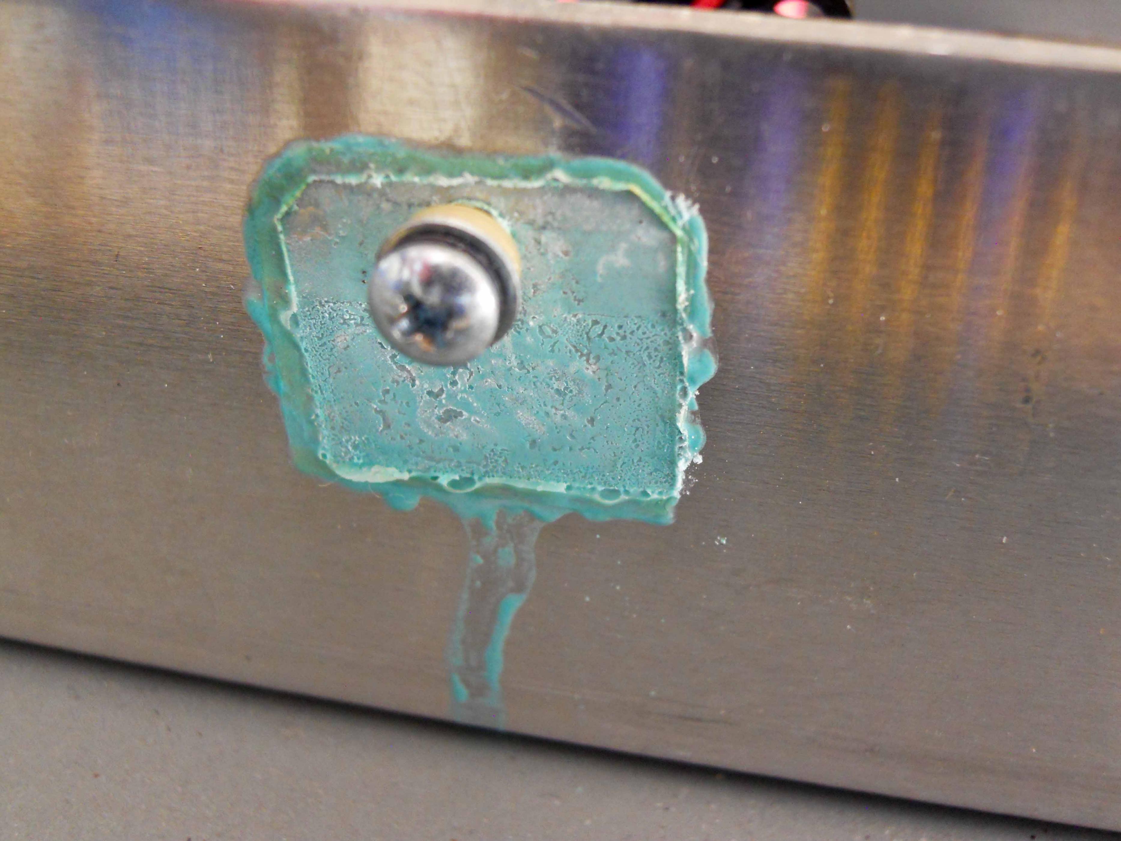

Ok. Here are a couple of shots that show the green stuff that is on the chip. Like I said, its hardened, and when I pulled the little board off of the big aluminum bar (which I assumed was acting as a heat sink), it acted like adhesive.
Also, you can see how the chip looks undamaged. I included a shot of the aluminum mounting plate and the entire inside to show the positioning of the plate.
I don't see the point in mounting it on a giant piece of aluminum if it isn't to dissipate heat, and yet, without a physical connection, it seems the heat sinking would be inadequate.
Anyone recognize this green stuff or know how to get it?
If I use something to keep the electrical connection from being made, I think I will ensure overheating in the future.

That is a **** poor mounting job from the factory.
A proper insulating pad would have much less thermal resistance that that thick glob of goo that they used.
If you wanted to get real technical you could lap the chip on a piece of glass with some #600 grit emery paper as I have done here,
http://www.diyaudio.com/forums/plan...tor-insulation-mylar-coating.html#post2791028
And/or even add a copper heat spreader and use a thin peice of mylar between the heatspeader and the aluminium plate with a very thin layer of heatsink compound on both sides of the plastic film.
Potroast cooking bags are made of mylar and a layer or two would suffice as all it has to electrically insulate the chip from the aluminium heatsink plate.
You could also mount a small finned heatsink on the opposite side were the fan is blowing towards it, that would help tremendously as well.

It must be insulated from the heatsink as the tab is at -Ve.

As for the chip, an insulating washer and heatsink compound is required - possibly the green paste used previously did both?.
I believe I see the outline of a mica wafer in the green goo in the photo, still stuck on the heat sink. I am not aware of any goo-only insulators. I agree it is crucial the metal tab on the IC be insulated from the grounded heatsink. Inspect that heat sink closely and see if there is or is not a thin mica wafer still there. The plastic shoulder washer is still on the screw.
