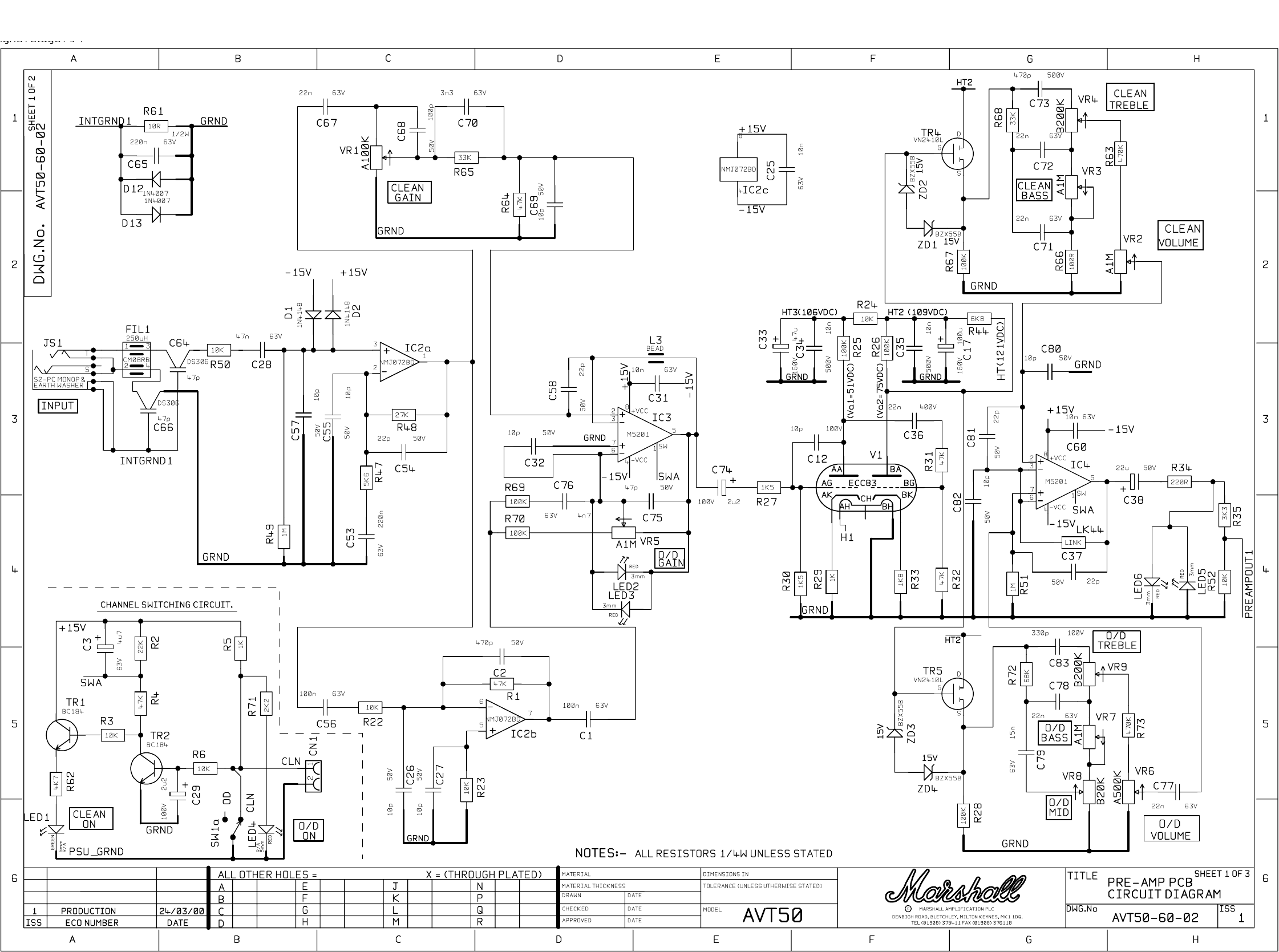

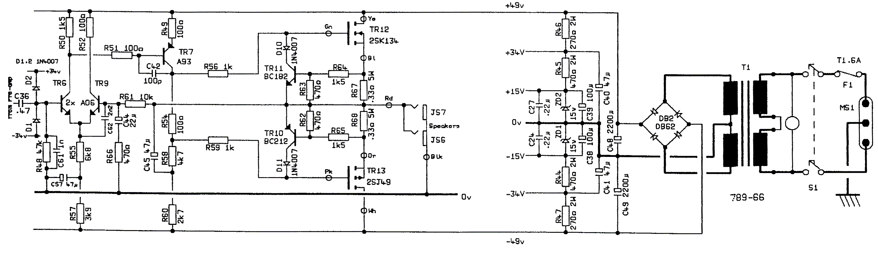

I want to build this to my avt50.

11) the MosFet 100 is a nice amp but you will NOT find real MosFets or pay way too much for them.

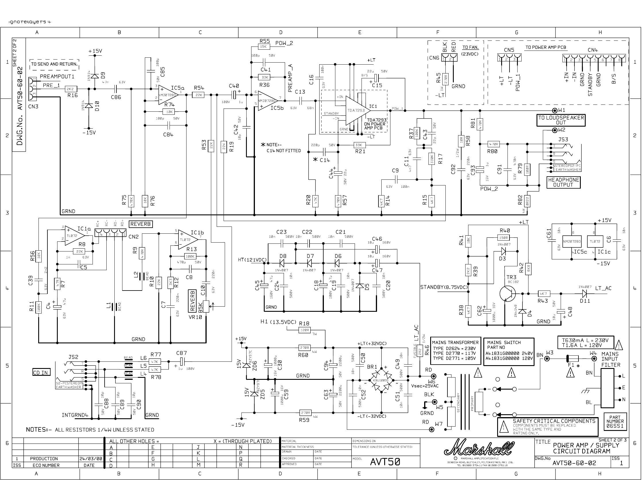

12) actual supply voltage is +/-32V for 50W RMS into a 4 ohm speaker.
+/-15V is the preamp supply.
The problem with bog standard power amps is they sound flat with a guitar.
And the standard AVT power amp actually tries to counteract that by employing current feedback to artificially lower damping factor to magnitudes comparable to tube amps. The older discrete design, on the other hand, is a good example of a generic power amplifier design with very "hi-fi" and "transparent" performance.
Forget that it has MOSFETs, you won't "hear" them there like you didn't hear them being there in the TDA chip -based amp either. In these generic power amp circuits MOSFETs will never portray any of the "warmth" people maybe associate to them. The MOSFET output devices may make the discrete amp a bit more stabile thermally but that's it. Want to experience MOSFET tone? You need to try something like the TubeWorks MOSValve amp with its proprietary circuit design.
And speaking of thermal stability, the real issue of the TDA chip -based Marshall power amps is that they try to squueze too much power out of the chip with quite insufficient heat sinking for the job. If you want to improve and upgrade something in these amps then there's the spot.
