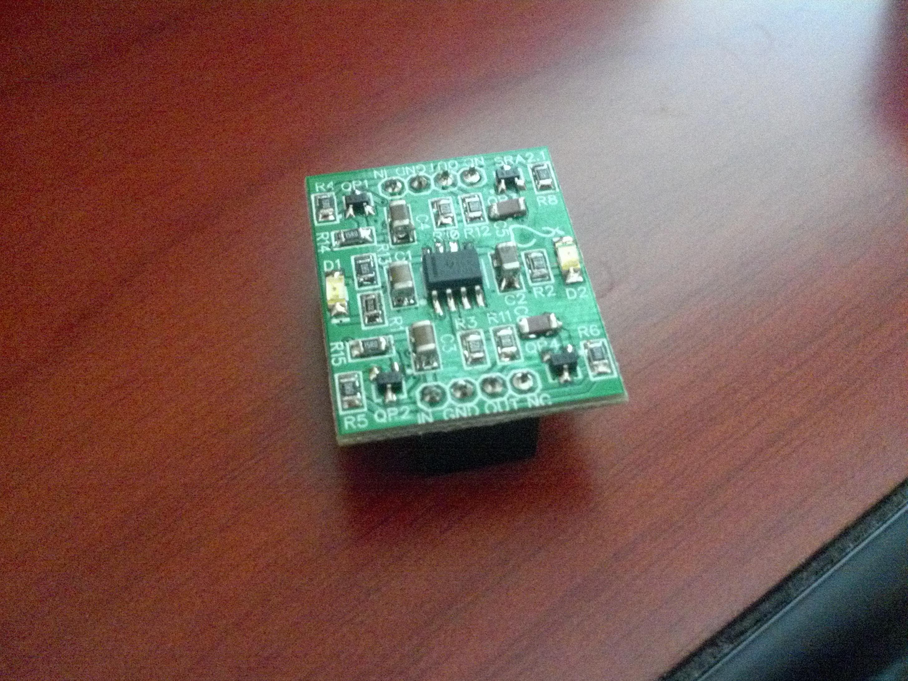

While I was laying out the Buffalo III-SE PCB - I decided it was about time to refresh the AVCC module. So I designed PCB version 2.1 of that module.
A couple of key improvements:
- We started using the same improved error amp we are using for the Trident - it is the dual version.
- There is better local feedback around at the shunt element by adding degeneration. This promotes better stability and RF rejection.
- There is compensation added to the feeback loop to give the circuit a much improved phase margine. It is as a result very stable and rejects EMI better.
The result is a module that does a better job at regulating - and truly does sound better than the previous version. I don't say that lightly.
This updated module can be operated at slightly higher input voltage like the new Tridents can.
This mean that input voltage up to 6V should be just fine.
I also improved some aspects of the layout making better use of top and bottom planes. It is thermally and electically a better solution.
It is a much more robust drop in replacment for B-II and B-III.
It will be available soon. We are getting them made now.
Here is a picture of one Brian built up by hand for testing.
That is a strong statement. Does this improvement also manifest itself in any measurement on the actual audio outputs?
Cheers
Thomas
Cheers
Thomas
I wish I could answer that. I simply don't have access to gear with which I could measure that at the moment. 🙂
I would be very glad to see results from any of our users who does.
One note though is that these changes are exactly the same kind I made to the Trident. Those changes did have positive measurable effects on the regs themselves (wider phase margine and lower noise and output impedance in the critical band), but alas those tests where not done by me, but by a user, and I am not sure he has shared those yet.
For now - I can only offer my subjective opinion. They sound better. 🙂
Cheers!
Russ

Russ,
Very nice product. Should be a nice upgrade as it is the most important regulator in the DAC. is it still specified for 3.3V?
I've seen photos where the leds have different brightness (including mine). Although that is not an issue, is the new design better at having equal brightness?
I'll like to order mine machine soldered (not hand soldered like in the photo 🙂)
Magnitude of LED brightness was not a design priority. But yes, if you operate it at 5.5 to 6V the intensity of both should be pretty close in any case. 🙂
I know your kidding, but it's actually a pretty good job of soldering for a prototype. Brian does excellent work.
It is just a bit more than 3.3V. Right around ~3.5V

Russ,
Would this new AVCC work without any compromise in BIIs and BIIIs fitted with older Tridents?
It would, but I would strongly suggest updating the Tridents too.
