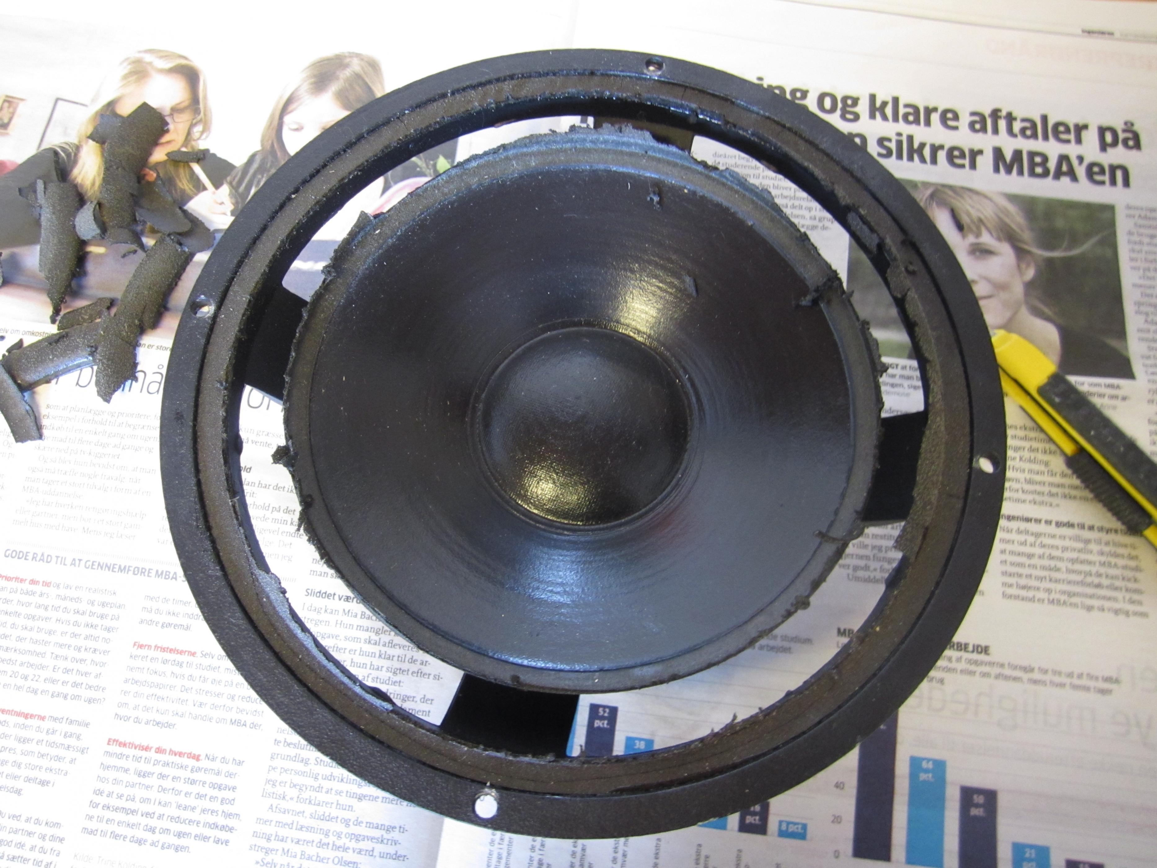

Removed the old foam today. Really sticky stuff.
A small sharp wood chisel proved most efficient to remove the stuff.
Used alcohol to clean the last stuff off.
Some came on the membrane an was a bit hard to get off.
I'll give them a thin layer of black spray paint to make them look good before putting the new foam on.
Stay tuned 🙂)

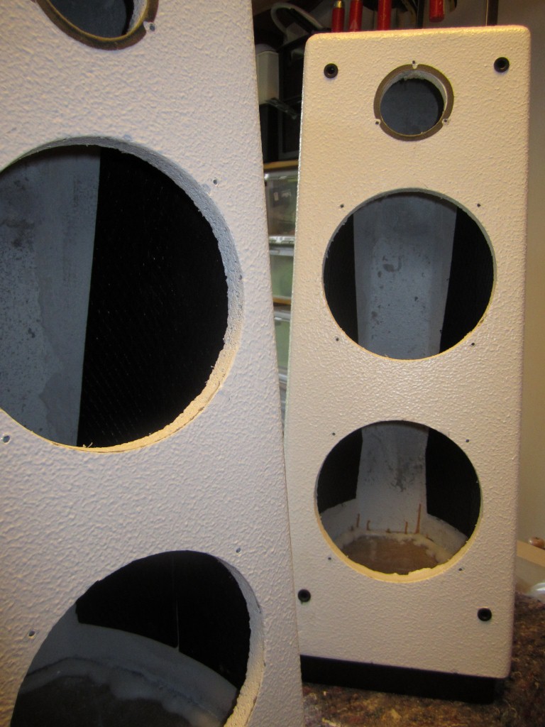

Gave the speakers a new coat of white paint (oil based) ... woow they look good.

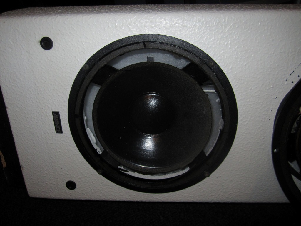

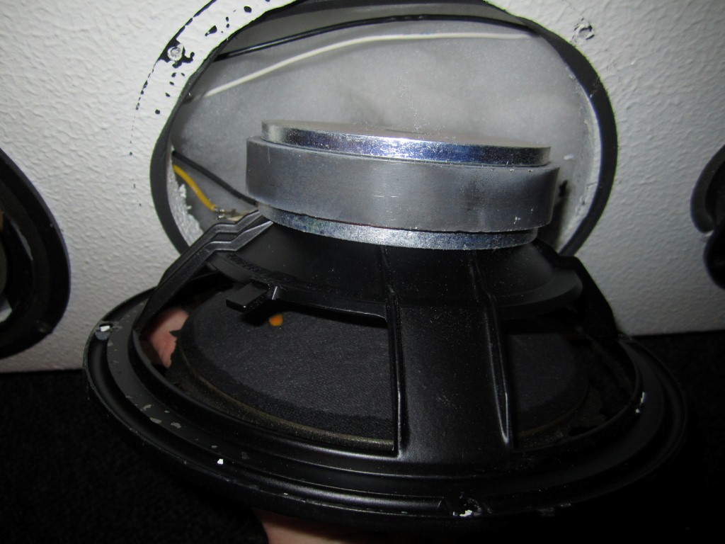

Refoaming
All 4 woofers have now been refoamed.
I used AudioFriends.nl, which can be recommended.
It was actually not that difficult. I was a bit afraid that it would be hard to center the drivers in the magnet gap, so that the voice coil will not scratch. But I just started gluing the surround to the membrane, let that dry and then glued the outer rim of the surround to the basket and just made sure that everything looked symmetrical. I think that most of the centering is done by the spider anyway.
Before I refoamed them I gave the membrane a very thin layer of black spray paint. Think the result looks really good.

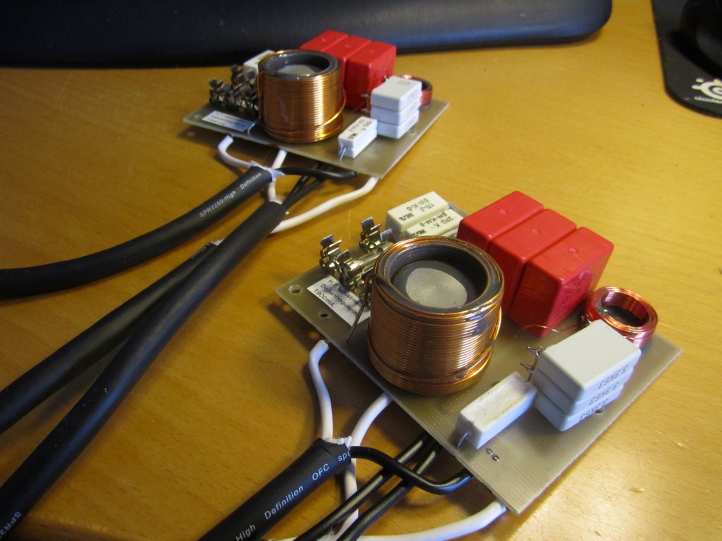

I changed the 10 uF electrolytic in the filter with 3 x 3.3 uF MKT, and re wired everything with 2.5 mm2 cable.
The box is really stiff as it is made of fiber concrete, but it also has a tendency to ring when knocking on it. I therefore use some damping rubber used for cars glued to the inside. Think it has helped some, but it is not a miracle cure. I used “No More Nails” to glue it to the inside. Great working stuff, that sets immediately, but a bit expensive also.
Now I’m looking forward to put it all together and put them up for a listening test 😀

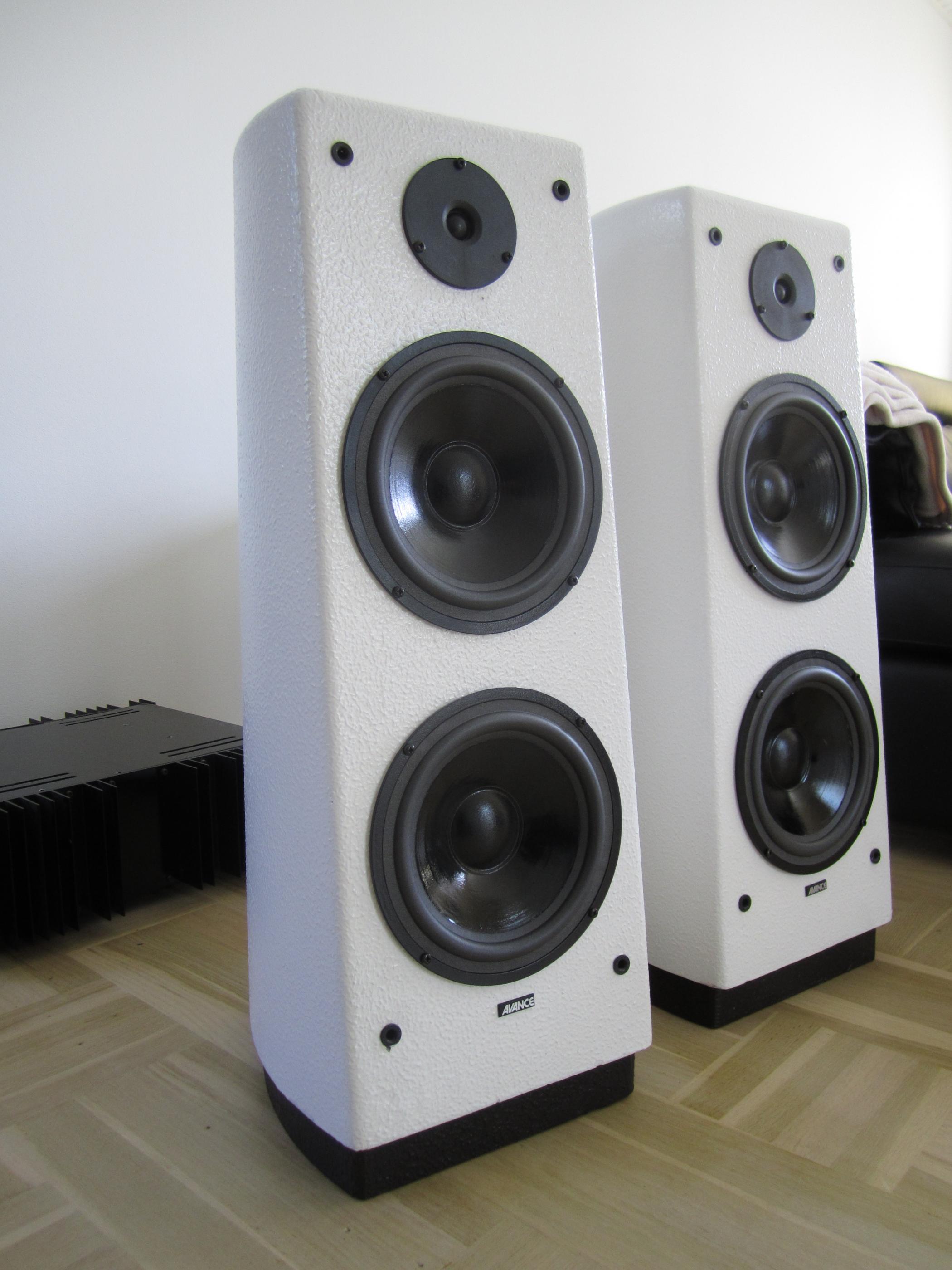

Restoration almost done
Almost done. Think they look really good 🙂
Only thing missing is new fabric on the grill.
But how does this speaker sound?
Well I was afraid that they didn't have enough low bass, but that is not the case at all.
The sound is rich and without sharp edges. They sound relaxed but with ok resolution and room. Not bad at all for a speaker more than 25 years old 🙂

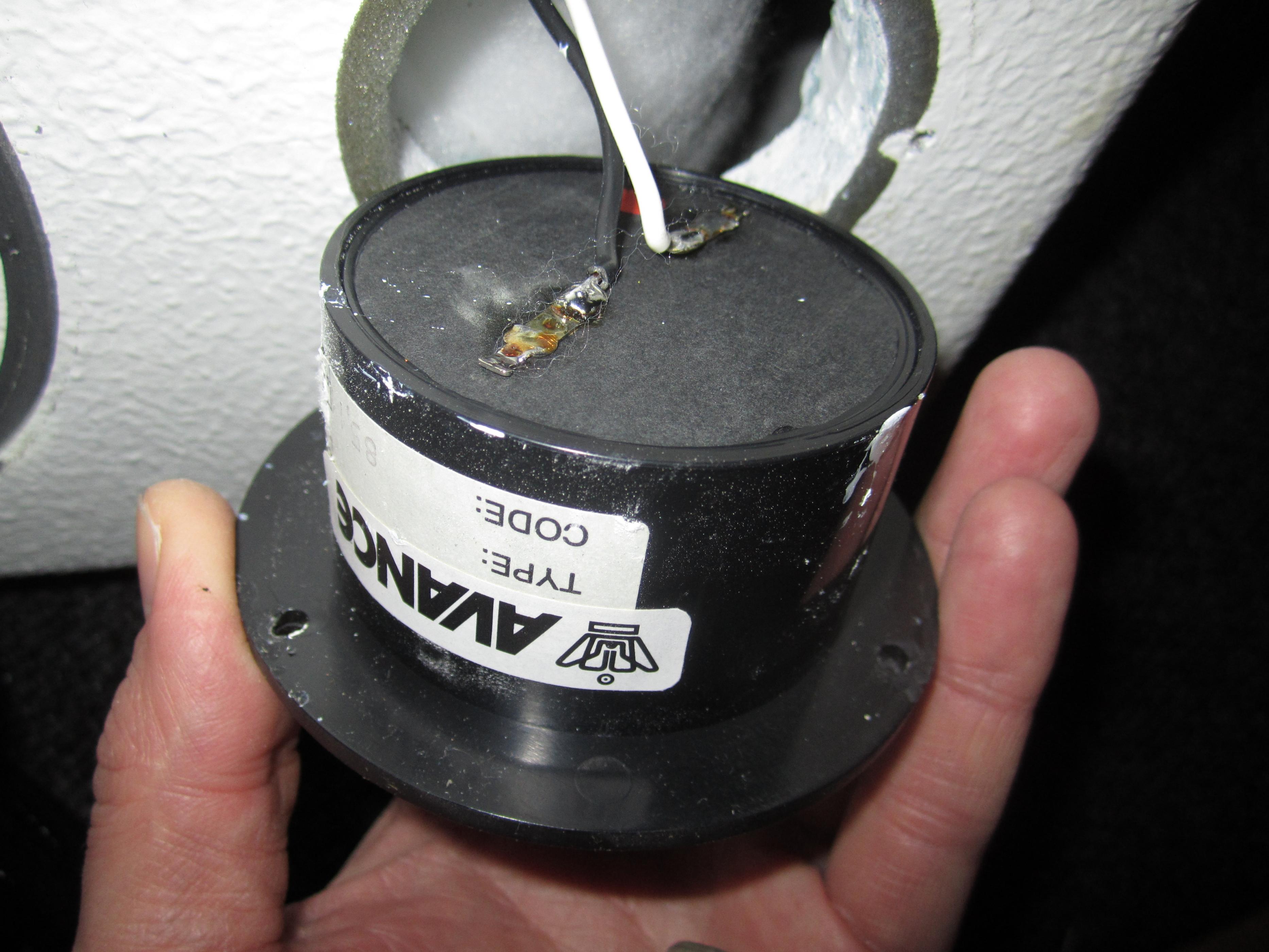

Just got me A pair of Avance Concrete 180. Nice but Took apart and found out that the speakers was not connected. Now the Q...
How is the speakers connected to the filter, it is the bass unit I need to hook up are they hooked up in series or parallel 😡😡😡

Didn't see this question before today ... sorry ... did you find out??
Two af the drivers are passive radiators and should not be connected ... their role is the same as a vent in a vented box, but with some advantages like no vent noise ....
Baldin
