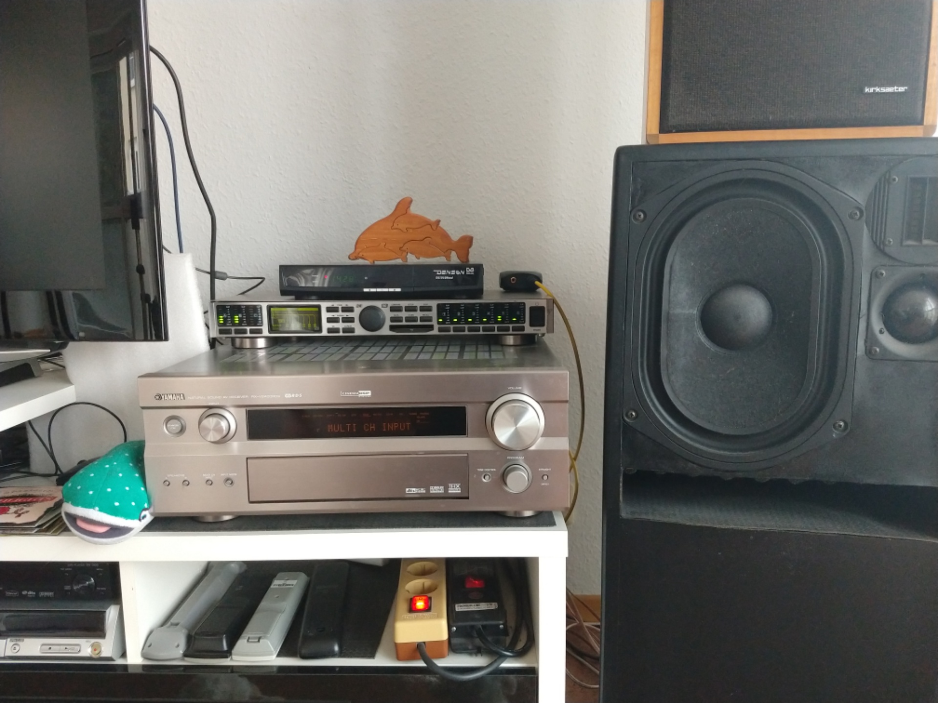

Using Yamaha as 6 channel poweramp
Hi
I am using a Yamaha RX-V 2400 as a 6ch pre and power-amp with dsp ( Najda) for many years now, absolutely without any problems, setting to 8 channel multi channel input, you need an amp with that option, most Yamaha homecinema amps from 2004 till 2013 have this option.
You can pick one up, here in Europe, for around 125 Euro,.Put in a new 22 nF cap in the power supply pcb and it will work for many more years!
Cheers, Tojoko.
