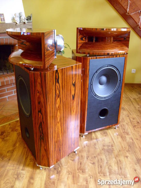

http://1.bp.blogspot.com/-CeMVNykHMZE/UlnBlXbGI3I/AAAAAAAAFIs/8swThRwf3jQ/s1600/DSC_8484_1.jpg - autotech horns system made by diyAudio - View Profile: cka3o4nuk using above (#6,#8) mentioned algorithm 🙂

I love that system, especially the shaping of the midrange enclosure to suit the horn, but I sure wouldn't attempt it as a first design!

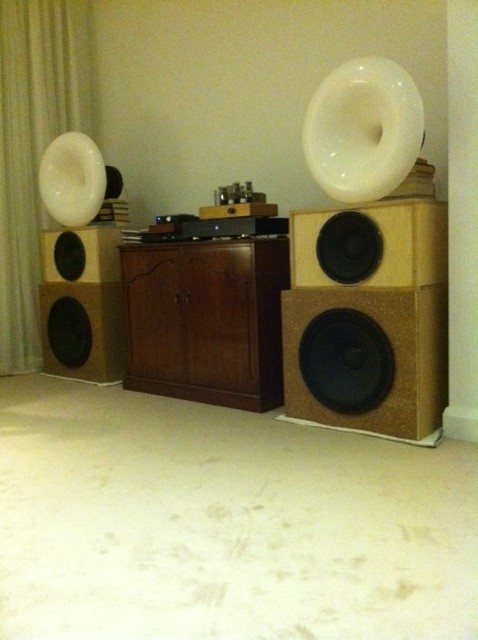

See attached pic of my mid bass and separate bass module, with EV 18 inch. I'm using 12-inch Kappalite for the mids, crossed around 500Hz to the Azura horn and 2-inch JBL 2445 CD's.
