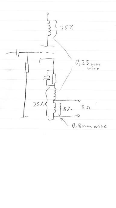

In my experience autoformers works well in output stages.
I´ve prototyped a PL504 SE amp with DIY OPT´s where about 25% of the primary winding is between cathode and ground, and a part of those 25%´s are wound with thicker wire and acts as secondary winding.

Fuling said:I´ve prototyped a PL504 SE amp with DIY OPT´s where about 25% of the primary winding is between cathode and ground, and a part of those 25%´s are wound with thicker wire and acts as secondary winding.
how did you keep the DC out of the speaker?
I did a PP amp this way which took care of the DC, but i have always feared even with a really thick secondary i would still get some DC on the speaker if it tried this with SE. Maybe a ma or 2 dc could be a good thing 🙂

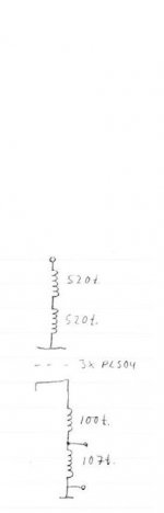

Here´s how I did it:
As you can see the part that the speaker is connected to is made with considerably thicker wire, so the DC voltage across it is very small.
I don´t remember exactly, but the DCR is way below 1 ohm and the curret is around 100mA, so do the math.
This was just a prototype I made for fun and to practise my transformer winding skills, but it turned out quite good.
The bass response was way better than you´d expect from a ~3W SET with small homemade OPT´s.

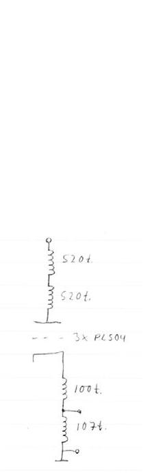

Inspired by this I´ve ordered parts to build a bigger version with 3 x PL504 per channel, each running slightly hotter than in my prototype. I expect to get 10-12W out of that beast, enough to feed my bass cabinets.
Not looking forward to wind the OPT´s though, it´s a mess...
BTW: If we connect the screen grid to a fixed voltage (WRT ground) instead of to the plate we get 25% UL operation "for free"

Fuling said:As you can see the part that the speaker is connected to is made with considerably thicker wire, so the DC voltage across it is very small.
i guess the question becomes how much DC through a speaker is too much? assuming an 8 ohm speaker has a DCR of what say 6 ohms and your secondary DCR is say .25 ohms (not sure exactly what well under an ohm means) this means 4ma of current will flow through your speaker. i'm not sure if this is good, bad or a non issue, but i do know it will offset the cone within the magnet structure in one direction or another.
an interesting experiment would be to listen then invert the phase of the signal and reverse the speaker leads to see if a ma or two + or - made a sonic difference.
I wouldn't be surprised if the two connections sounded different and i also wouldn't be surprised if one connection sounded better than a situation with no DC on the speaker.

Fuling said:
DCR of the part that connects to the speaker is around 0,4 ohms, so I´expect about 120mA offset at 300mA plate current.
not sure i follow. if the secondary is 0.4 ohms and the DCR of the speaker is say 6 ohms (typical for a 8r speaker) then i get 20ma of current through the driver.
do you notice if the speaker cones change position (overhung/underhung) when the amp is connected?
dave
Hmm, for some reasons 20mA sounds much worse than 120mV
I haven´t tried the transformers in a circuit yet, so I can´t tell.
If it turns out to be a problem I could always just disconnect the secondary from the primary and loose some of the cathode feedback (and turns ratio)
