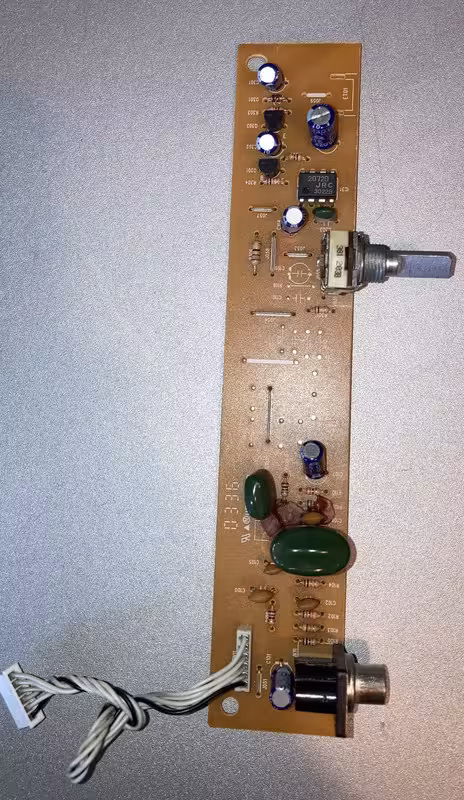

I cant find any service manuals or schemes online for this model and honestly even if I did I still wouldn't understand what I'm looking at without some help 😆 I've opened the back and there are 2 PCBs connected by a flat cable, the main one where all the main electronics live and a smaller one where the LFE IN and volume knob are connected.

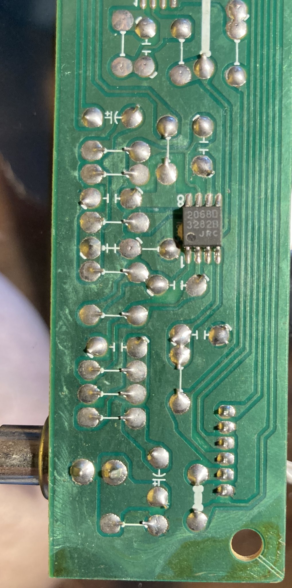

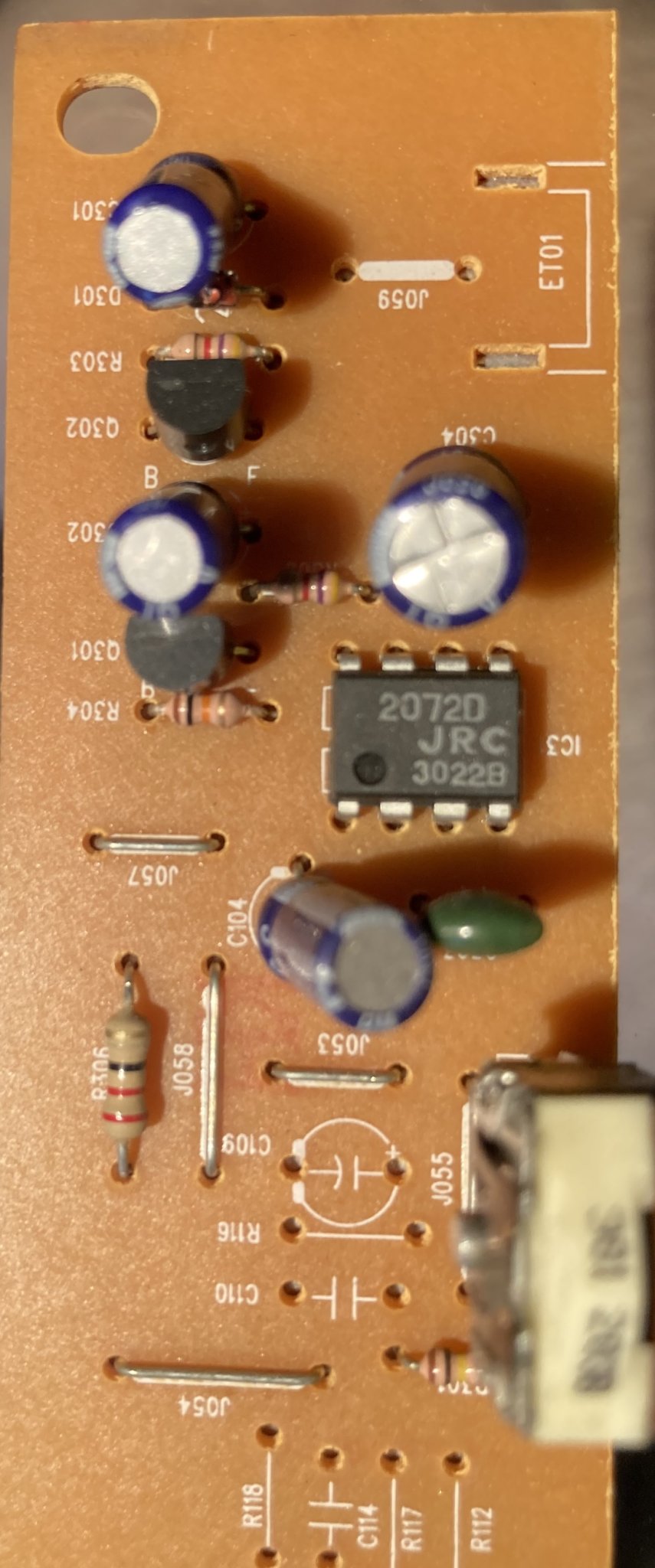

I'm back with some pictures and findings... probably 🤣
The sub has 2 boards, the main one and the input one.
On the input board there are 2 chips, the first is a NJM2068 amplifier - I've attached the spec sheet
The 2nd one is a "SIGNAL LEVEL SENSOR SYSTEM" chip... something tells me it's the one I'm looking for 😅 I've attached the spec sheet
I dont have fancy equipment, just a multimeter and I've been following the circuit w/o power and signal so I cant be too sure of what I've found out...
I dont understand what the hell is going on around the amp chip but what Im sure of is that the A output of the chip goes pretty much directly to pin 1 of the signal level chip (I have continuity using the multimeter)
On the signal chip pin 6 (OUT1) goes (after some more mystery components 😀) to the ribbon cable that connect to the main board (probably to the relay switch)

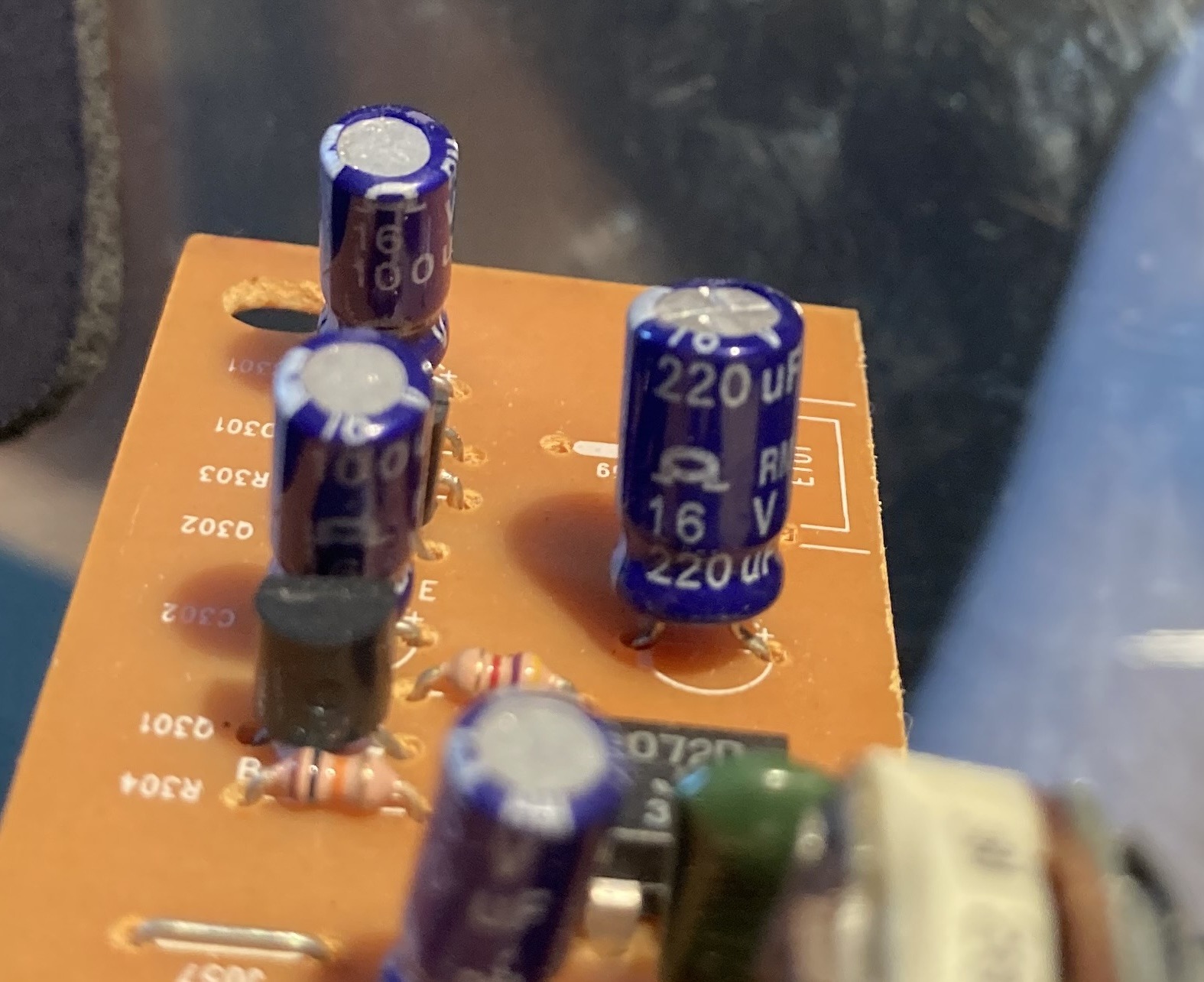

I dont really understand if anything can be done to increase the signal level but Im more confident about increasing the shutoff timer. Pin 5 is called "Capacitor for Recovery time" and it's currently a 220uf 16V cap:
If I'm not mistaken this should tell the chip after how long to cut the OUT1 signal to the relay to cut power, right?
The timer is about 1-2 minutes at the moment, do you think I can increase that by replacing the cap? I'd like to reach 5-10 minutes if possible!
Can you help me figure out the value I should replace it with?
Thanks!
Yes you are correct about the function of that capacitor, I've seen some circuit use 1000uF for longer delay off time.
My suggestion is to solder a 680 or 820uF capacitor on the PCB trace side, in parallel with the 220uf capacitor, to increase the capacitance value, please make sure the capacitor is installed with the correct polarity.
