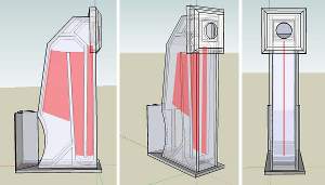

Hello everyone!
After thinking for some time I decided, I will go by the Austin A166. 😀
I read several threads where you talk about materials. And I understand that the baltic birch plywood is best for this type of horns. But, I can not get baltic birch plywood here and order it is very expensive. 😱
What I can get here is:
1) Plywood (Eucalyptus Grandis) (common, in about 9 layers)
2) MDF
3) OSB (Oriented strand board)
4) Particle board
What is the most appropriate? Maybe a mixture of any of this? 😕
Taking only these materials, I have the idea of strengthening the cabinet.
Is this possible / desirable? (See picture. Red you can see where I want to include reinforcements)
Any opinion is welcome.
Tnx. Sergio Fontenla.

Sergio,
You dont have to use Balitc Birch, but you want a good cabinet grade plywood that has many thin layers, instead of construction plywood that has thicker and fewer layers.
You can use birch or any other good plywood. Do you have anyone near that makes cabinets?
MDF will work but it will not have the tone of good plywood.
If you build it as designed you do not need any bracing. If you decide to add stifness layers they should be external to keep inside dimensions correct.
Ed
Baltic Birch is often used as a generic term... here shop grade baltic birch is what we use because it is fairly cheap. I've been trying to change to using "quality multiply".
The Eucalyptus plywood should be just fine as long as it doesn't have lots of voids.
dave
dave
while I'm no so optimistic that the 'lyptus Ply would be as void free as the BB, I'd wager it'd still be a sonic improvement over PB and certainly over MDF
(for Godness sakes, let's not open that can of hurt so soon again!)
re your bracing scheme proposed (in red) - they certainly needn't extend the full length of each fold to brace the panels - but if more than 100mm wide, consider cutting some holes
one area that you didn't indicate was the rear mouth, which could probably benefit from a narrow (8-mm or so) brace, angled to bisect the final flare
I think my best move is to get the best possible plywood.
MDF and PB are discarded.
Today I went to see the Eucalyptus Plywood offered by my local dealer.
It is very bad and useless. It's full of knots, and has only six layers.
I contact with suppliers in other cities to see what more they can offer me.
Whenever I get the news they reported.
The topic of bracing I leave for later, once I have the material.
