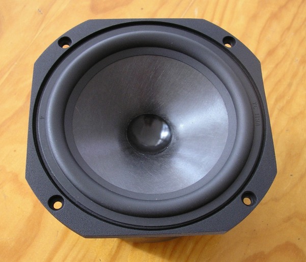

Just ordered a pair of the new model mid woofers (AC130/50CK), the Oz distributer has them in stock so could not resist. I will see if I can take some pictures when they arrive. Comments from the local distributer have been very positive about the new models and after a marathon session at the computer I think I have found a way to get an acceptable result from the MLTL cabinet with some mods. Not ruler flat to 40Hz like the old woofer, but should be OK (I hope). More later.

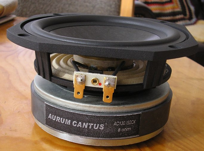

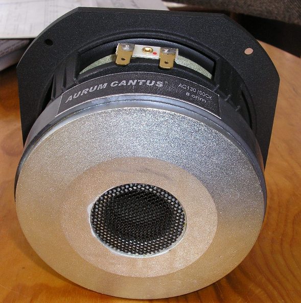

Well the AC graphs of the AC130/50CK look bumpy, but look at the scale on the graph. The bumps are only 2db so are not such a problem.
Looking at these drivers they really are quite unusual. They are really big for a 5 & 1/2", weigh more than 2kg each! The voice coil is also unusually big (50mm), most drivers of this size have 25mm voice coils, but the dust cap is still small. Result is an unusually high BL, high voice coil inductance and resulting low Qts. The high voice coil inductance is likely to lower high frequency output. Indeed, if you examine the specs of the older driver, it does appear that high frequencies are attenuated. However, most carbon fibre and kevlar drivers have some nasty breakup and AC seem to have reduced this and maybe a high voice coil inductance helps. These drivers are also unusually well ventilated. There is ventilation under the spider and a huge rear vent through the centre of the magnet. End result is a very high power handling (150watts) for a small driver and an xmax of 6mm which is also unusually big for a driver in this price range. Also there are copper shorting rings to lower distortion usually found only in pricey drivers. Then I could be talking out through my backside since I know very little about driver design, but is an interesting driver with some interesting design decisions. Don't know how they can do all this for the price.
Just wish I could do something with them so I could hear how they sound, but at the moment I can barely walk and can't lift any weight.
