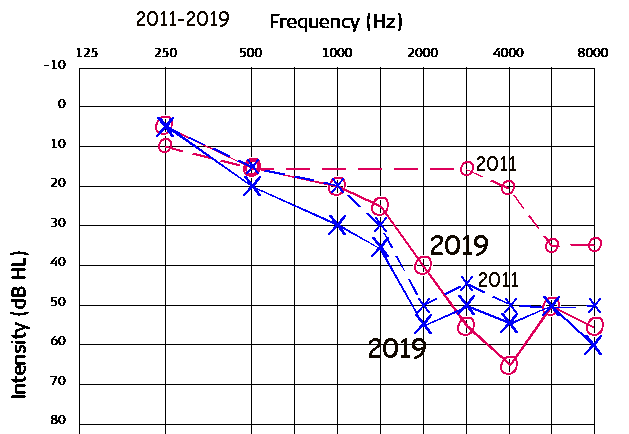

Audiometric threshold is about as described: softest tone heard in "silence". For good-hearing folks it is hard to find sufficient quiet; fortunately someone like me does not hear background 50dB up from what I heard as a youth. Oh, and in US practice the tones are ISO centers, so the lowest is 125 if not 250Hz.
The curve of smallest audible sound is NOT duplicated at medium loud levels. Nerve damage acts like an expander or "noise gate". My ski-slope hearing actually flattens-out in 80dB SPL field. This is common but far from universal.
BTW: I have an audiometer, a real-ear probe (and aid tester), a stack of books and notes, and my Noahlink programmer.
