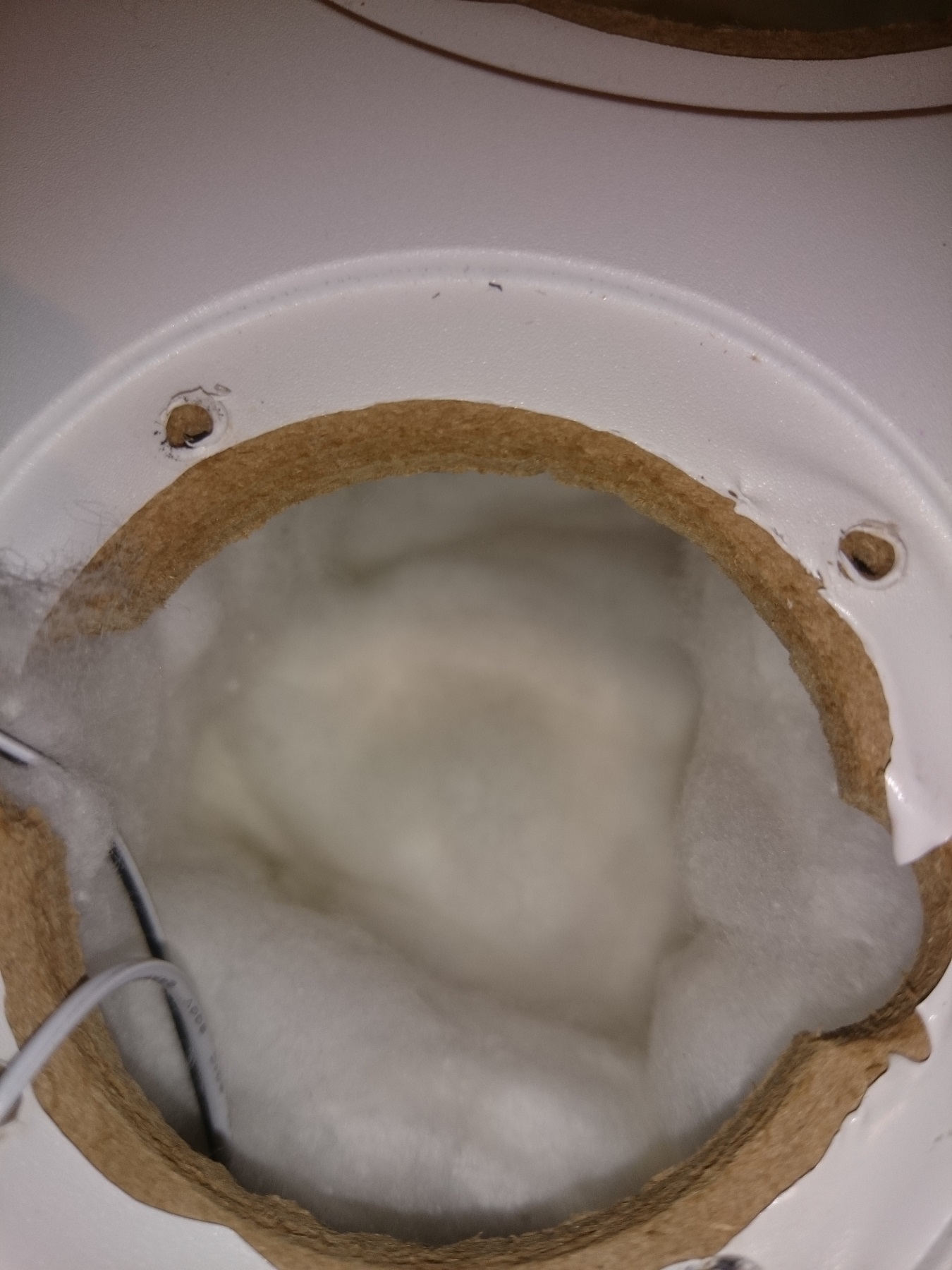

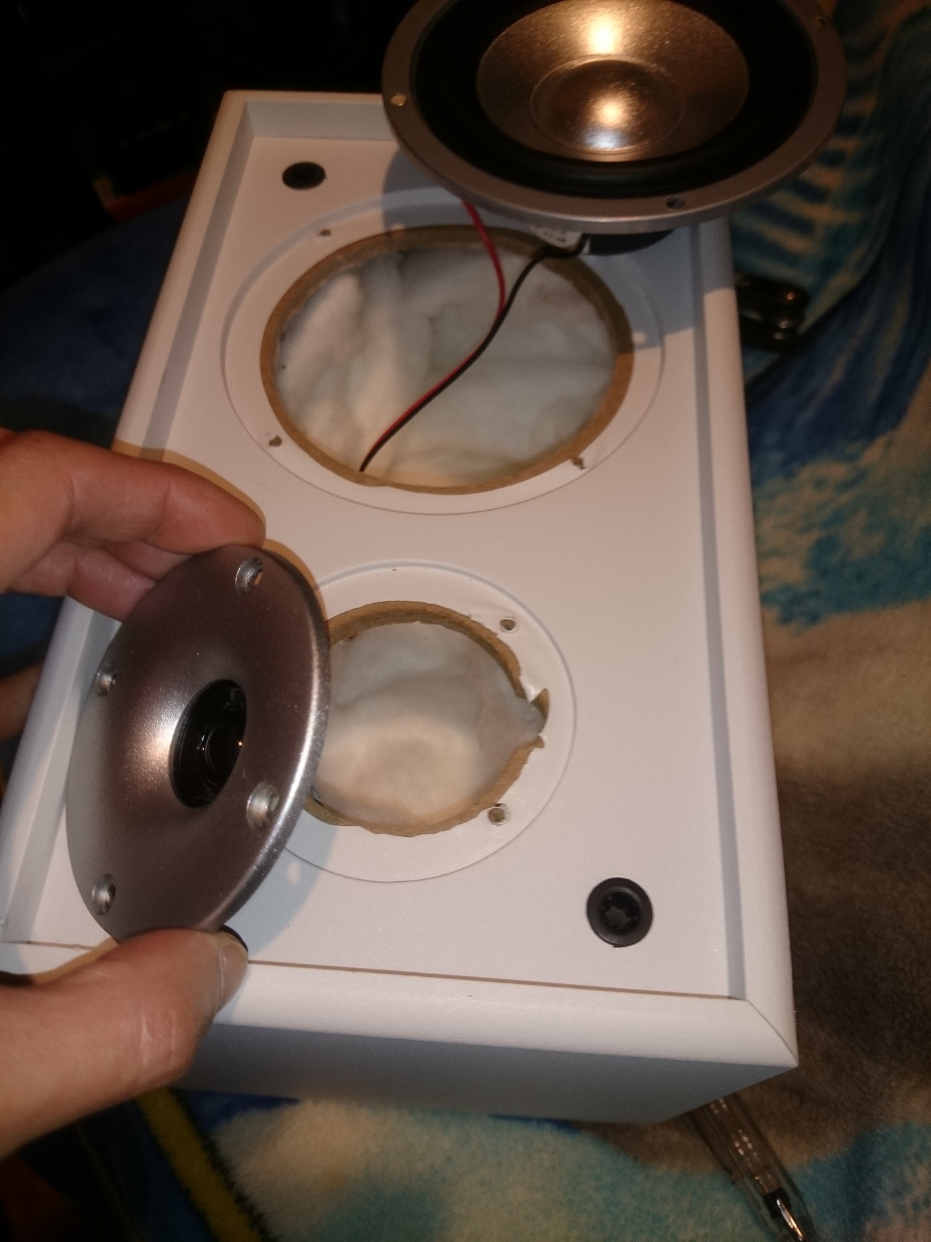

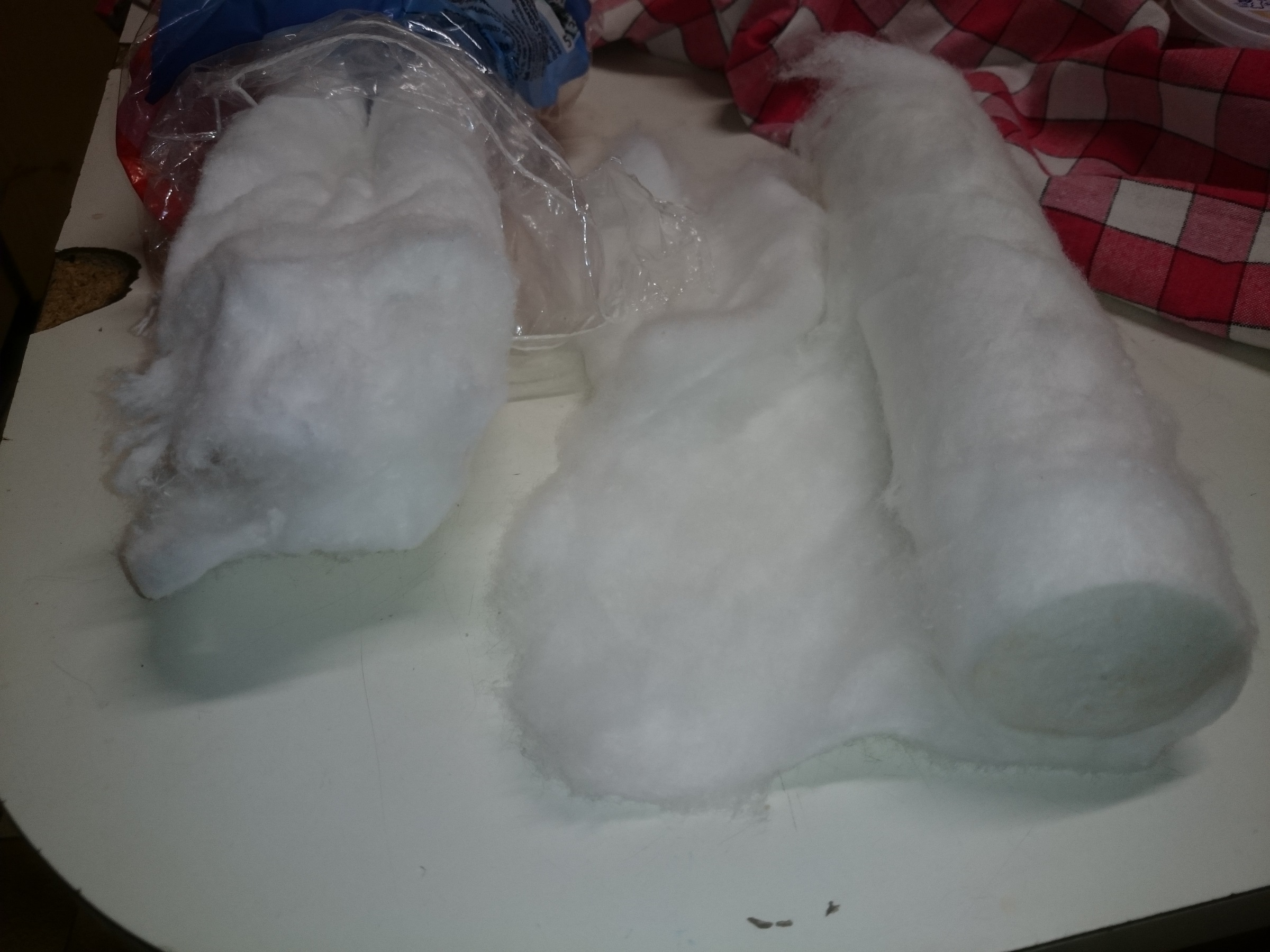

It usually works better when it is not on the sides. Some materials can be used to lightly fill the box. There are some questions from this... will it stand up on its own, is it so thick that if you put it near the driver it will block the path?
I have used the cotton material in the attachment, the thinner denser cotton on all sides and the thicker but less dense cotton around.
Can anyone check if the speaker is good filled the way like the pictures?
