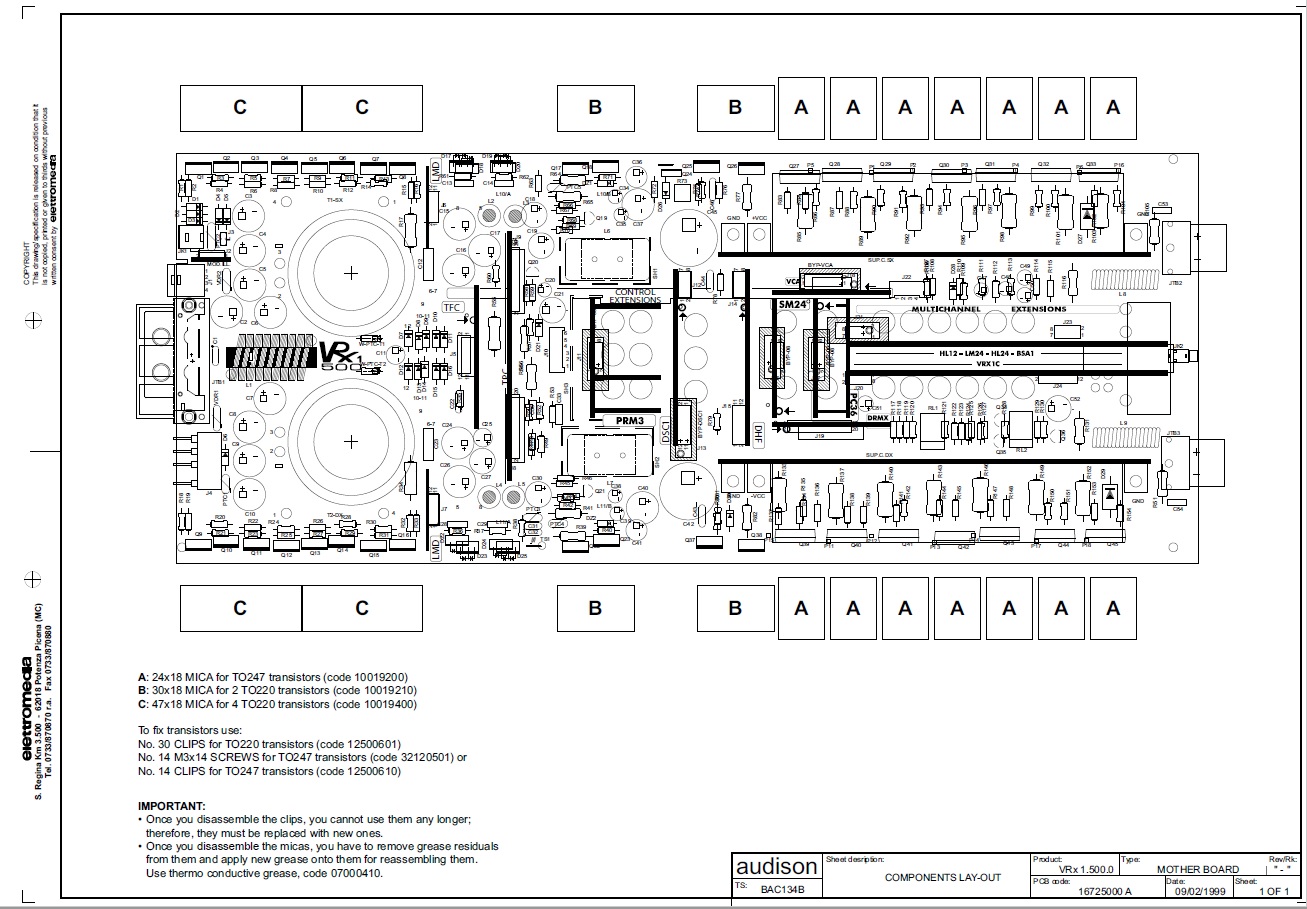

I got this amp. What is the proper way to remove these clamps? Also i have service manual, there is mention, that old clamps cant be used, only way is to put back with new ones.
Hi
i am the Service Lab in Israel of Audison & Hertz. i use flat screwdriver to move out this spring clamps with no problem, and Because I release them has been skillfully I can bring them back. Of course if I need new clamps I order it from the manufacturer.

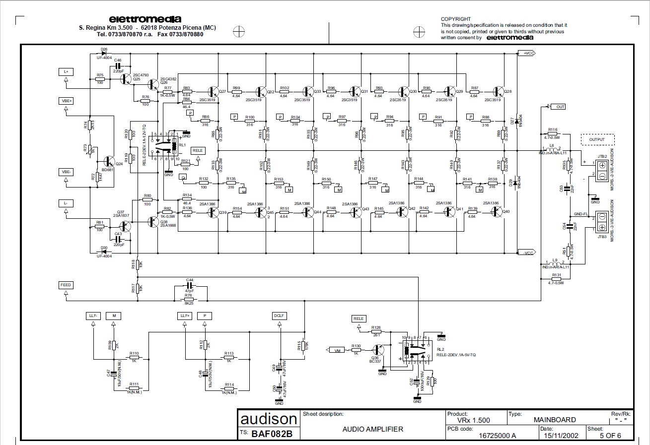

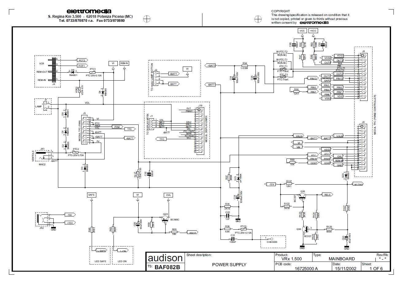

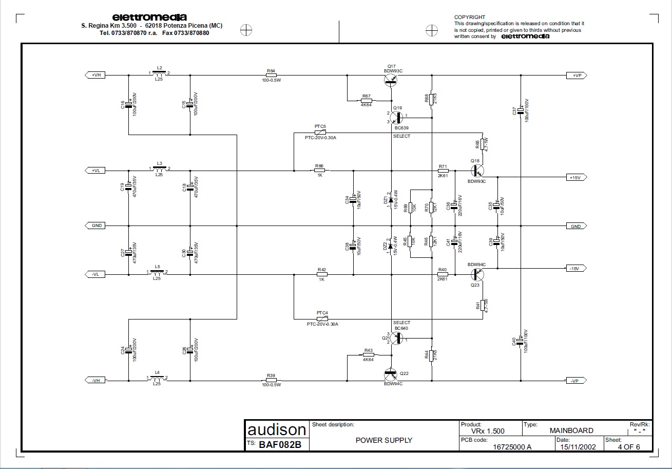

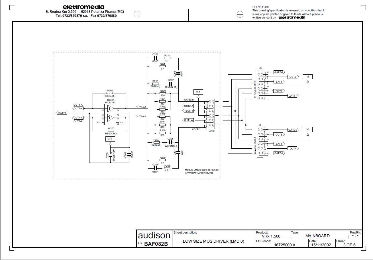

With 2 amps limit the voltage stay at 7-8V. The rail growing the I listen a click and it fall. I need the psu section and the power amp section. The analog audio stuff I think don't care.
I do more try. Without the DHF module the power supply start up correctly and no dc on the output. With the module there is dc on output and the psu cycle on off. Can you give me the schematic of dhf module?

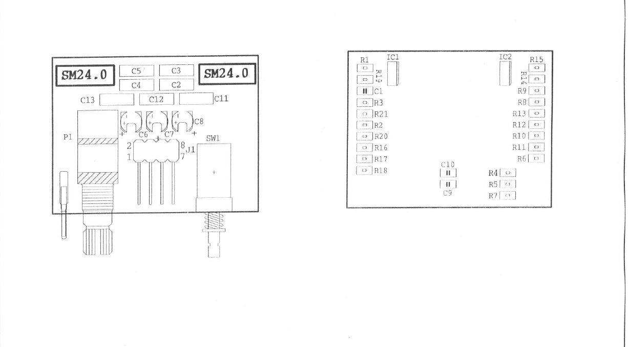

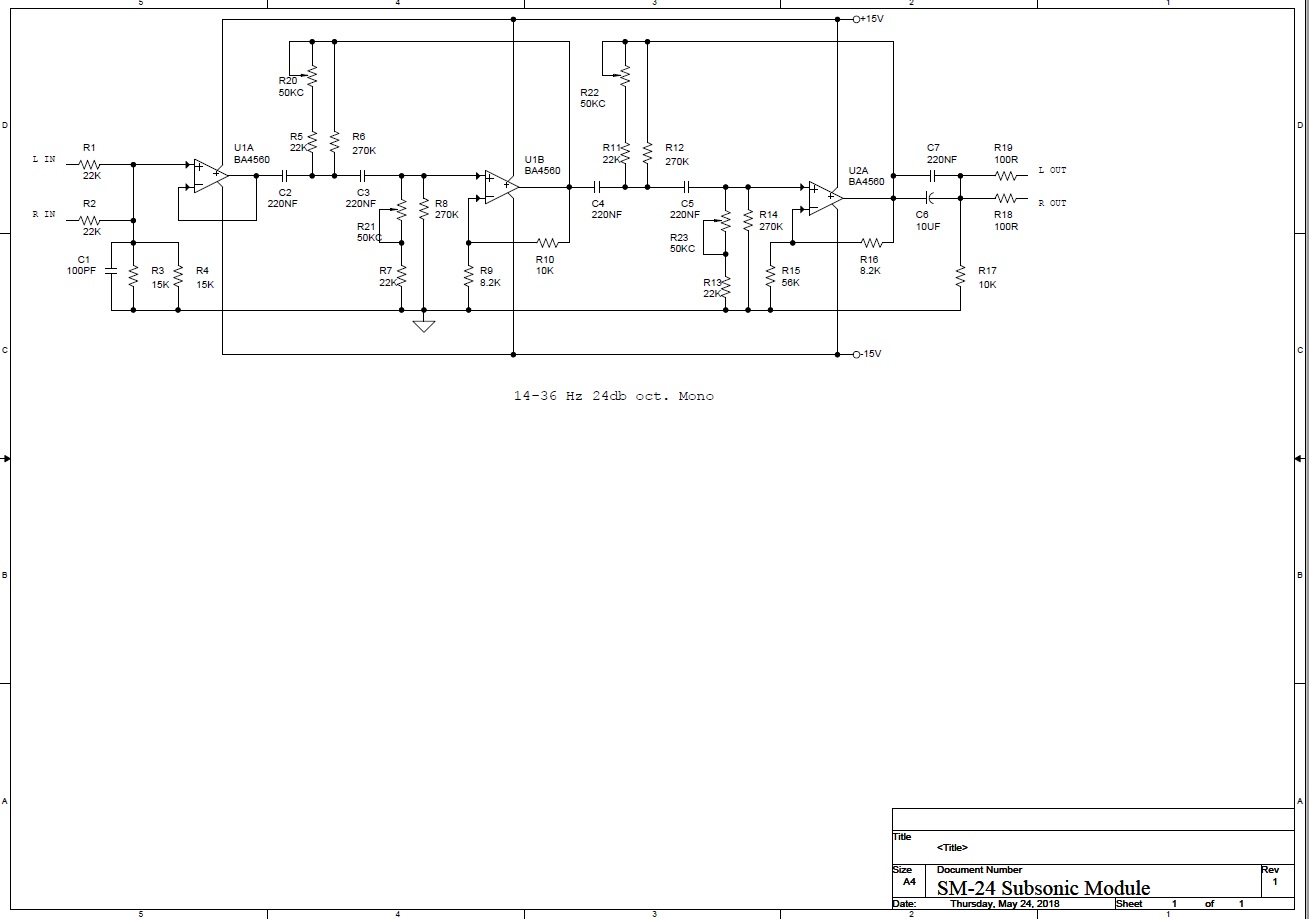

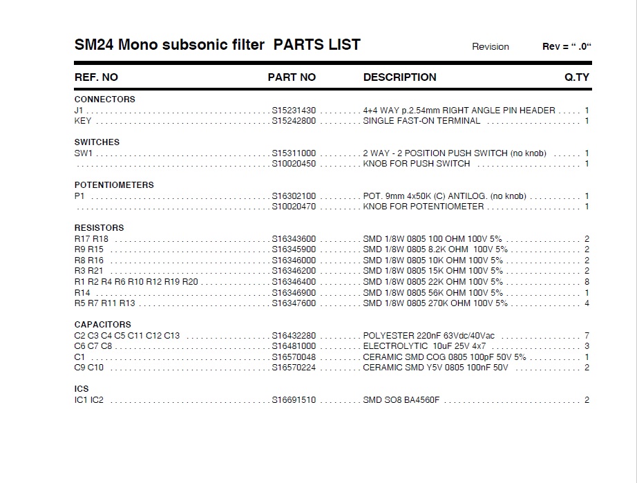

Any chance you have the sm24 subsonic filter module and can show how its builtup? I havent got one in my amp, and i kinda need it so i'm thinking about builsing my own since it is so rare to find one!
SM-24
You don't happen to know where i can get all the parts on the list? Hate that i bought this stupid nonsettings amp..
Most modern head units have built in crossovers and equalization. Do you really need to build the module?
Yes, cause i have a **** headunit x) also i can't find any external subsonic filter anywhere, so ita probably easier to make my own since it is made to be there x)
