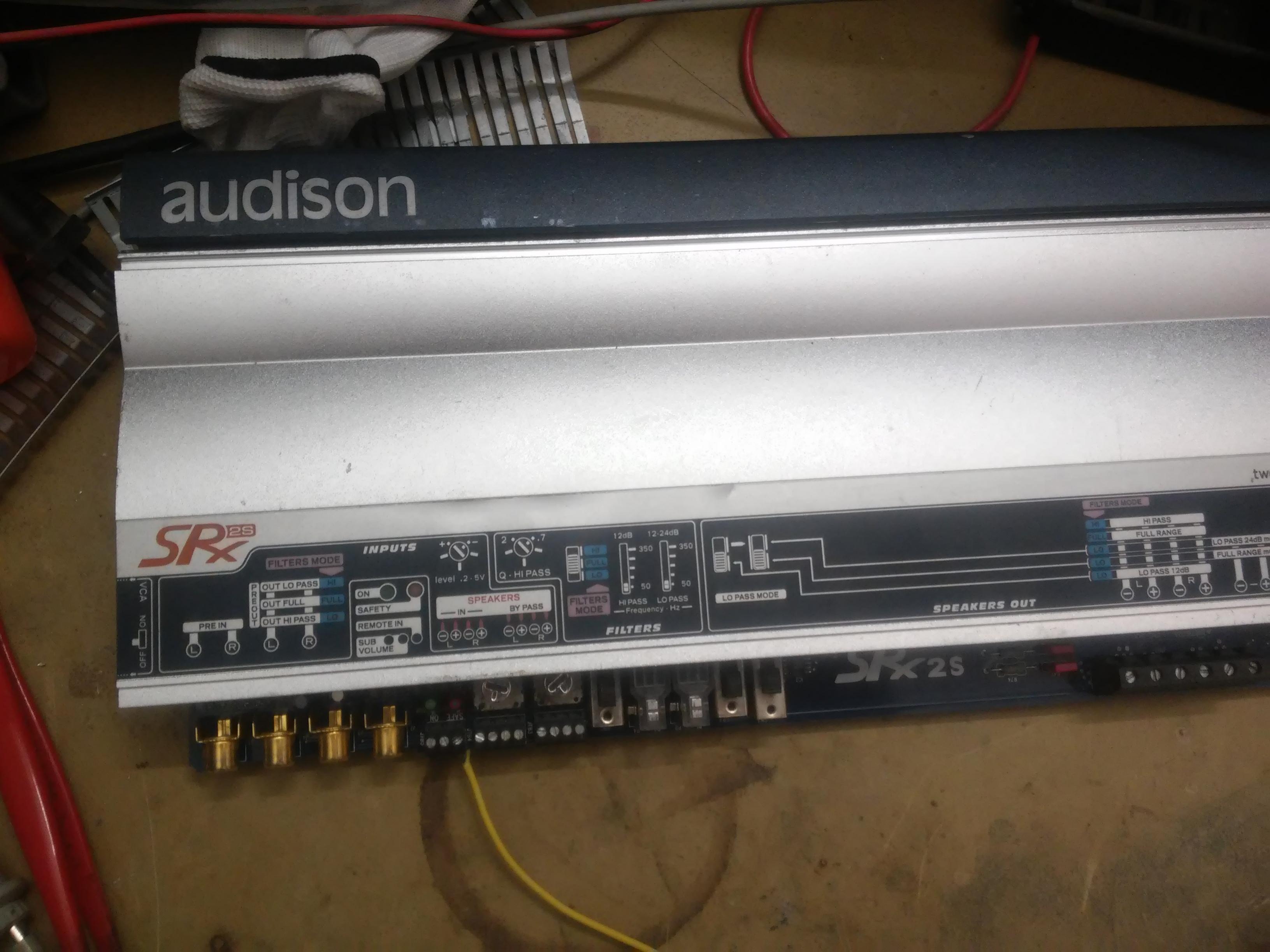

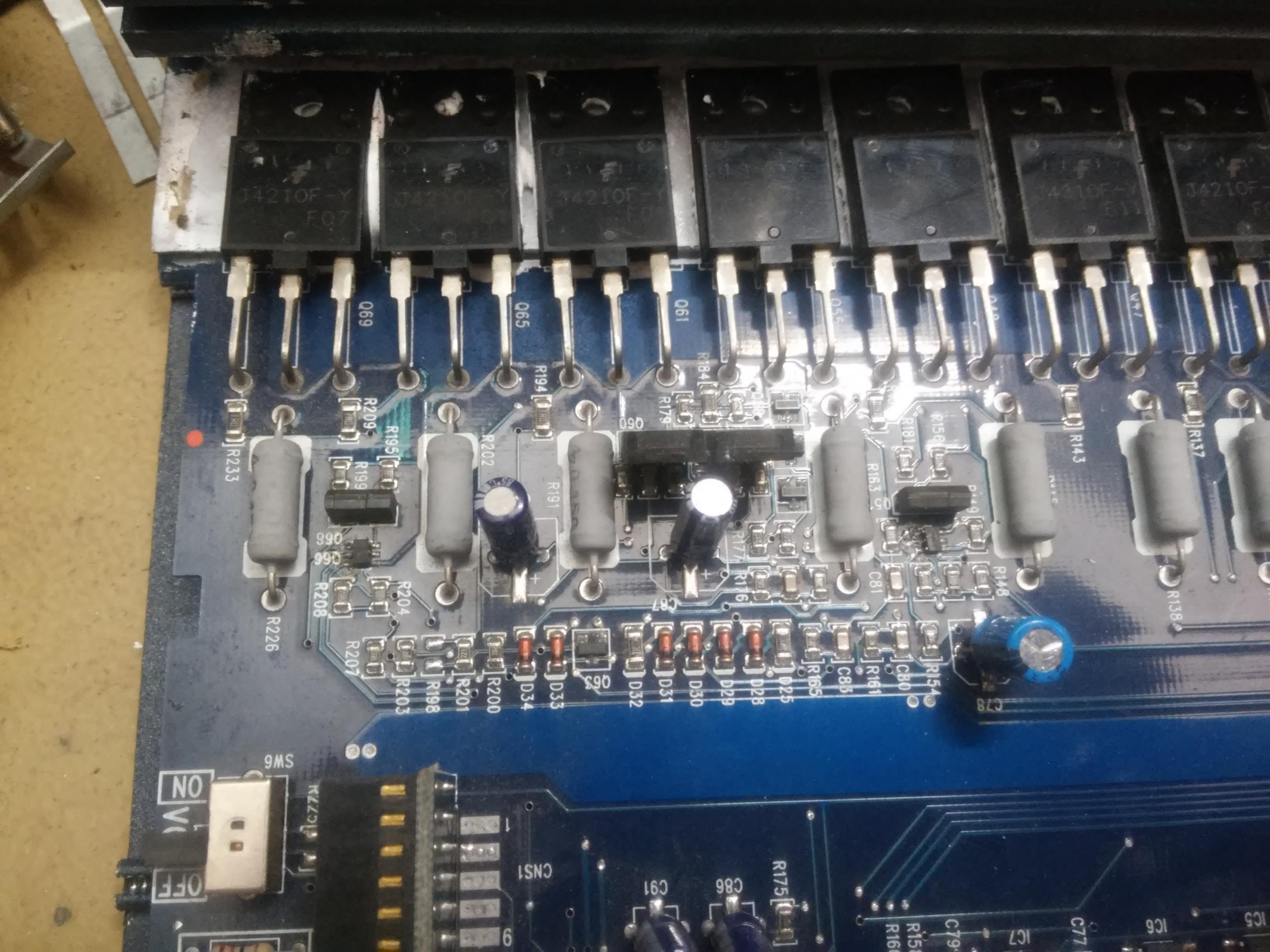

Hello. Does anyone have scheme for audison srx2s?
I have +6v dc in one chenal.

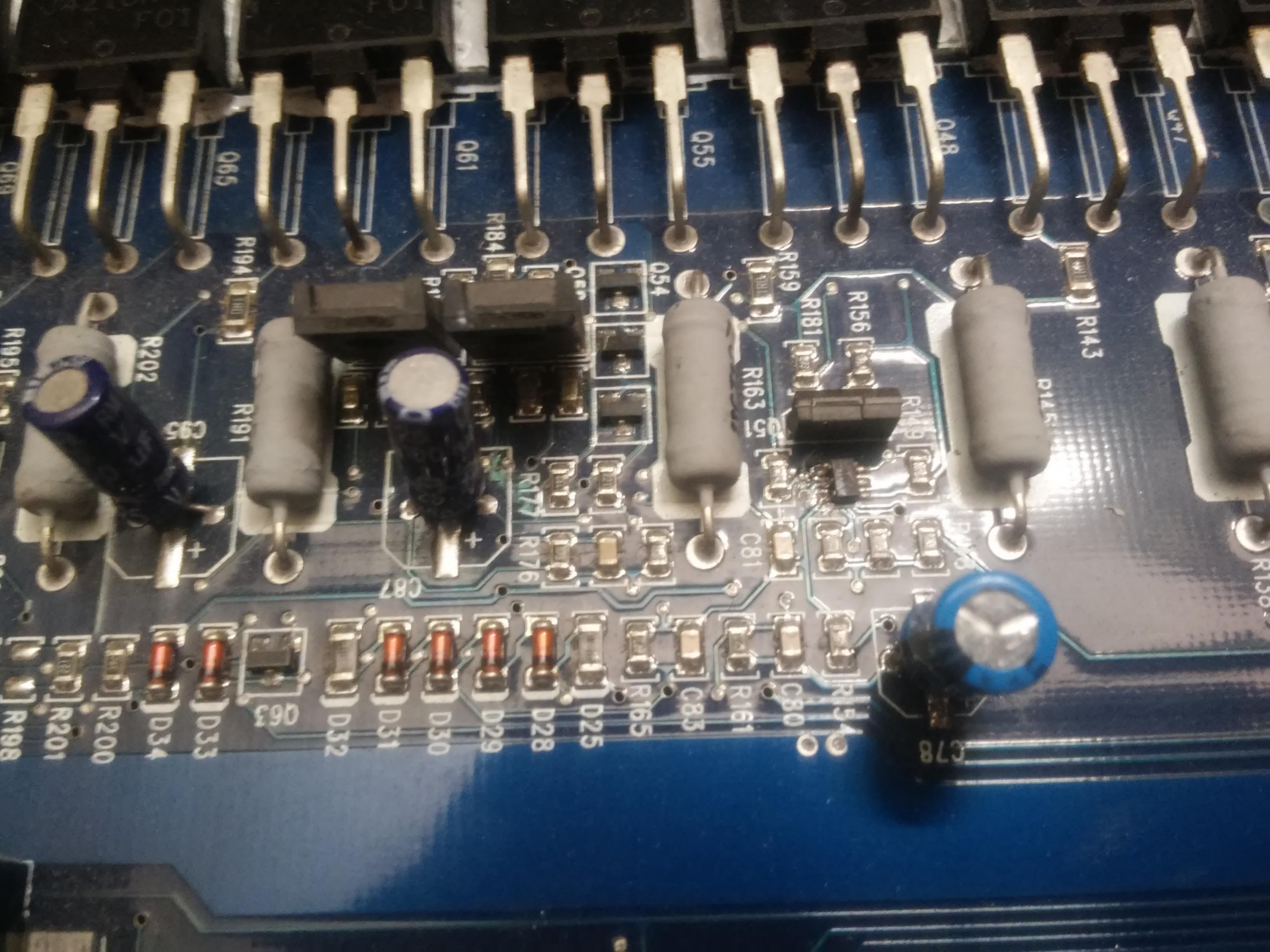

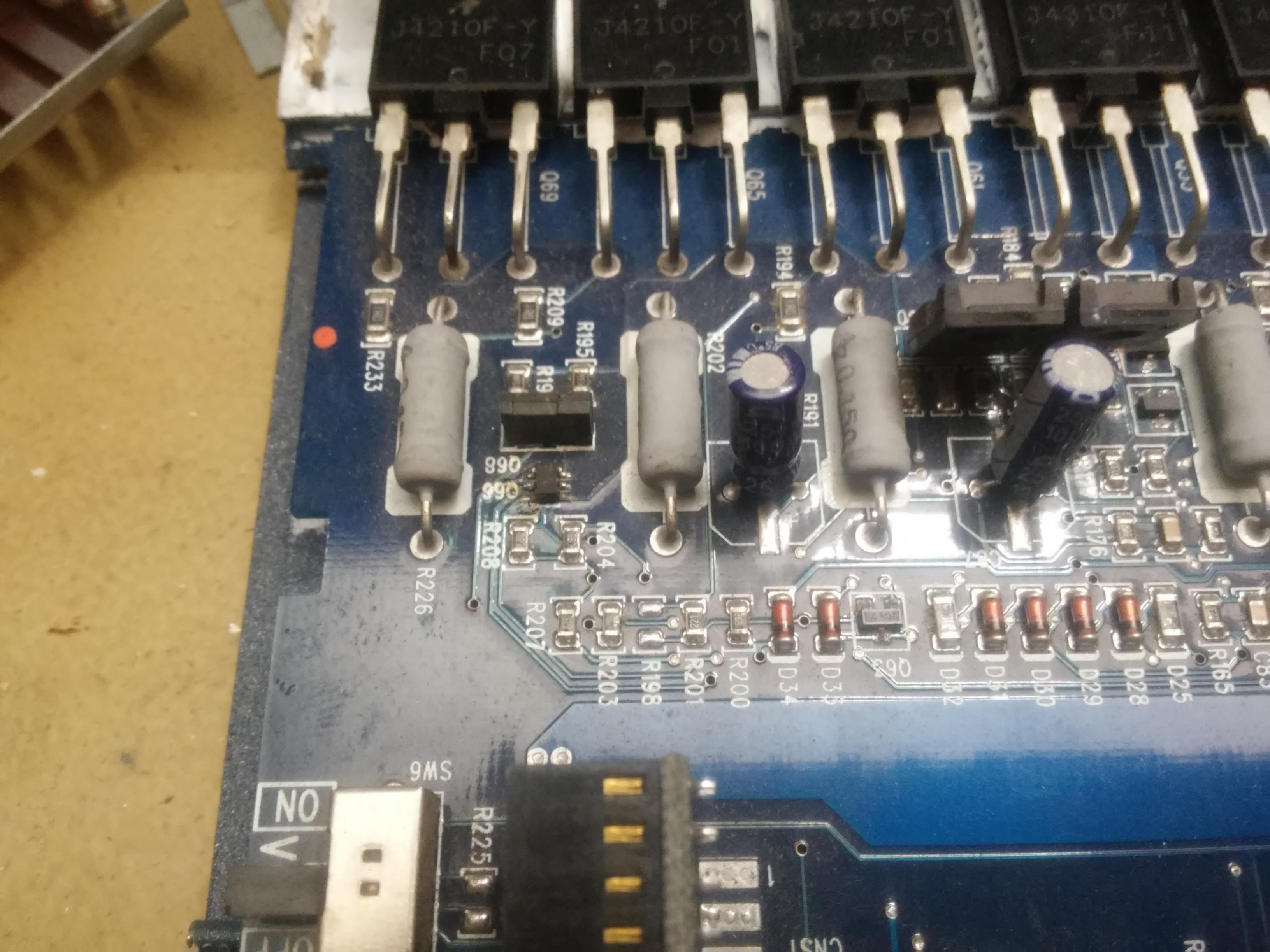

it like ppali say it look like corrosion that you have on the board.
try first to clean the board if it's not help move out the 2 differential transistors. Q66 and this one behind Q51. if the 6V dc at the output is now 0V you know that the problem comes from this 2 or 1 of the input differential transistors (Audison use mostly IMT4 and IMX8 Dual transistors
