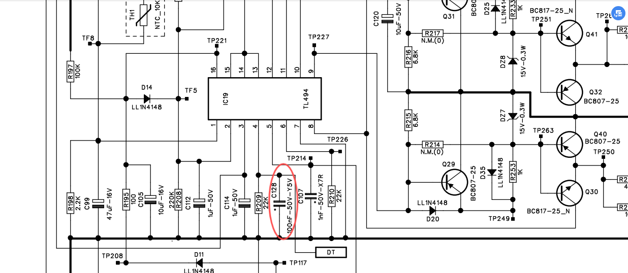

I have an Audison SR1DK with a weird issue. The output at startup is not at full power and it gradually rises to full power. Changing the gain does not affect it much, and the signal is clipped when the gain passes a certain threshold.
Also, does anyone know the value of this capacitor (C128)?

Sorry for bothering you,Hello, this might help youView attachment 1400296
