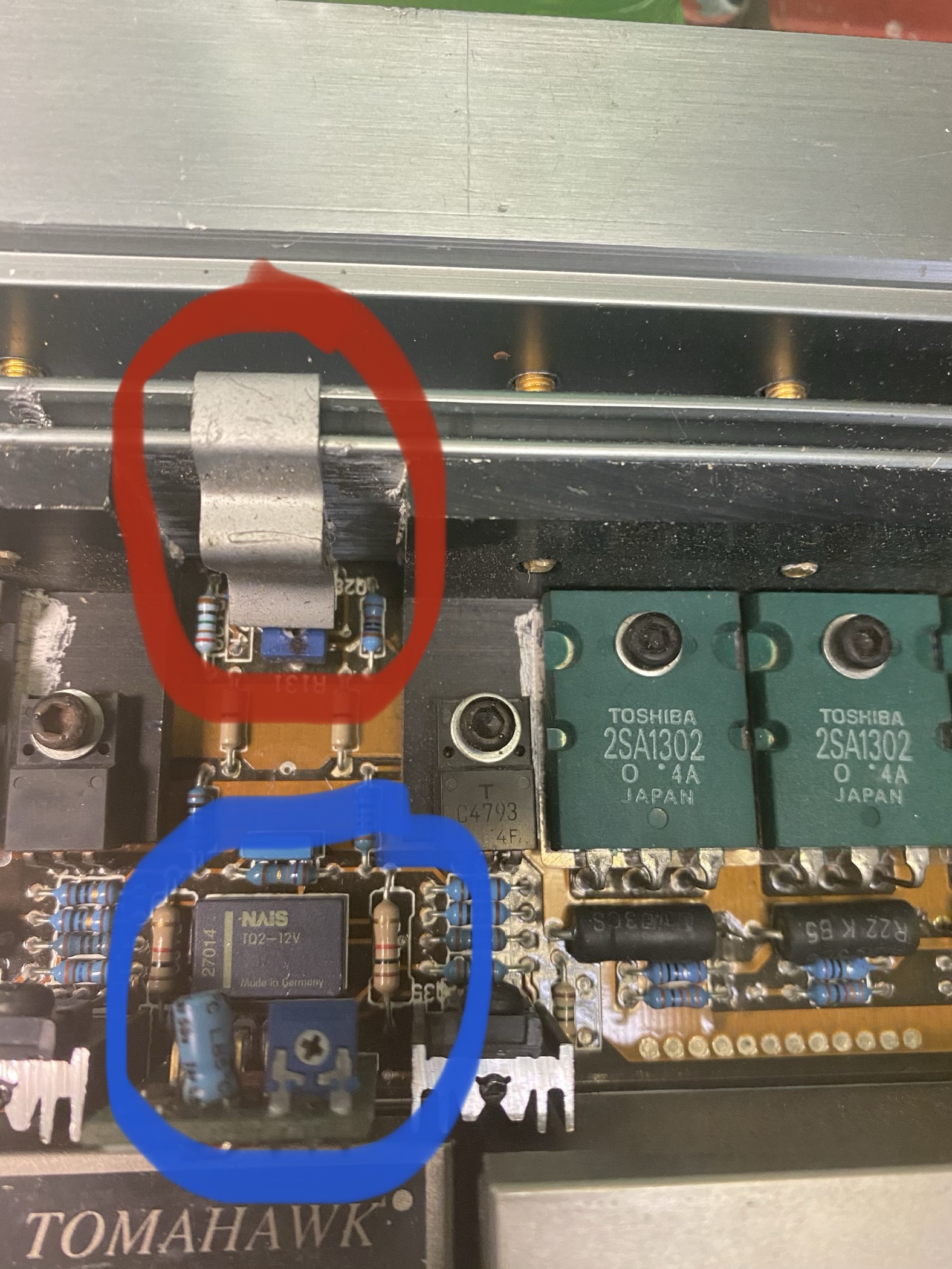

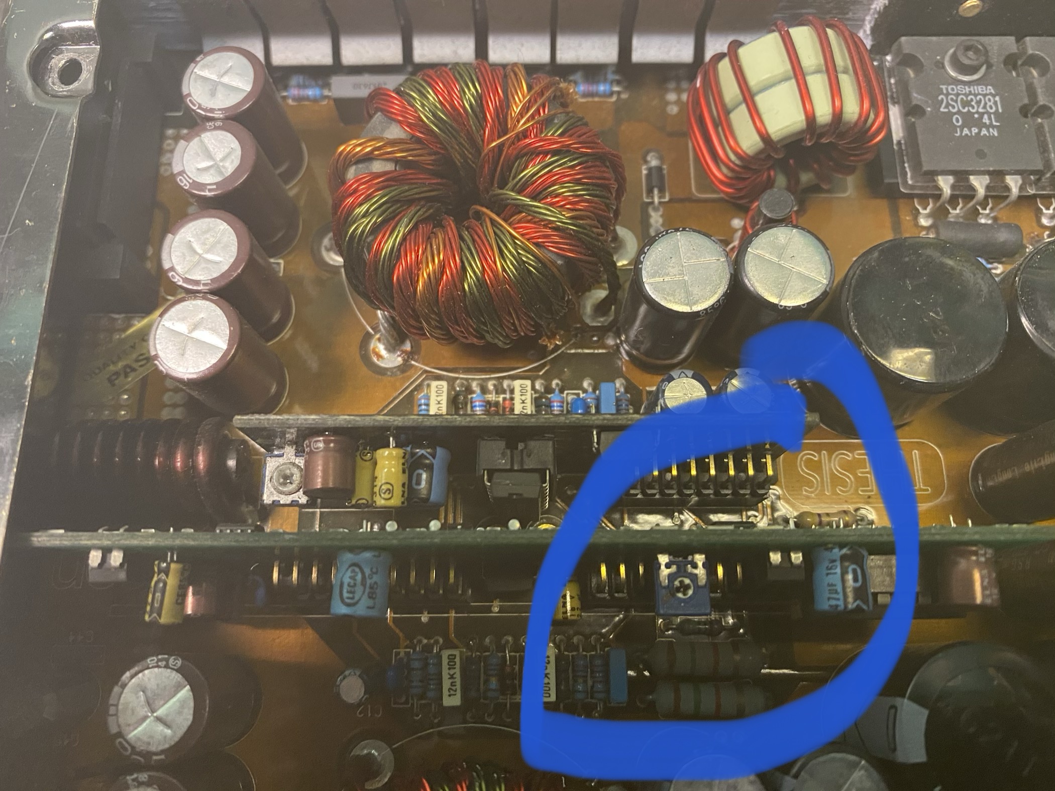

Amp powers up and idles at 20 amps of current .
Amp works besides the idle current is way to high .
Any ideas on this ? Do I need to adjust the bias or idle current ?

This may be an amp that's designed to run at high bias. Were both channels causing precisely 1/2 of the overcurrent?

It’s supposed to idle at 2.6 amps as factory specs .
It was idling at 10 amps .
Only 1 channel was causing the bias issue other channel was fine I set them both the same but only 1 channel was Causing the issue .
I tried adjusting them while watching the current draw if you set it fully counter clockwise the amp will draw excessive current so I set 1 channel and it took care of the issue then reset the other channel and it’s right about 2.5 amps of current draw per manufacturer specs
