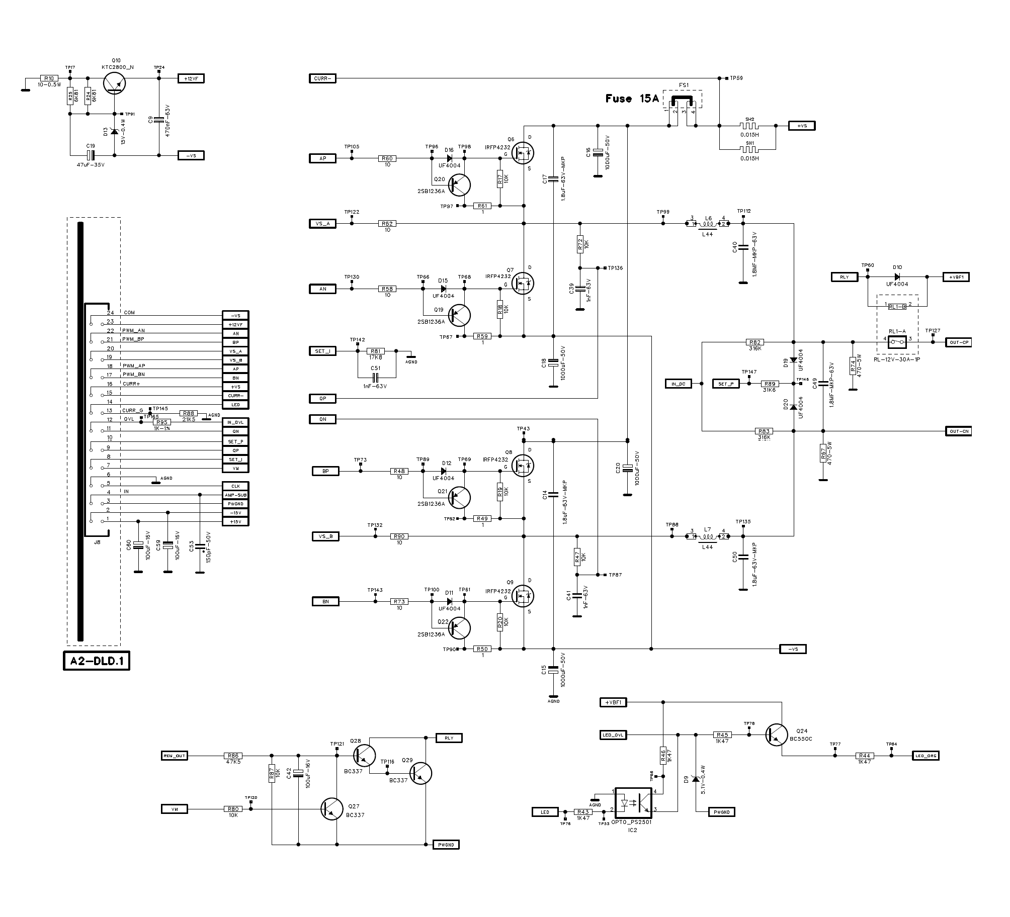

Hello,
I am working on an Audison AV5.1K, which came to me missing diodes D11, D12, D15 and D16. Does anyone have a schematic for this amplifier or could you tell me the reference of those diodes? Thank you.
