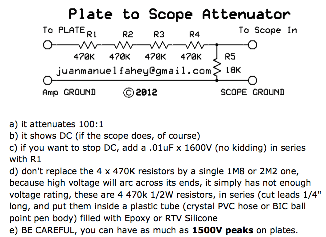

Also, I wondered if it's safe in order to measure at tube plate voltage. Maybe preceeded by something like this;
