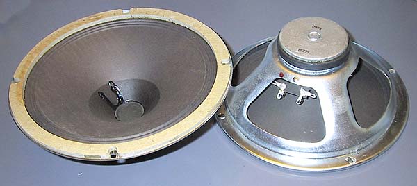

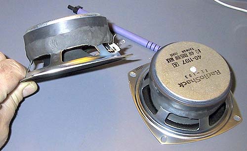

The baffles were made from two pre-finished Woodstalk shelves cut to length at Home Depot, connected by a piano hinge. The full-range driver is run wide open, the tweeter uses a series 4.8 uF combo. I tried smaller caps (higher crossover), but didn't like the sound. I added a phase plug to the tweeter consisting of a Marenco twist electrical connector with a bolt threaded in it to attach magnetically to the tweeter pole piece.

Here are the pics:
Hi Nielsio,
The drivers are recycled from vintage speakers so I don't have a lot of information about them. They may be Coral - Dave could probably tell us exactly what they were from.
Eric
Eric
I'm really glad the parental units are enjoying them 🙂
I scored these drivers before i got the alnico ones you scored many moons ago, so their actual provenance is long lost in my memory. They do have a very nice curvelinear cone with treated centre.
What are the numbers on the magnet?
The tweeters are what i call 2" thimble tweeters (because the magnets are shaped like thimbles & not much bigger). There are variations from all 3 of the major Japanese OEMs. Really quite a decent tweeter and cheap (i get all of $2 USD/pr for them).

Very nice 😎 I have an idea of how to do my OB HT system now 😀 Btw what damping material did you use on the speaker basket frame?
planet10 said:What are the numbers on the magnet?
I'm not sure Dave, I'm already 2 hours away - not that it matters anyway!
BTW said:Btw what damping material did you use on the speaker basket frame?
I used a product known in North America as Ductseal. It feels like sticky modeling clay, and does not harden. I found it at a hardware shop (Home Hardware). I've attached a picture of what the packaged material looks like.
Eric
Serow said:Ductseal
aka "magic"
not many speakers that won't benefit from it.

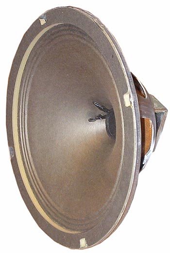

Here is another pic of the FRs... i didn't save a big pic of these, but based on what i can see, here is the story -- the codes on the back look like they are RSC (Radio Speakers of Canada)*, but the cone is not. Because of trade restrictions in the old days it was common practise for foriegn manufactures to get stuff OEMed in the target country. My bet these are built for Telefunken by RSC using Isophon cones & RSC baskets & magnets... and then possibly sold by the Bay or Simpson Sears under one of their house-brands.
* would be confirmed by a 4 place code that is something like DKW9.
Eric
Thanks Eric, I'll see if I can get some from the hardware shops 🙂
BTW said:I'll see if I can get some from the hardware shops 🙂
I get mine at the local HVAC wholesaler.
dave
