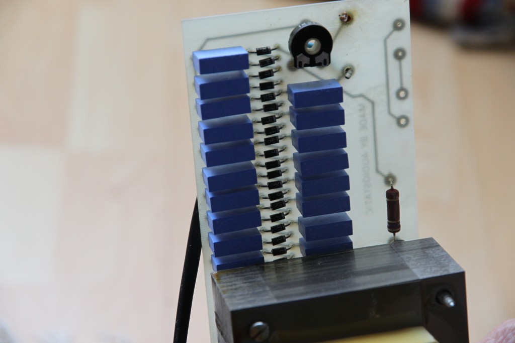

A few years back I bought a pair of Adiostatic ESH100 speakers. A hybrid set of a conventional woofer for the low end and an electrostatic panel for the mid a high spectrum. I did a restoration job, you know reglueing and refoiling the electrostatic panels and fresh paint. When I powered them up I was really satisfied with the result achieved.
But in longer listening sessions I found out that one of the stats was somewhat lower in volume than the other one. Forum member mattstat provided me kindly with several very useful hints. One of them was his advice to check the bias supply. Because life stood in the way it took me a year to pay attention to the audiostatics again.

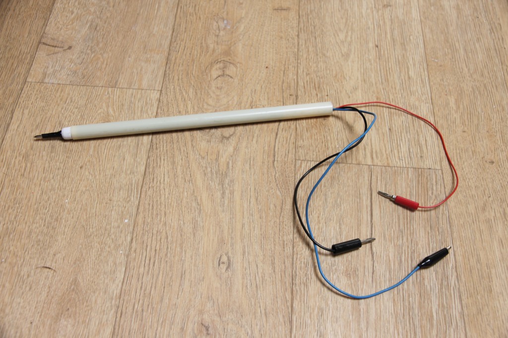

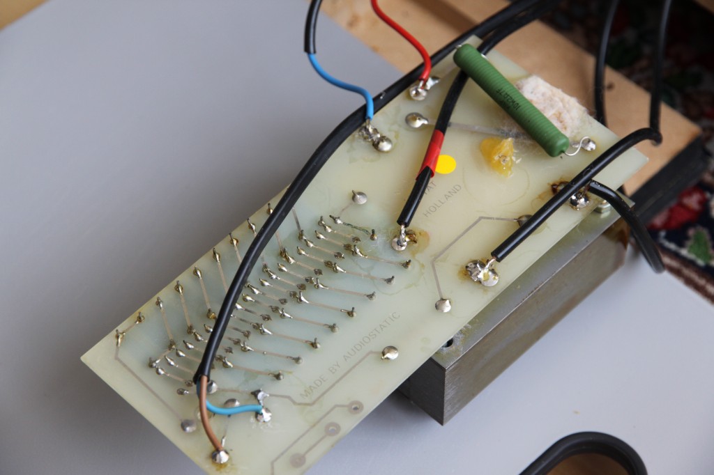

I diy'ed this simple bias measurement tool (picture). A 1 Gohm hv resistor in series with a 1 Mohm one and double isolation. I don't expect exact measurements but for comparing and adjusting bias voltages it should be okay.

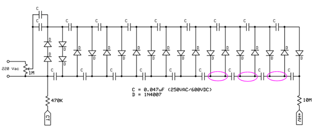

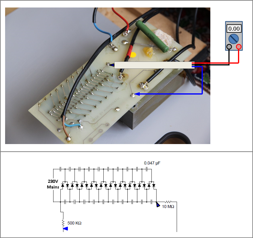

I couldn't find schematics of the ESH100 instead I found one of the ESH50 (picture). I also supplied several pictures of the inside and the electronics of the ESH100.

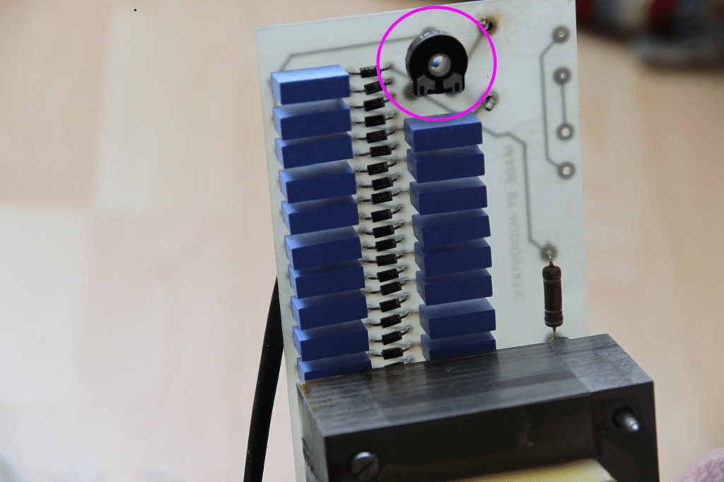

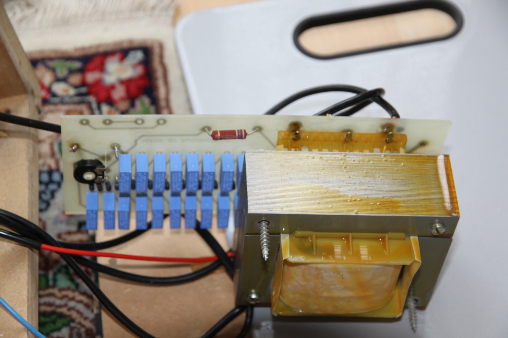

The transformer in picture 2 is the only one in this speaker.

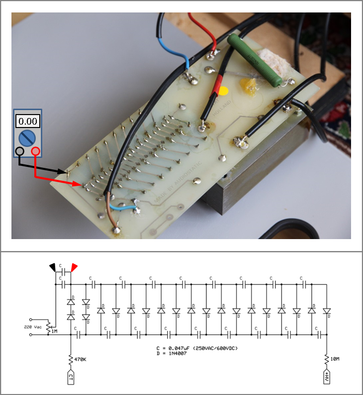

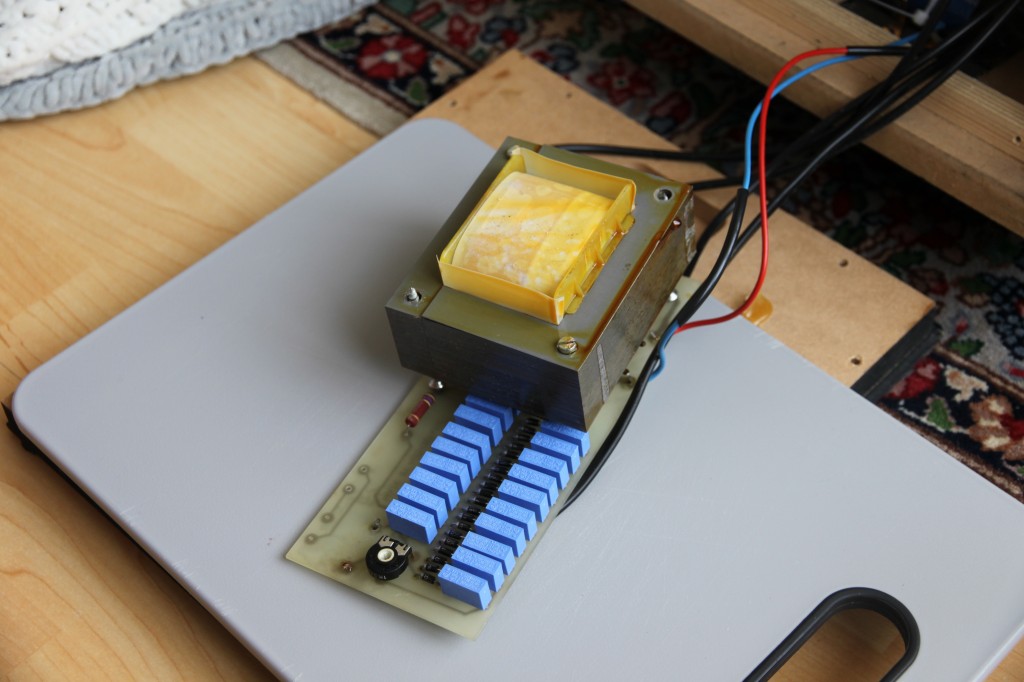

Brown and blue wire at the left in picture 3 is 220V power.
Black wire with red tape in pic 3 is hv to foil.

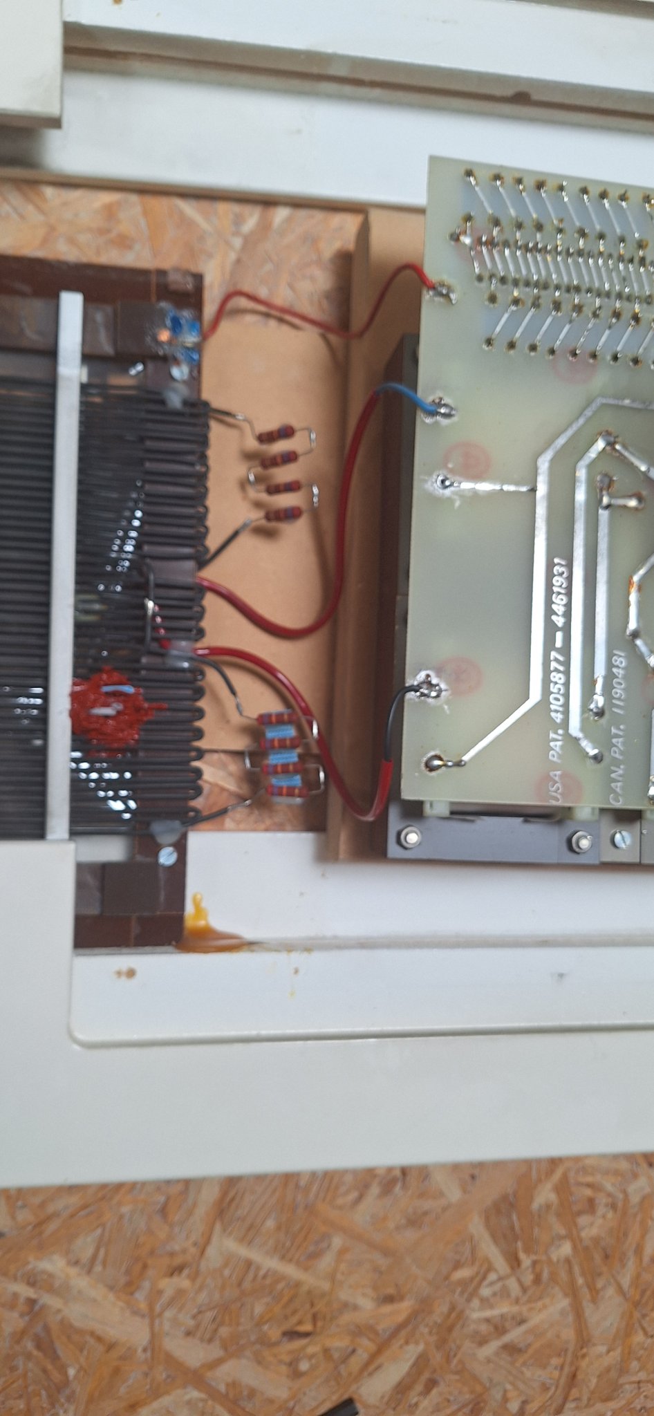

Blue and red wire in this picture (top right) are connected to woofer filter.

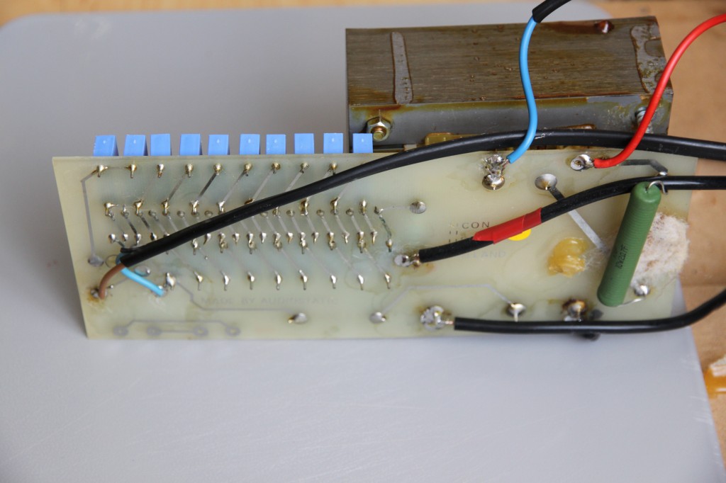

The two black wires at the bottom of the pcb are connected to the stators. In the last picture it is easier to see that there are two black wires.
My question: to prevent doing something stupid I would like to know how and where to measure bias. For instance where to attach the ground clip of my hv probe ? Should I measure with or without connected esl panel ?

Thanks for the ESH-100 pics.
Attached is a drawing showing where to connect your ground clip and place your HV probe tip. For safety, unplug the mains power before connecting or disconnecting the ground clip. I would measure each supply with the panel disconnected and with it connected. So 4 measurements in total. This should help isolate if the SPL difference is due to the power supply, due to leakage in the panel loading down the supply, or due to failing coating or coating contact.
Bolserst thank you very much. Your drawing made it very clear to me. I still remember your drawings when you helped me out with my malfunctioning Quad ESL's a few years back . It was a great help to me then.
I will report my measurements here !

@bolserst, I did the measurements as you advised.
Because I'm somewhat scared of the high voltages involved
I put on rubber gloves.🙂
....................panel_connected panel_disconnected
Right speaker..........-4.2 kV.............-4.2 kV
Left speaker............-3.0 kV.............-3.0 kV
No difference between connected or disconnected panels but rather serious
difference in bias level between left and right.
Afaik the bias voltage of the Audiostatics should be about 5kV.
As I have learned that these measurements are just indicative I suppose
the right speaker is more or less correctly biased ????
Therefore I upped the bias of the left one. This made the left speaker way louder.
At the moment I think case closed.

Glad to hear you got the levels balanced out.

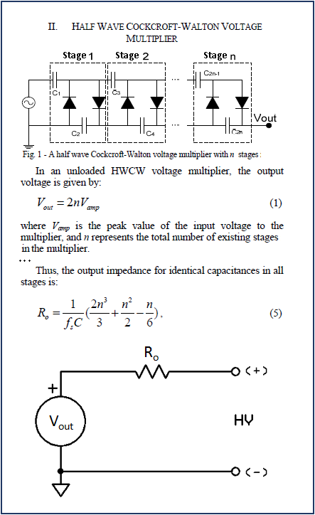

Yes, 4.2kV is roughly the correct value to read with a 1000Meg probe to indicate roughly +5kV when not loaded down by the probe. I meant to mention this, but forgot. The source impedance of the multiplier can be estimated fairly well with a simply formula based on the capacitor size, number of multiplier sections, and frequency of the AC input voltage. With 0.047uF caps, 50Hz AC, and 9 multiplier sections, the approximate source resistance is 223Meg. So if you measured 4.2kV with your 1000Meg probe, the unloaded output voltage would be:
Vout = Vmeasured * (223+1000)/1000 = 4.2*(223+1000)/1000 = 5.1kV
Another way to go about assessing the unloaded HV output, is to measure the voltage across the first capacitor in the multiplier string and then multiply that value by 18(2*number of sections) to get the theoretical final unloads output voltage. You should measure something in the range of 280-300VDC across the first capacitor. (See attached pic)
