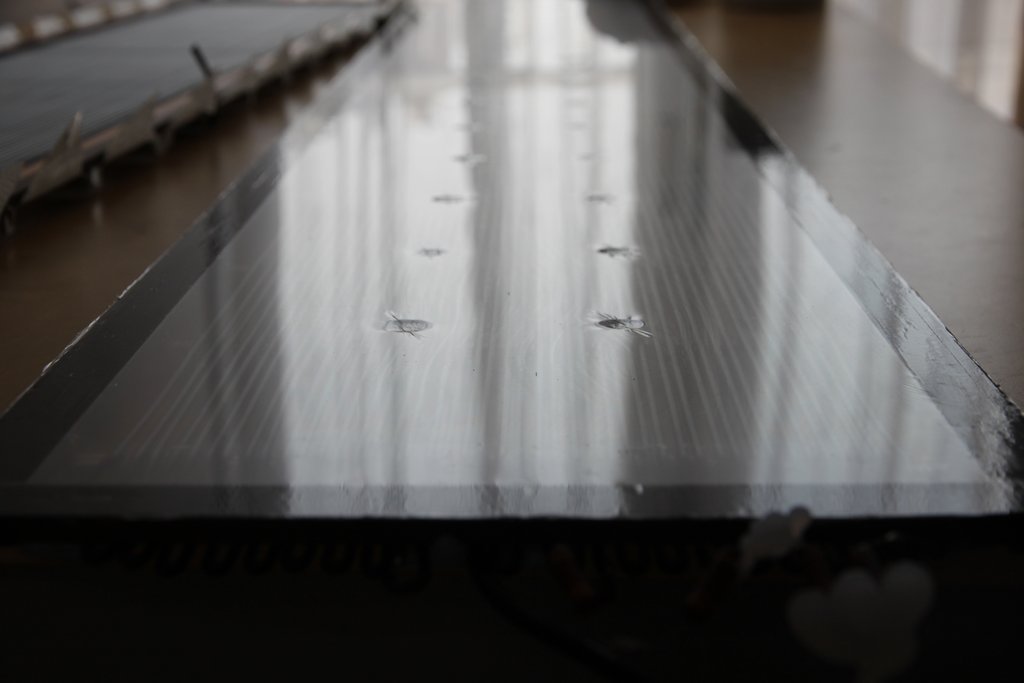

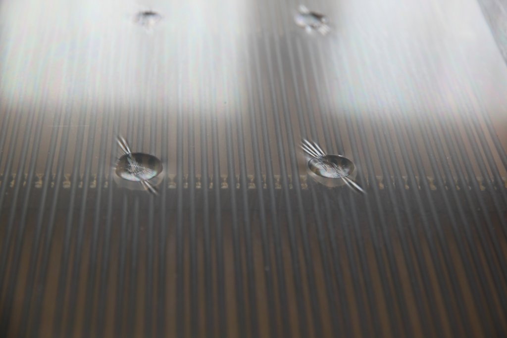

Recently I rebuild a pair of Audiostatics ESH100. An almost full range electrostatic with integrated bass reflex for the lowest octave.
Listening to the end result I noticed that one of the ESL's had a lower output and that when playing louder distortion is occurring sooner than on the other one.
To stabilize the diaphragm Audiostatics applied silicon dots between the wire stator and the diaphragm. Upon inspection it turned out that on the low output speaker the silicone dots were much bigger than on the other one. And what's more it looks like the dots are sucking the diaphragm closer to one side of the stator. The pictures are showing clearly that the silicon sealant is producing dents in the diaphragm. In my opinion caused by shrinking of the sealant.
I would appreciate to get some help about alternatives, like advice about non shrinking (clear) silicon kit or paste, the use of double sided foam tape or perhaps the use of kneadable rubber/putty.

The diaphragm distortion in your pictures looks relatively small and localized. It seems like a low percentage of diaphragm area and a low percentage of spacing, so I would expect the impact to be minimal.
From the reflections, it looks like the diaphragm is mostly flat. Is there something that's not showing up in the picture? Would a straightedge place on the diaphragm show it better? Can you estimate the offset as a percentage of diaphragm-to-stator spacing? And estimate the percentage of diaphragm affected?
Unless there's something I'm not seeing, I wouldn't expect the problem you're describing from minor diaphragm issues.
Did you swap the electrostatic panels between the interfaces to make sure something else isn't causing the problem? Have you confirmed that you are getting full bias voltage on your diaphragms (or if you can't measure voltages that high, that diaphragm resistance is consistent and has a good connection)?

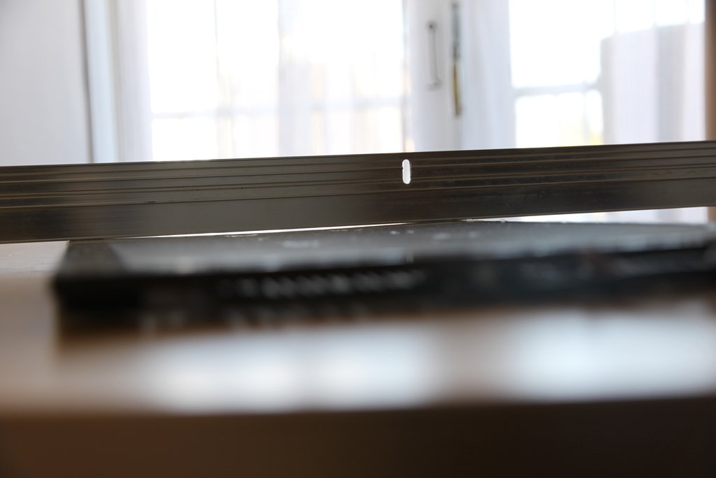

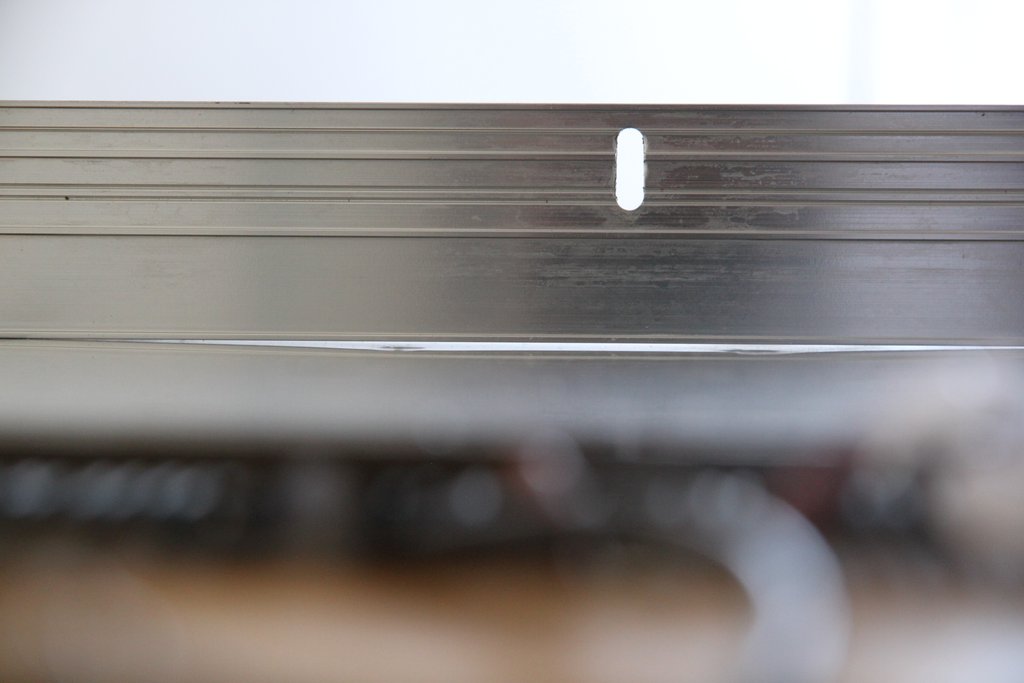

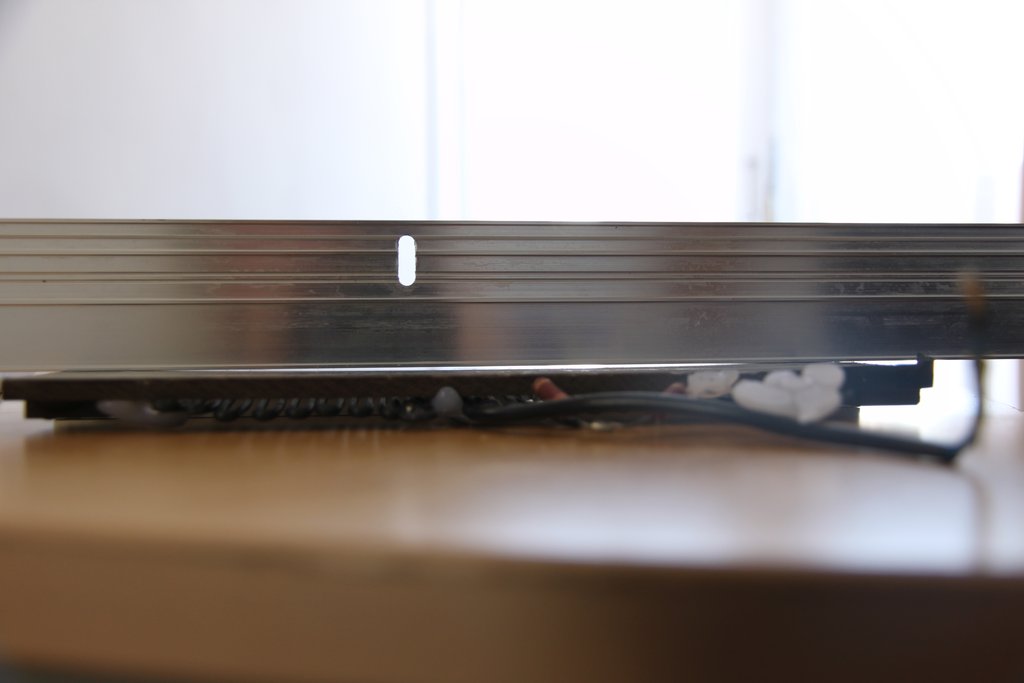

mattstat, I added some pictures to give you a better idea of the rate of deflection of the diaphragm. In the middle of the diaphragm there is a dent of about 0,5 mm. This is from top to bottom and not only in the vicinity of the silicon kit. The stator to diaphragm distance is about 3,5 mm. I think the deflection is caused by the sucking force of the kit. I have no idea if this deflection is contributing to distortion and lower output of this speaker. (see pictures)

Thanks for the extra pictures. They really help show the diaphragm displacement.
Without the speakers in front of me I'm guessing a bit, but even that amount of displacement doesn't seem like it should cause major problems as long as everything else is right. The panel resonance may have shifted some, which can change the sound, but that doesn't explain noticeably different distortion or sensitivity. If you have an old analog signal generator, you can sweep through the bass range with a sine wave and identify the resonances to see if there are major differences between the panels. It will also highlight tendencies for the diaphragm to rattle. You don't need much voltage to do this. A few volts RMS from the amplifier is usually sufficient.

You won't normally see any diaphragm or coating holes from brief overdriving or minor arcing. It typically takes a while or an extreme event to do that kind of damage.
If your stator insulation is intact, you won't typically get a significant arc either, so won't do any damage even if there's periodic popping/ticking/crackling. During an overvoltage event, most of the voltage is dissipated through the insulation instead of in the gap, so arcing isn't as much of an issue in a proper insulated design. They still have limitations on total voltage across their gaps though, so overdriving them will lead to distortion or popping/ticking.
If you suspect that your insulation has issues, one thing you can do is play at high levels in the dark and carefully inspect the ESL panel for any signs of corona or arcing.
Under dynamic conditions at moderate drive levels, the areas close to the dents will likely be of limited concern because diaphragm motion will be limited by the physical connection to the dots and you probably won't be near air's breakdown limits even at the locally reduced spacing.
If you have ticking/popping with no music playing, I would lean toward the reduced spacing in those areas not being able to handle the full bias voltage.
If the ticking/popping you described is happening at very high drive levels, the areas of reduced spacing could be the limiting factor for ultimate output as it is since 1 mm is a more significant portion of the intended spacing, and something has to give eventually if you're pushing up to the limits of the panel.

Last but not least the displacement of the diaphragm. Your remarks and my OCD are telling me that a fresh foil is required. Because I think it's impossible to loosen the diaphragm from the dots and inject additional kit underneath. Remaining question is what about the dots ??? I'm reluctant to use (shrinking) silicon dots again.
