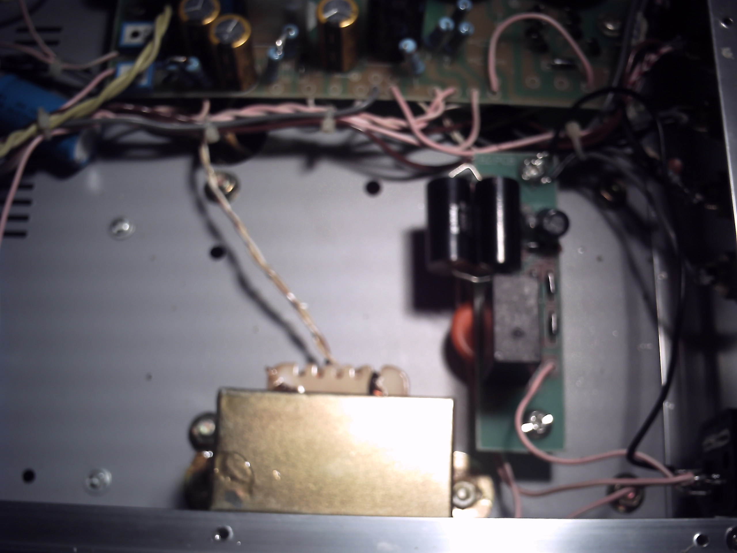

Hello Tony,
I have repaired my Audioromy 813 several times. I think the 838 is not a lot different.
So let me try to help you. If you turn on the amp with no loudspeakers attached. Is it a humm or more a rattle that you hear. Because often a small capacitor who is buffering the supply of the on/off relay is defect. If you hear the relais rattle, then the capacitor is defect.
Please make a photo of the inside of the amp i can point out the place of the capacitor.
Picture from 813 amp
Ronny

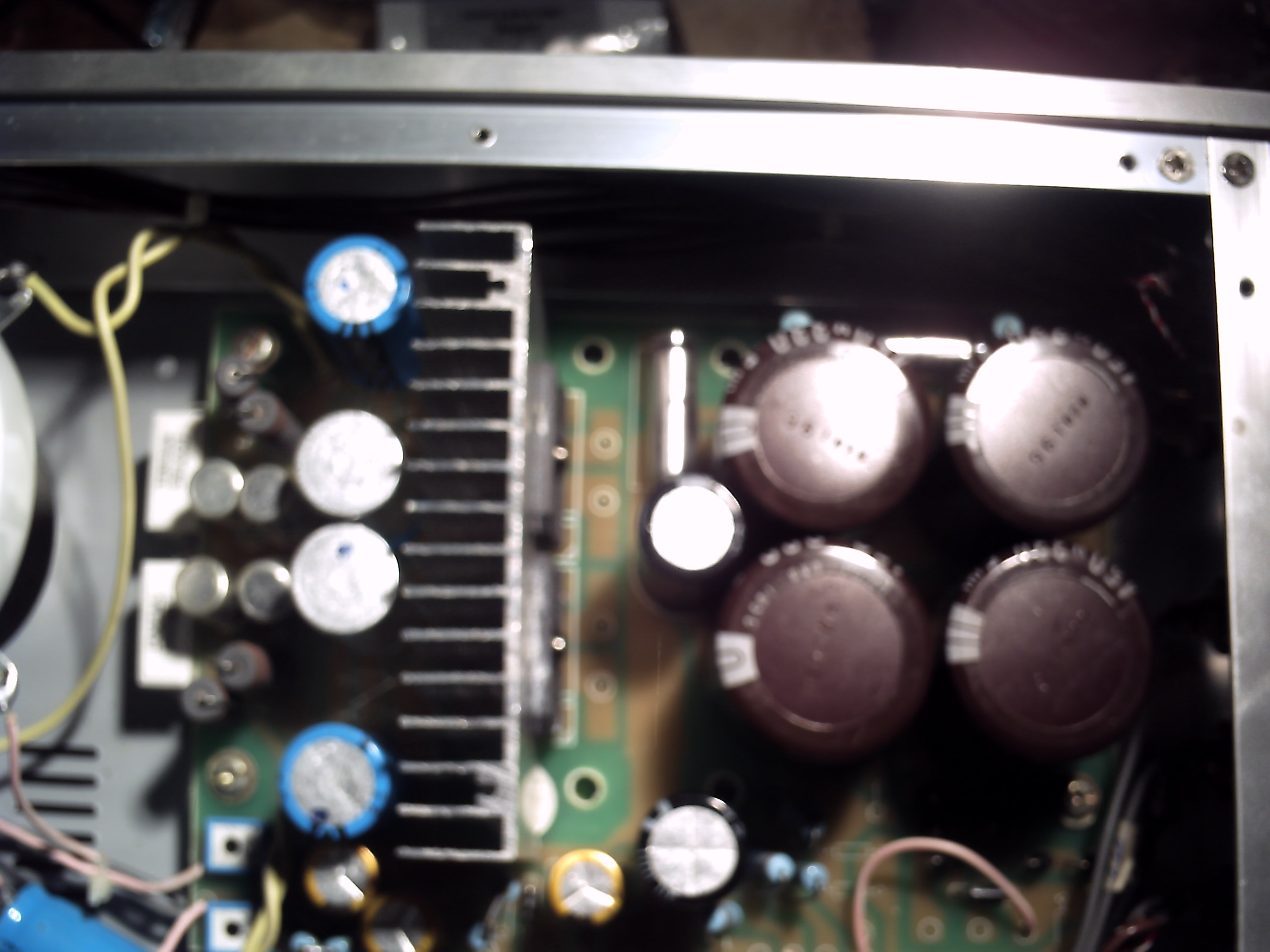

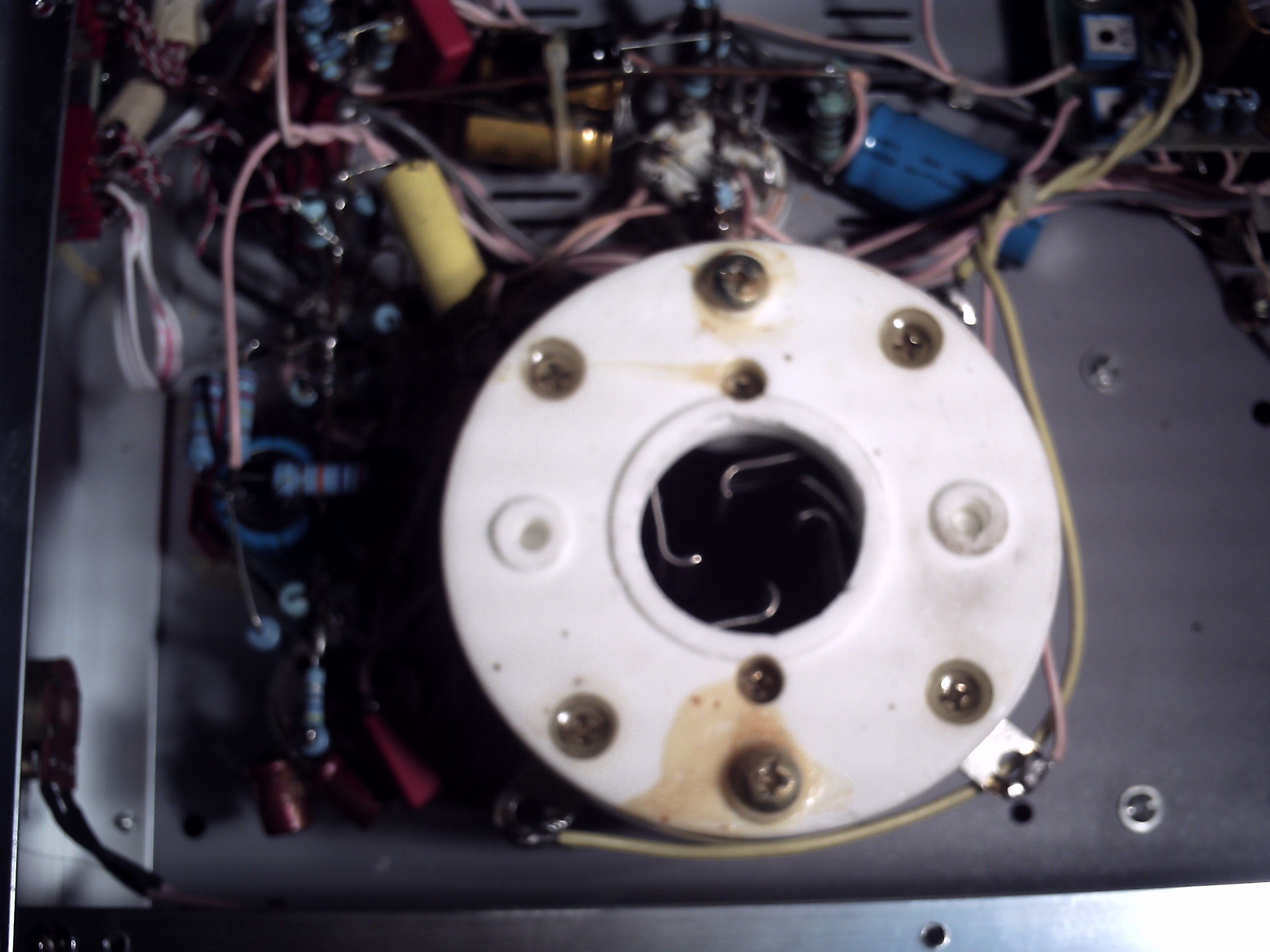

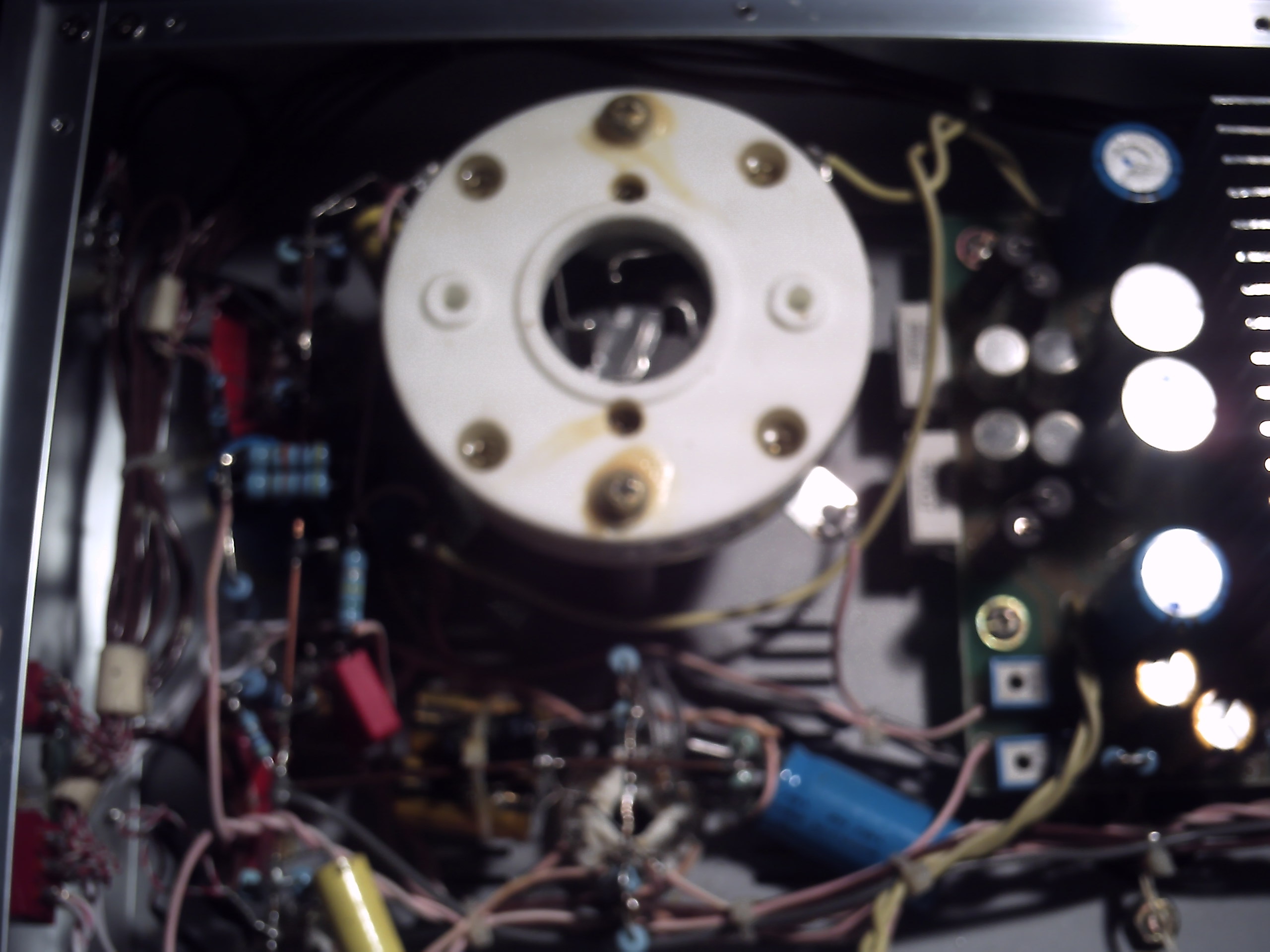

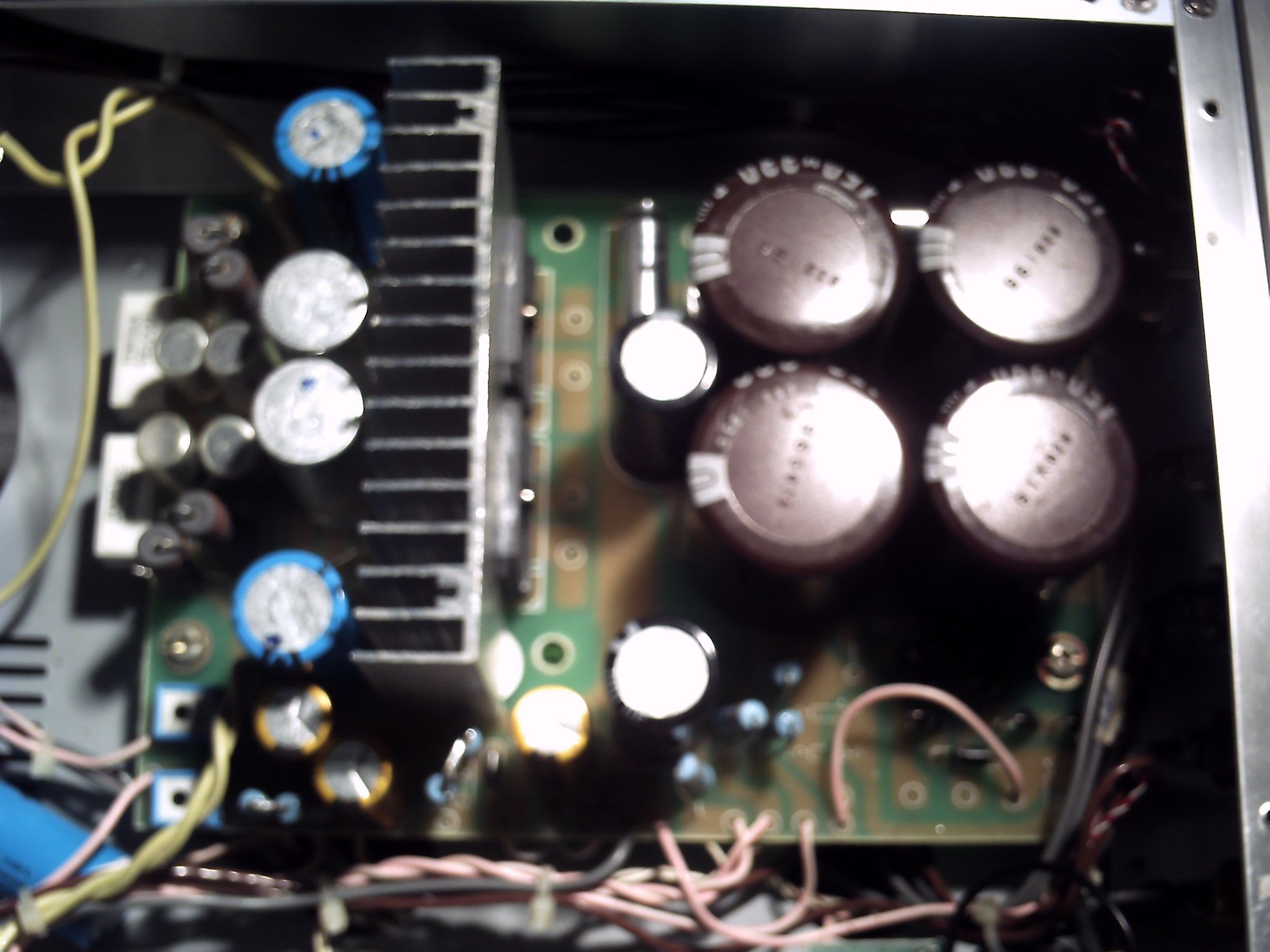

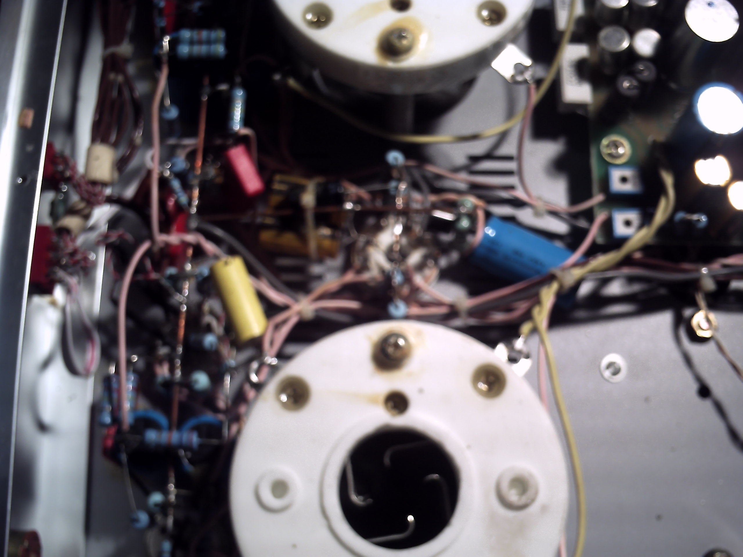

Ronny, here are the pics. Cap issue would be easier for sure! Let me know if you can ID the cap and I'll change it out.
Turned it back on with out tubes and no speakers. There is a hum and crackling, hissing sound from around the little power supply board.
Thanks for the assist...
