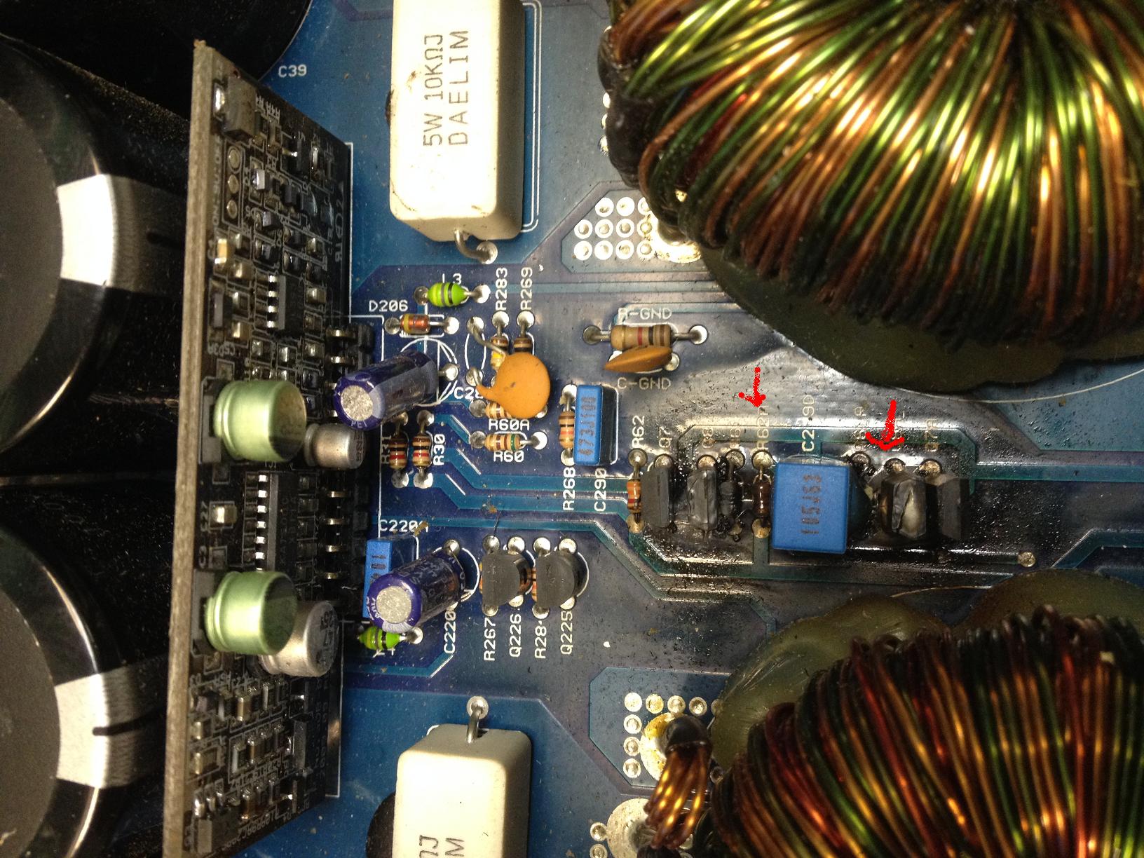

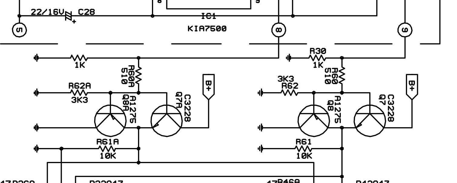

Replaced all the power supply fets gate resistors drivers and resistors near the drivers..
Also replced all of the outputs..
Amp powers up and idle's perfectly..
As soon as i plug the RCA jacks into the amp i can watch the current draw increase quite a bit ..
It idle's at about 2 amps but as soon as i plug the rca jacks in in the idle current goes up to about 6 amps..
Any ideas on where to start looking?
Is this with or without a speaker/load?
Does it produce audio?
Does the r-r waveform change when you plug the RCAs in?
Do you see any difference in the output when you plug the RCAs in?
Ok i forgot i had the RCA'S plugged into my sine wave generator..
When hooked up to a Head unit the amp still idles fine with rca's pluuged in
