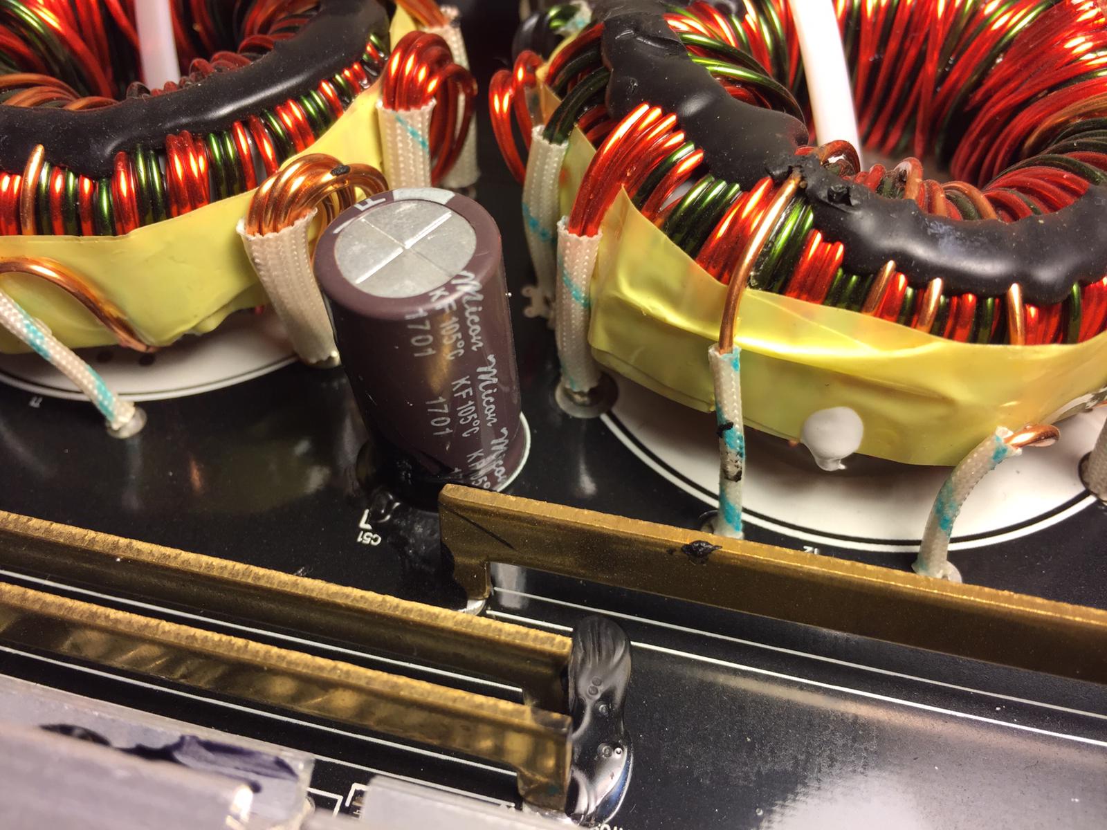

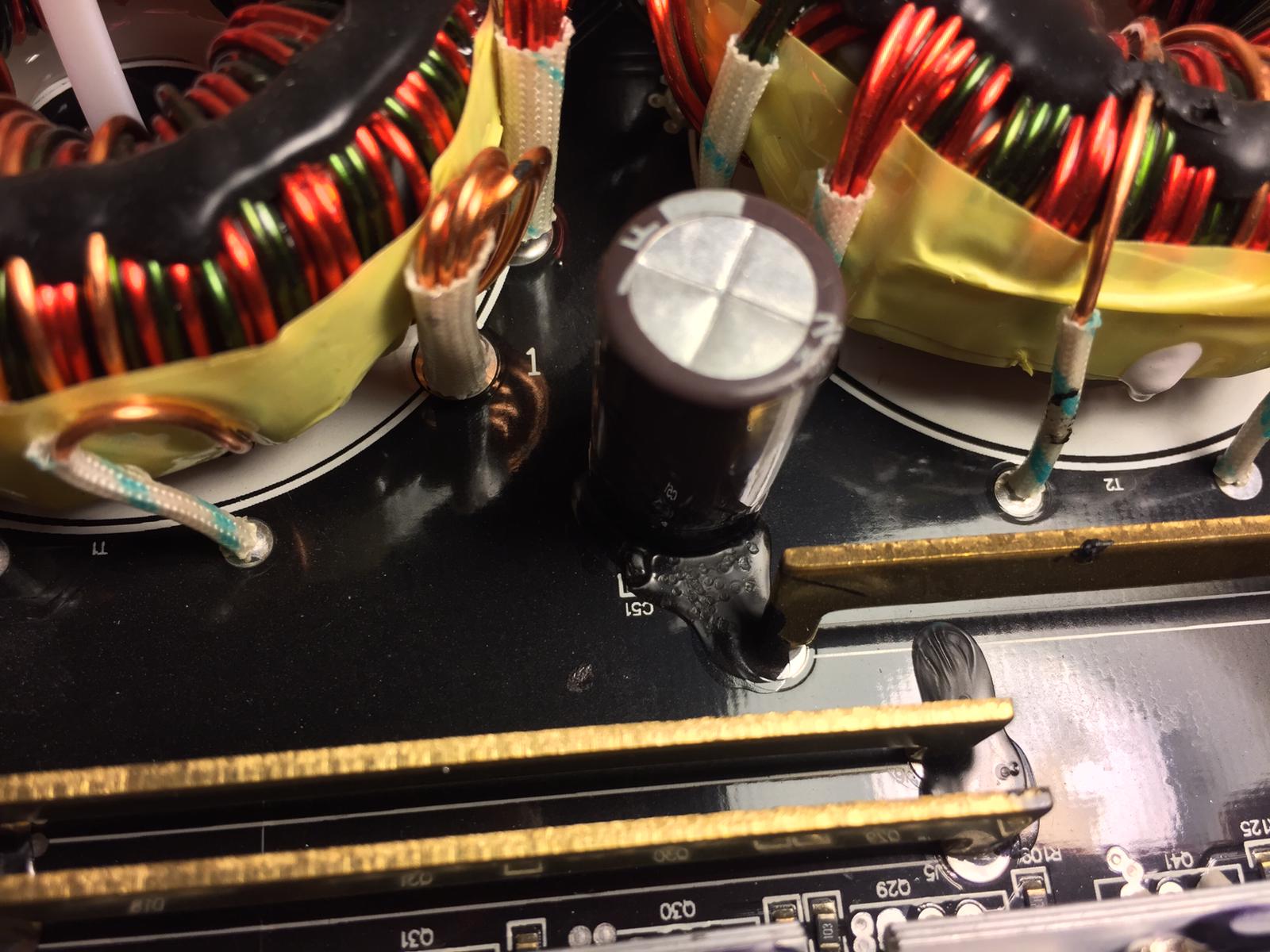

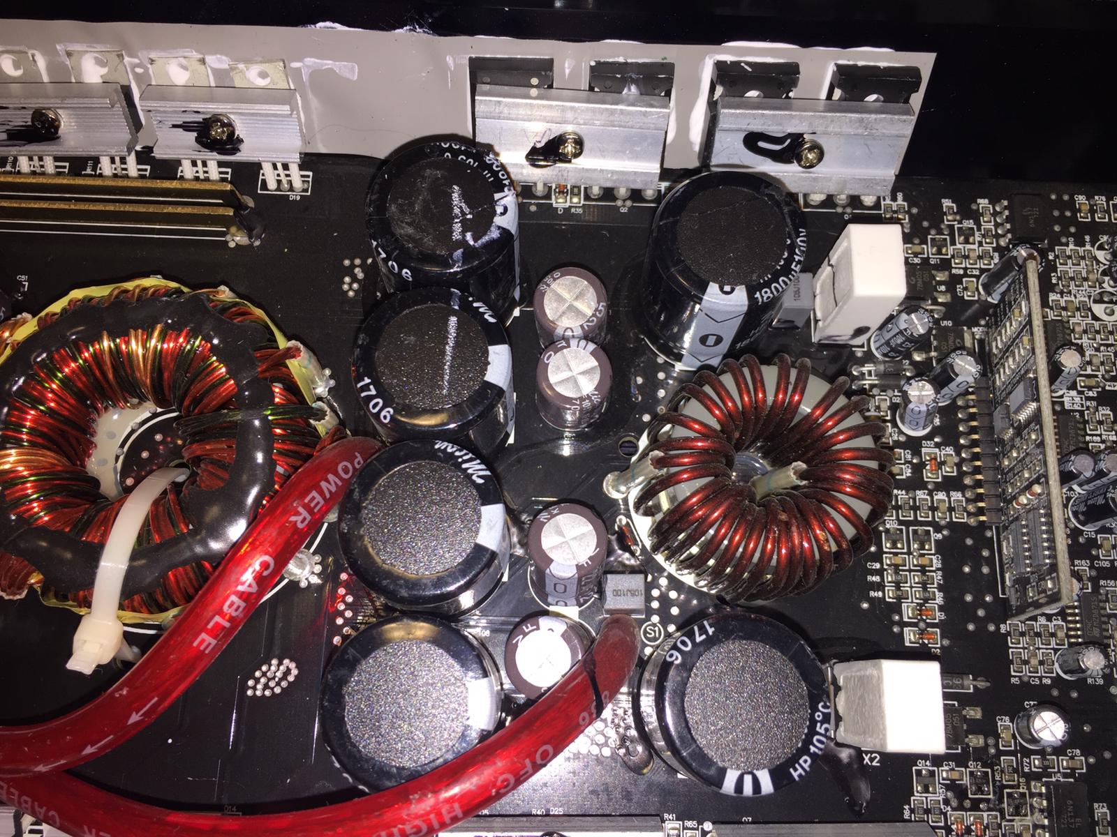

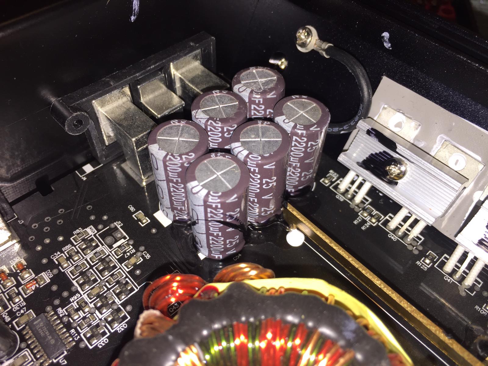

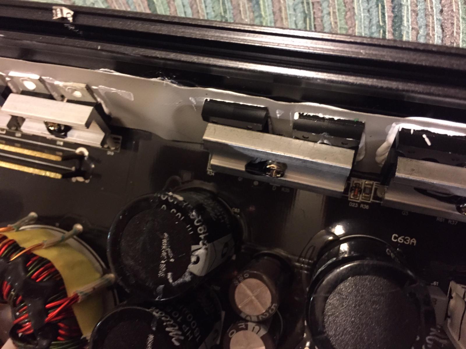

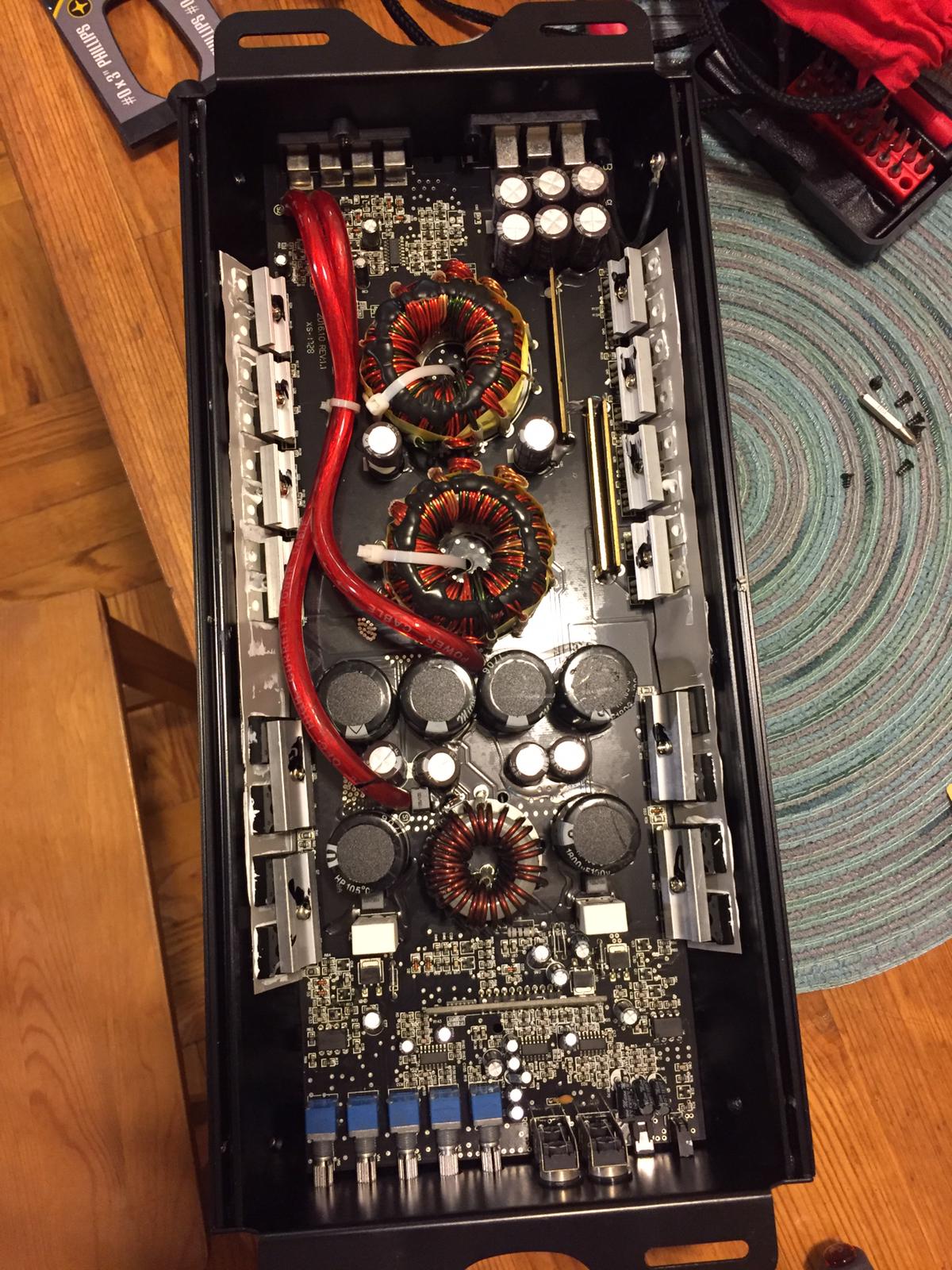

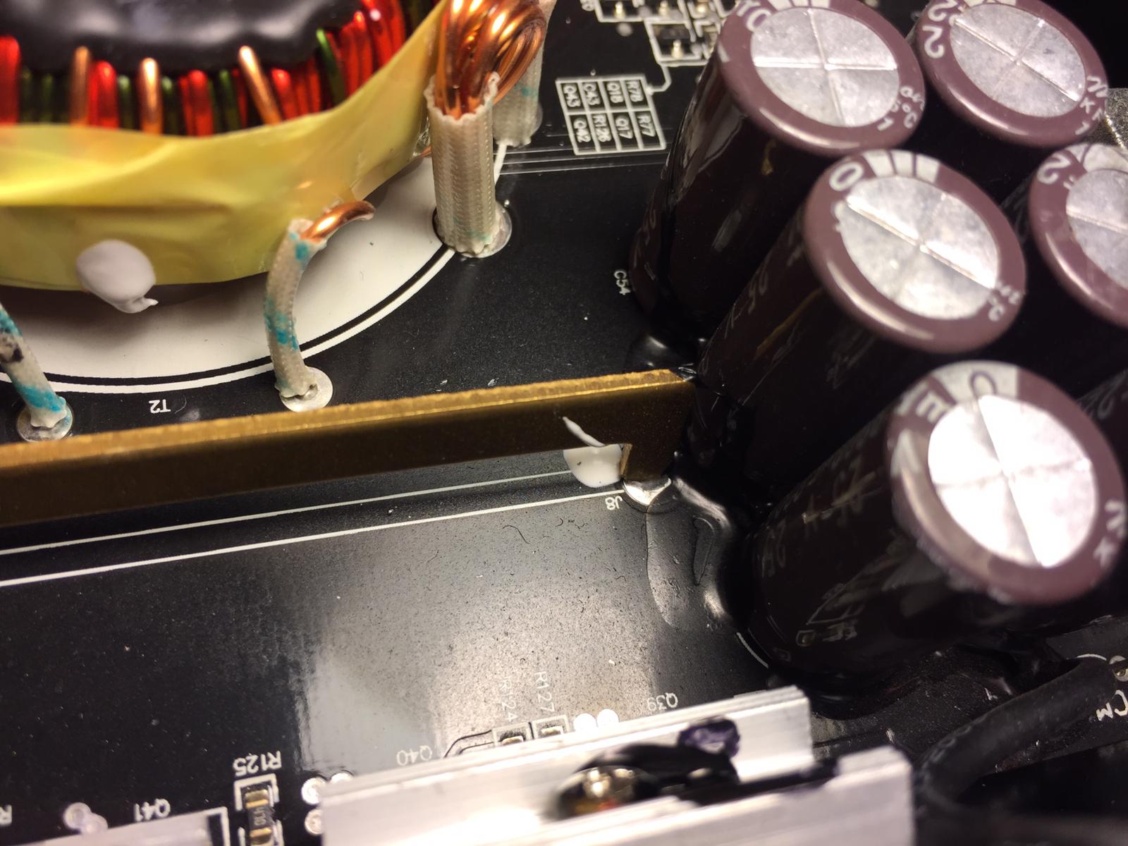

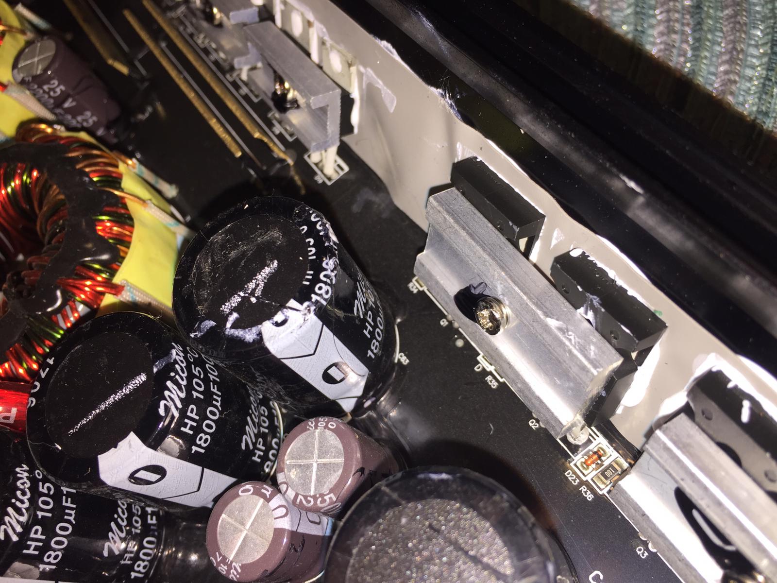

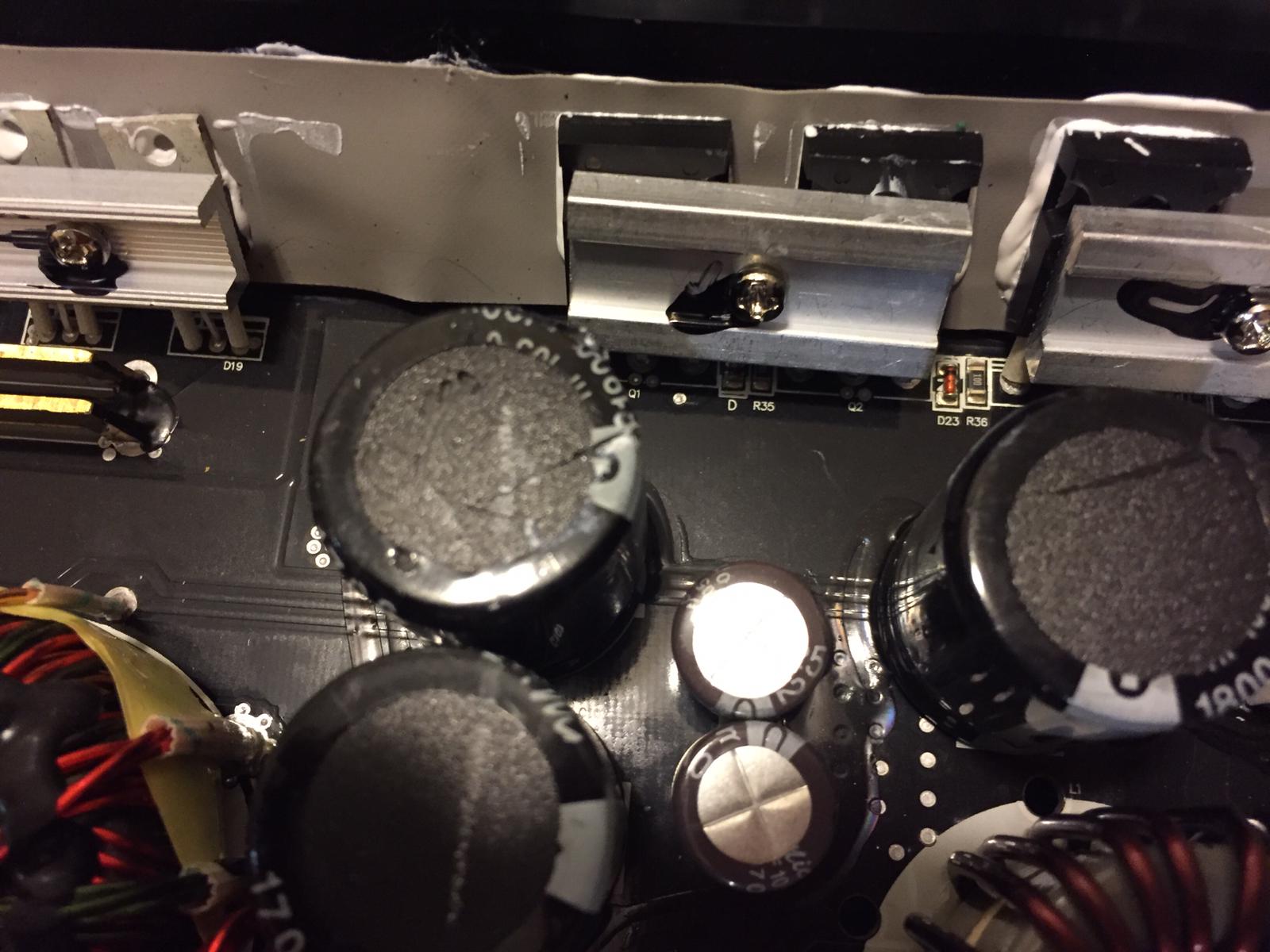

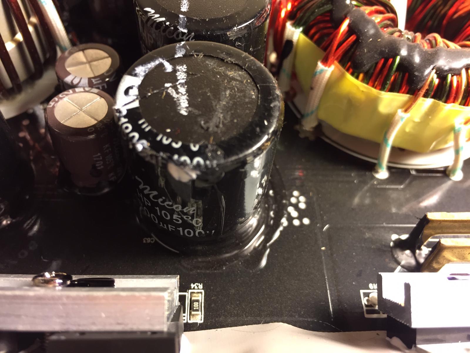

i'm a noob at car audio. i got an audiopiple AP-15001D and its sounds amazing but its draining my car battery when everything is turned off. the amp is drawing 200mA when nothing is turned on. this drains my car battery within a week. i didn't see the problem at first because i was using the car daily and that hid this problem. any idea on what i could do to fix this issue? is it worth looking into?
thanks for any help.

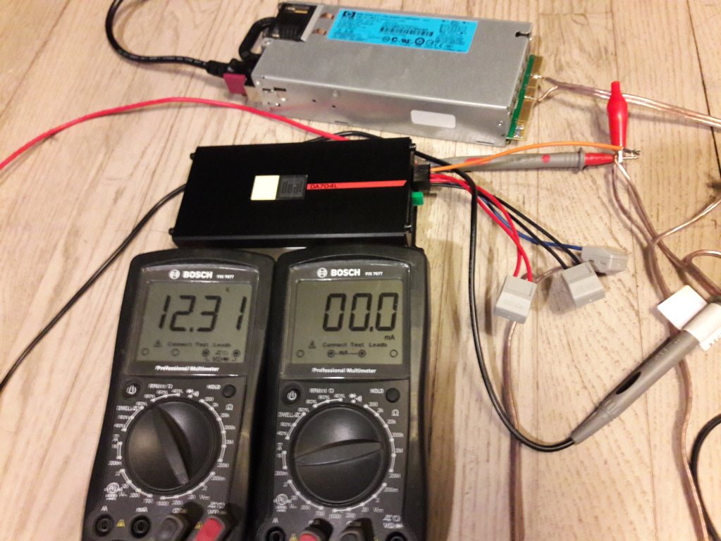

I got a 250 watt computer power supply and did a current draw test when the amp is turned off and no remote line going to it. its drawing 18.7 mA. this is interesting because when I did the same test on the car with the car battery I was getting 200 mA - not sure if something is going on with the power cable to the amp. i'm going to do a test and see any current is drawn when nothing is connected to the power cable.

Hey, Nice Pics of your Amp Guts! but your caps look a little beaten up.

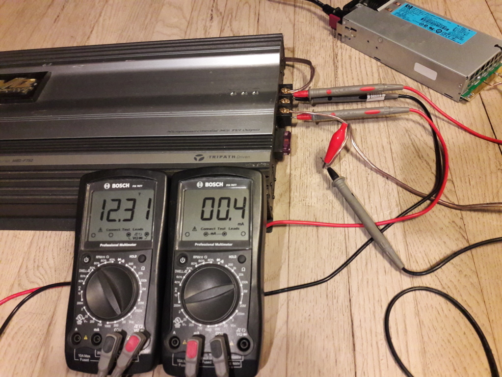

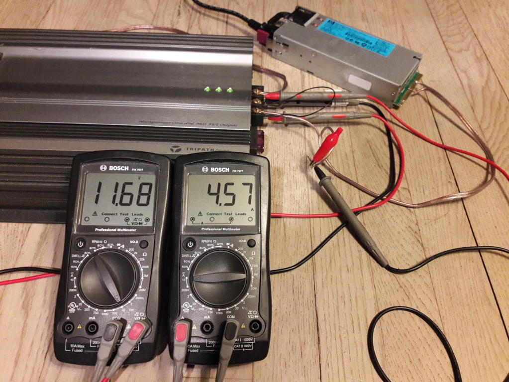

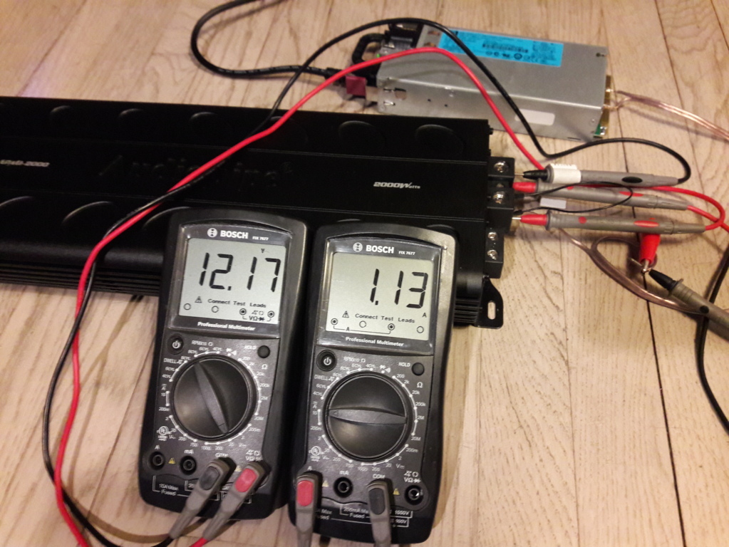

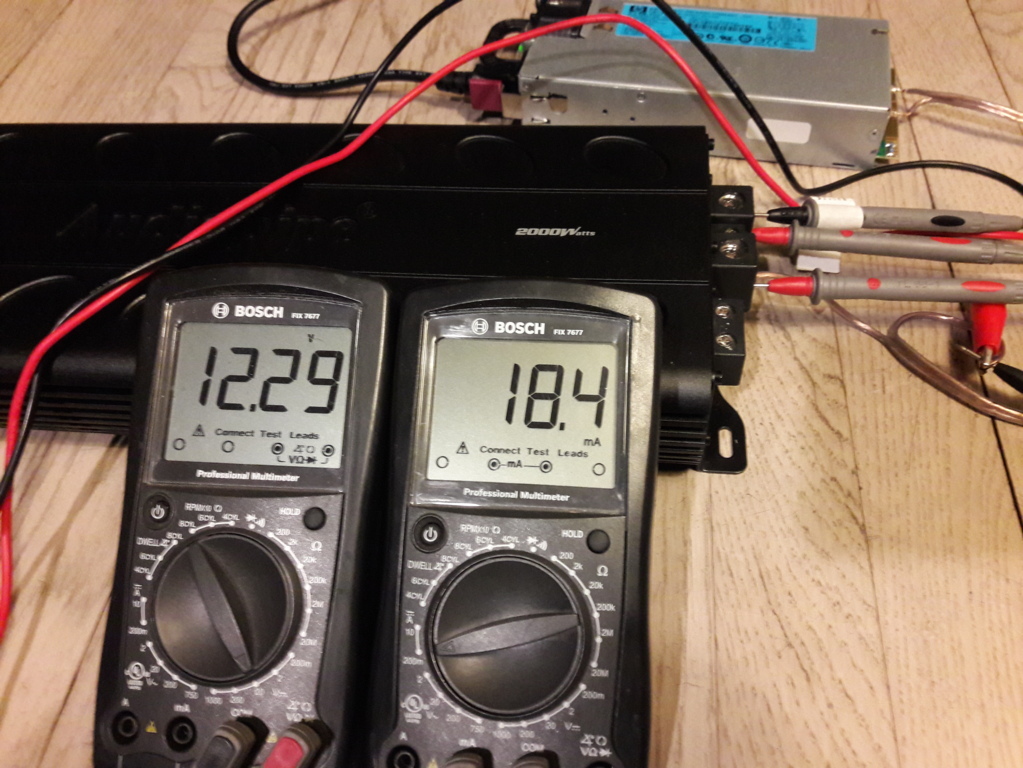

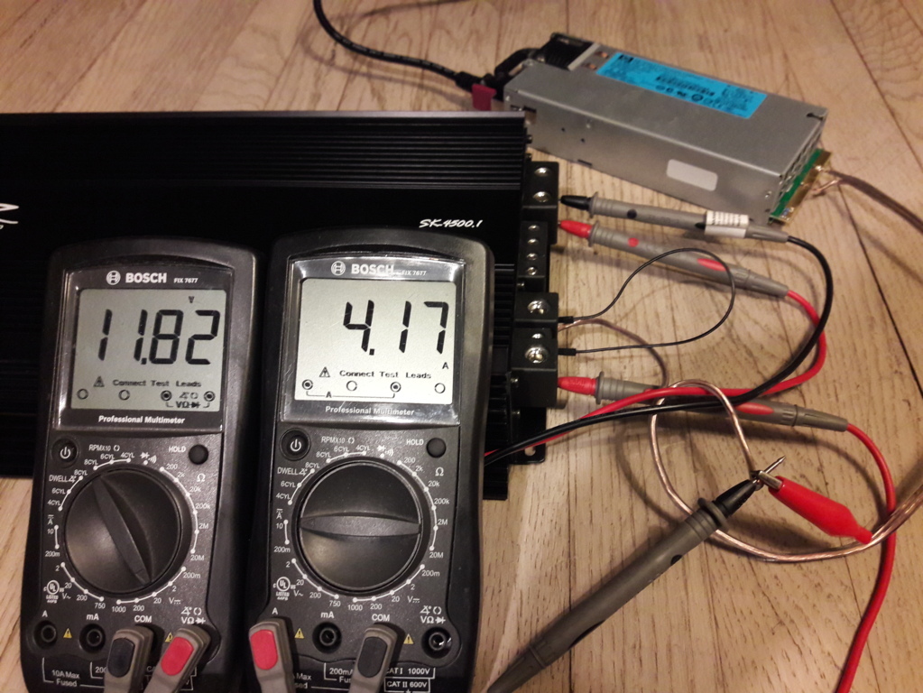

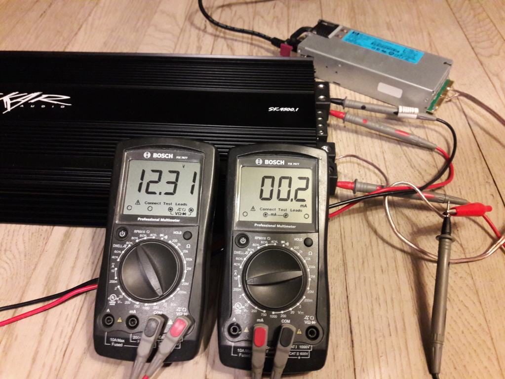

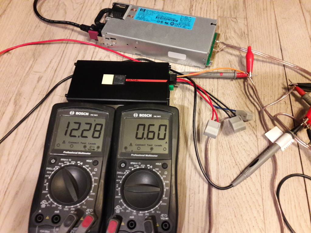

It seems it could be these Audio pipe Amplifiers are putting the total parasitic drain on the car battery over the top. I've retested my Amps using the same power supply and meter setup for a side by side comparison.
The results are as follows....
Skar SK4500.1D Powered ON: 4.17A Powered Off: 0.2mA
Alpine MRD-F752 Powered ON: 4.57A Powered Off: 0.4mA
Dual DA704L Powered ON: 0.60A Powered Off: 0.0mA
AudioPipe APMI-2000 Powered ON: 1.13A Powered Off: 18.4mA
I've Attached Images of the metered results.
The parasitic current draw on the Audio pipe is magnitudes greater than all the other amps. Interestingly the amp is pretty efficient when running and puts out plenty of power.
I think a disconnect solenoid relay may be necessary for this Audio pipe amp for a non daily driver.
I already have a manual 150A/300A breakers in my system to disconnect my setup from the car's electrical as well as a way to isolate the second battery bank. I'll have to use those until i install solenoid for myself. I don't want to be stranded.
I hope some guys will post their Amp's parasitic draw results so I can compare. Its Hard to believe this could be in all Audio Pipe Amps.

Do you see 12v on pin 12 and 5v on pin 14 of the 494 driver IC?
Many MTX amps have B+ on the control ICs with no remote applied so they have a small amount of current draw when off. I think I measure one at about 6ma.
