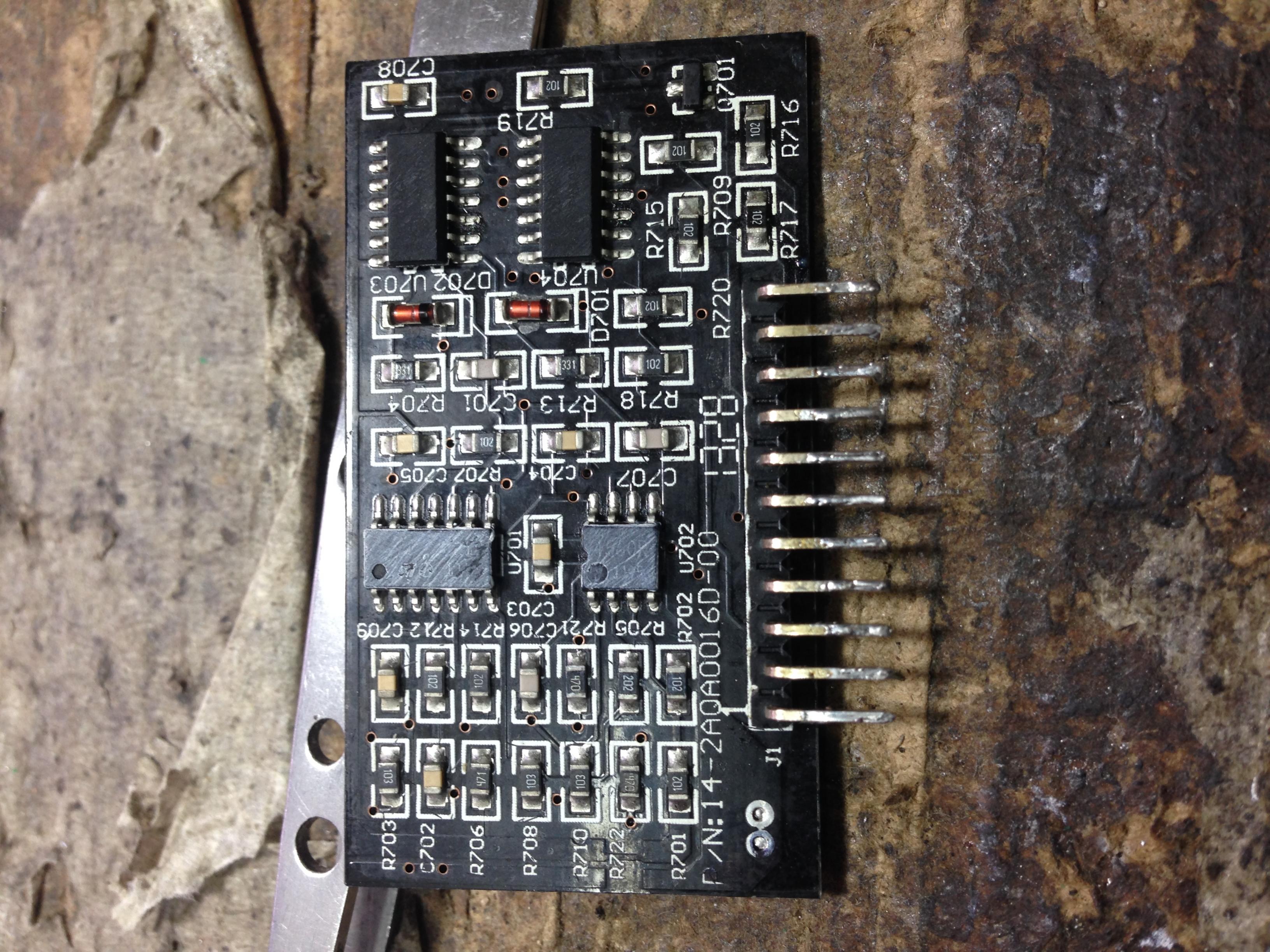

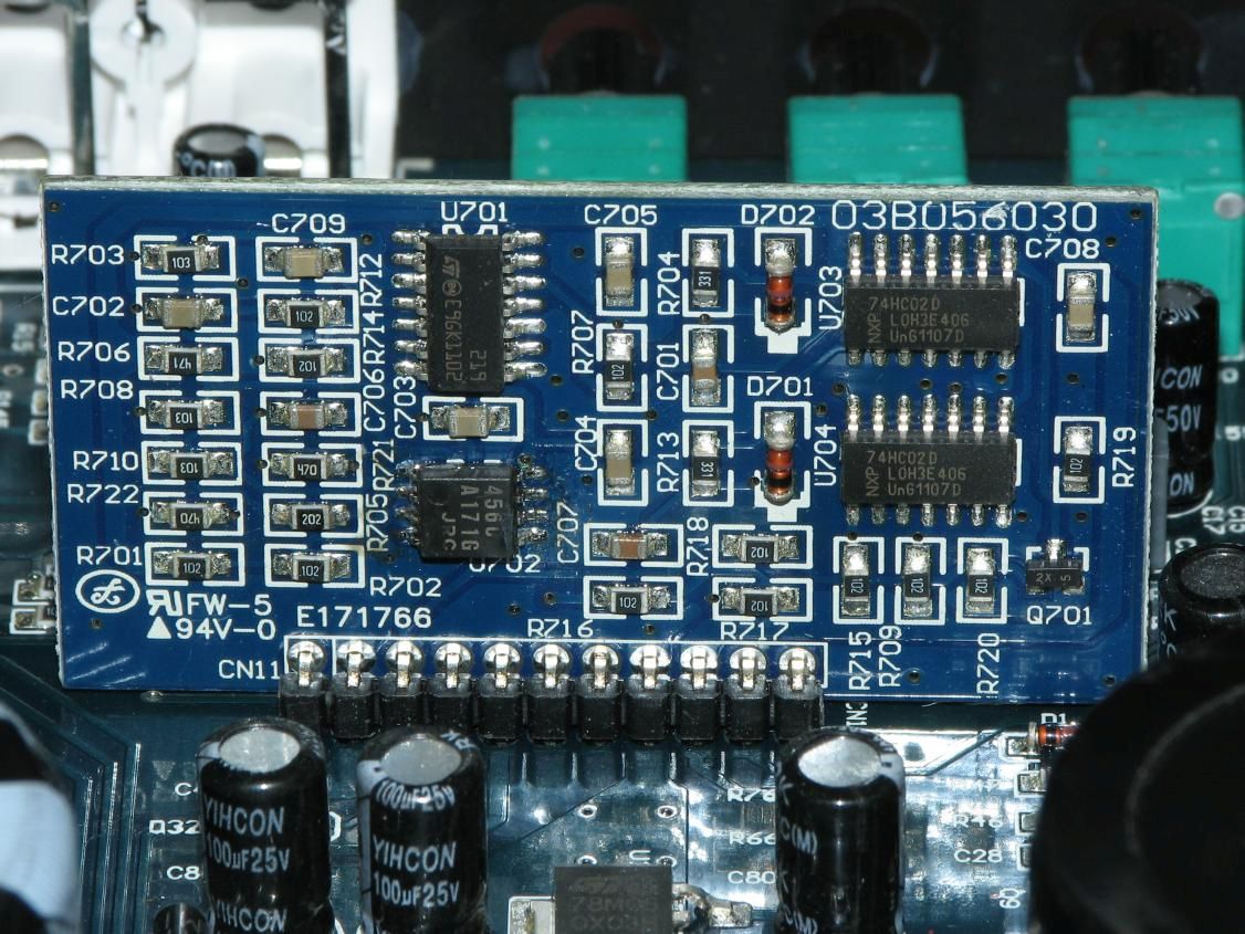

Does anyone knows the part number for the 4 sand off IC's on the driver board for this Audiopipe amplifier?

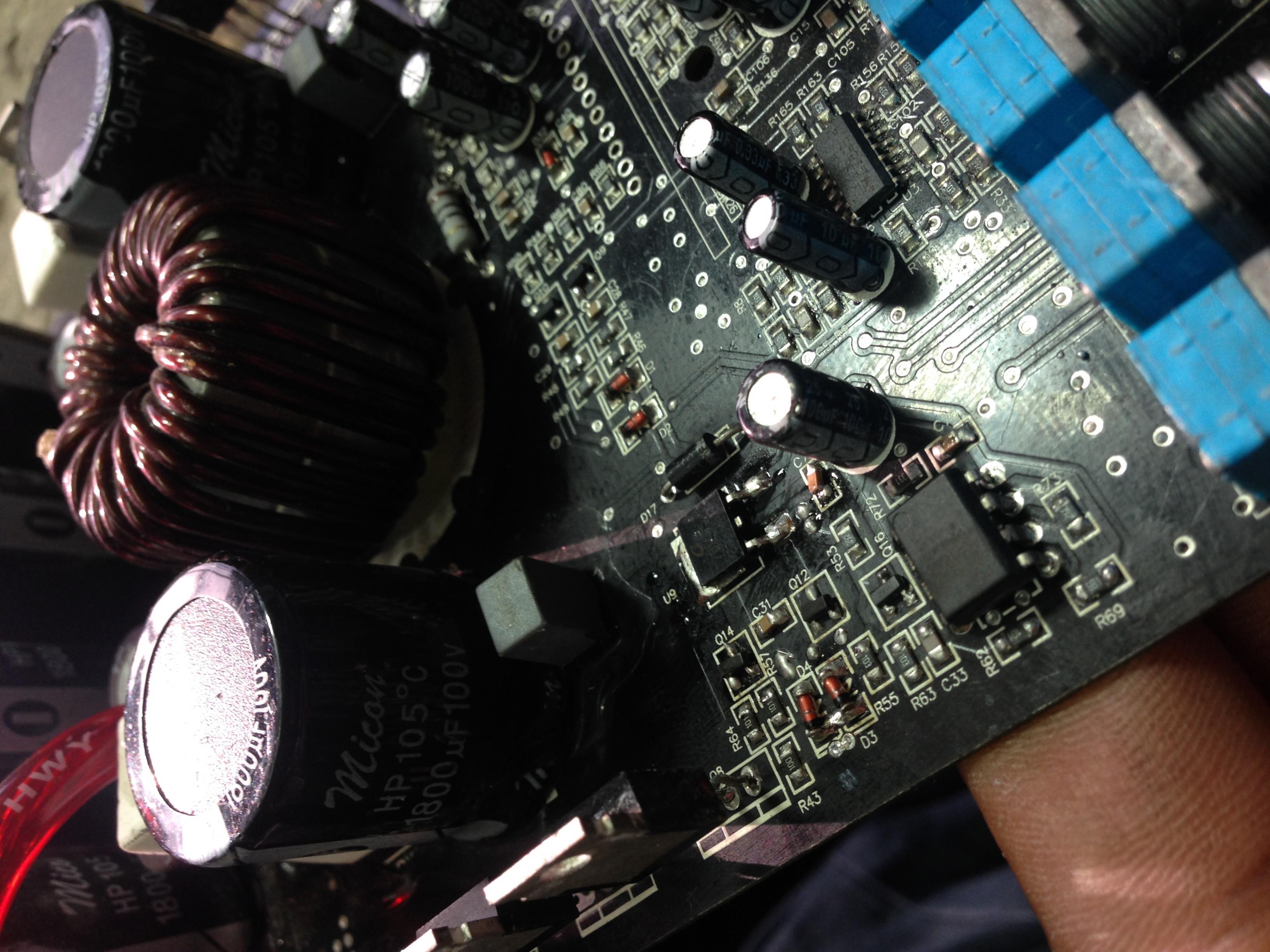

In this particular amp, im having DC voltage on the output of this amp. The four IRF640 behind the rotary controls (not the input jack side) is getting hot.
Ive removed the riser board and ive checked all the components that drives the gate signals for the output fets.
Ill post up a pic of the amp shortly.
This is the side that's getting hot, I've checked all the components that drives these fets but I haven't find anything with any significant irregularity that's causing it, any ideas anyone?

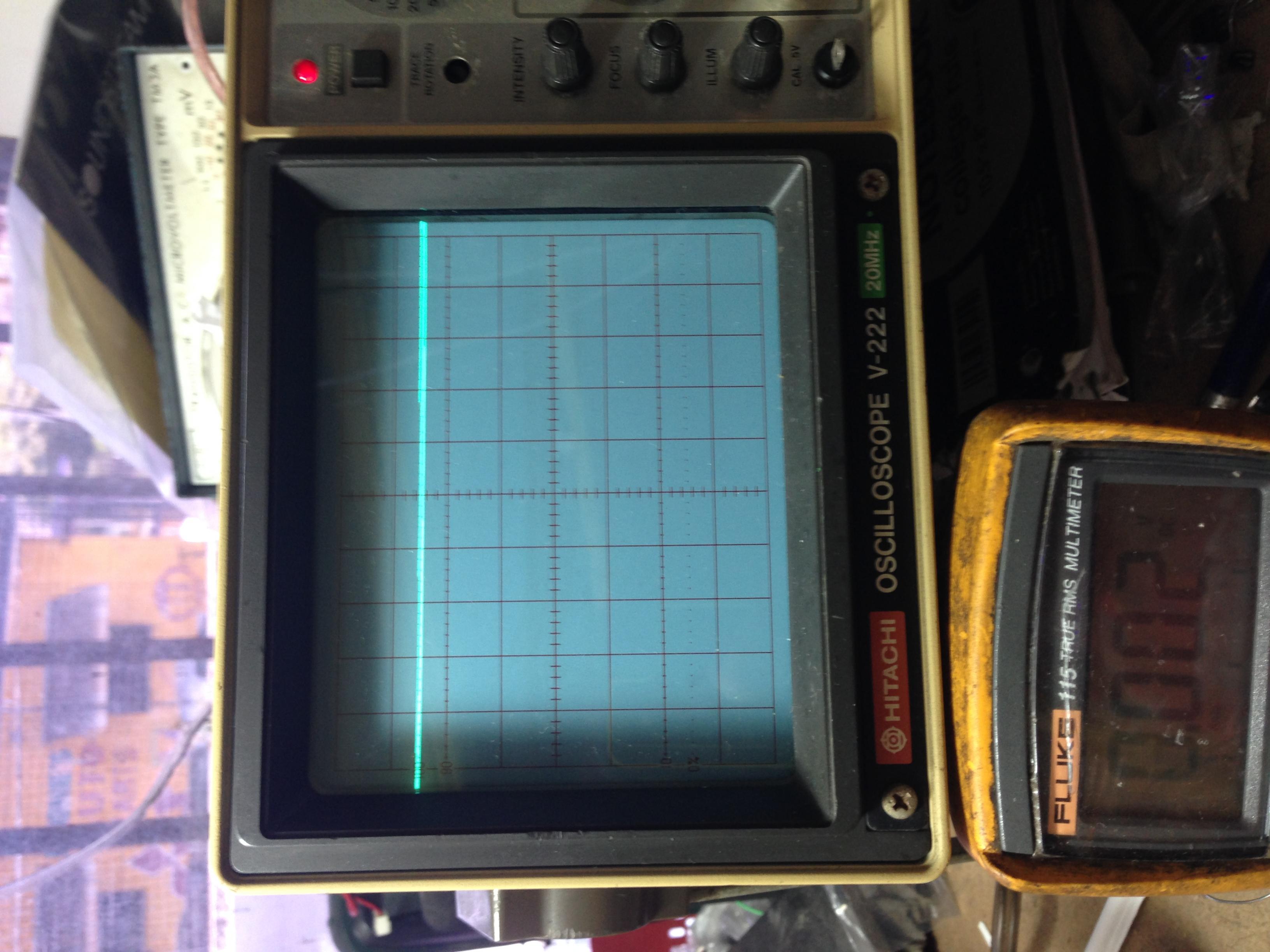

Remove the rectifiers (AFTER discharging the rail caps). Then you can check the drive signals on the FETs. Without the rectifiers, you can connect your scope ground to the source legs of the FETs and see the signal clearly with the FETs in the circuit. If there is any problem with the drive signal, it should be obvious.

I'm not getting a signal; I'm getting 12.22 volts on the gate and one of the IRF640 from the same bank was overheating rapidly. I've removed it and the remaining three is at room temperature. Is there any other checks I should make?
The scope setting was T/D 1 ms and V/D 5v.

The driver board hasn't been repaired before its only been removed and reinsert on the main board. There's no solder blob or any short.

Sometimes you can get tiny strands of solder (especially with chipquik) between the pins on the driver board when it's being removed. You can check with a meter to see if you have shorted pins.
