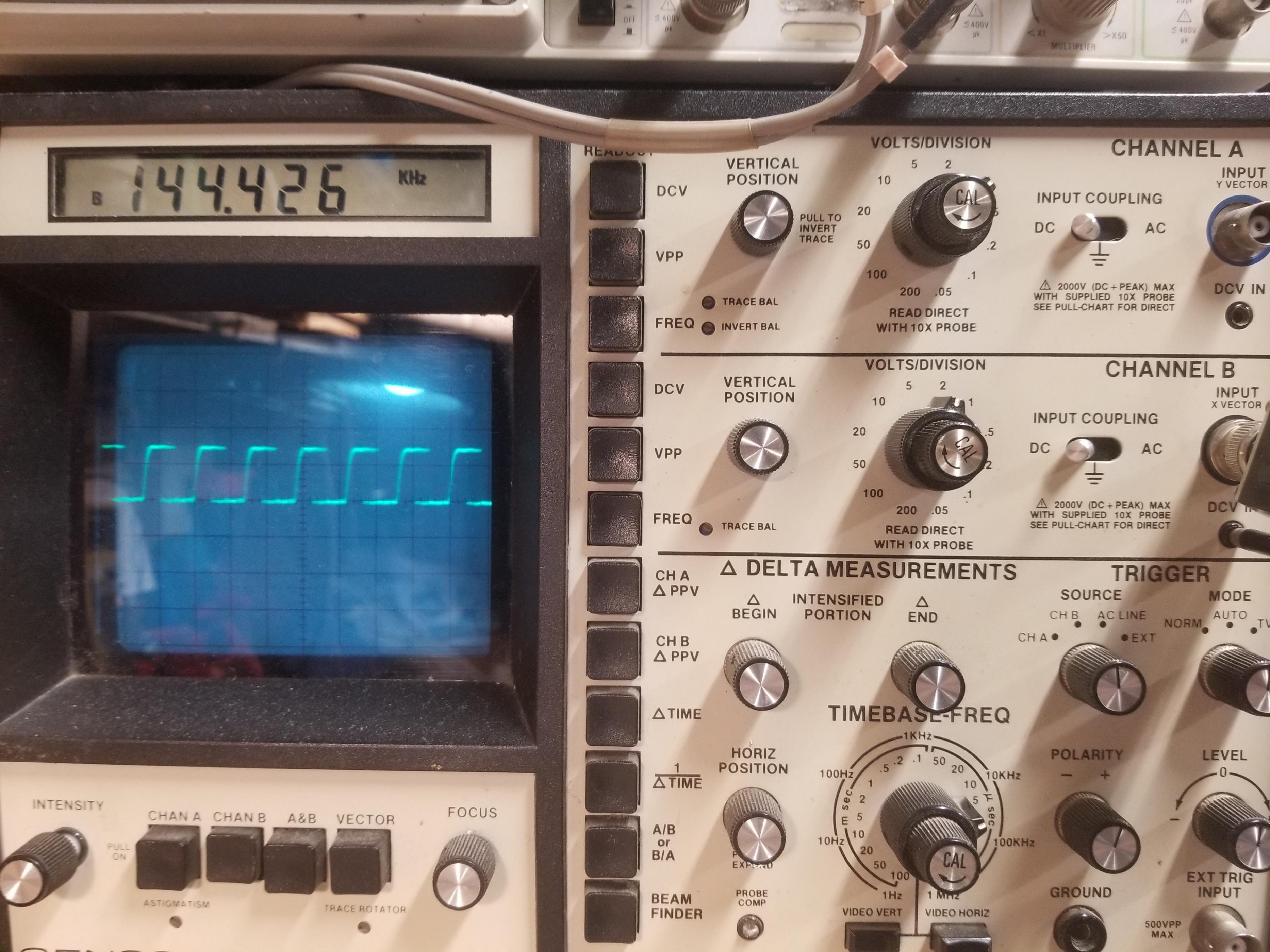

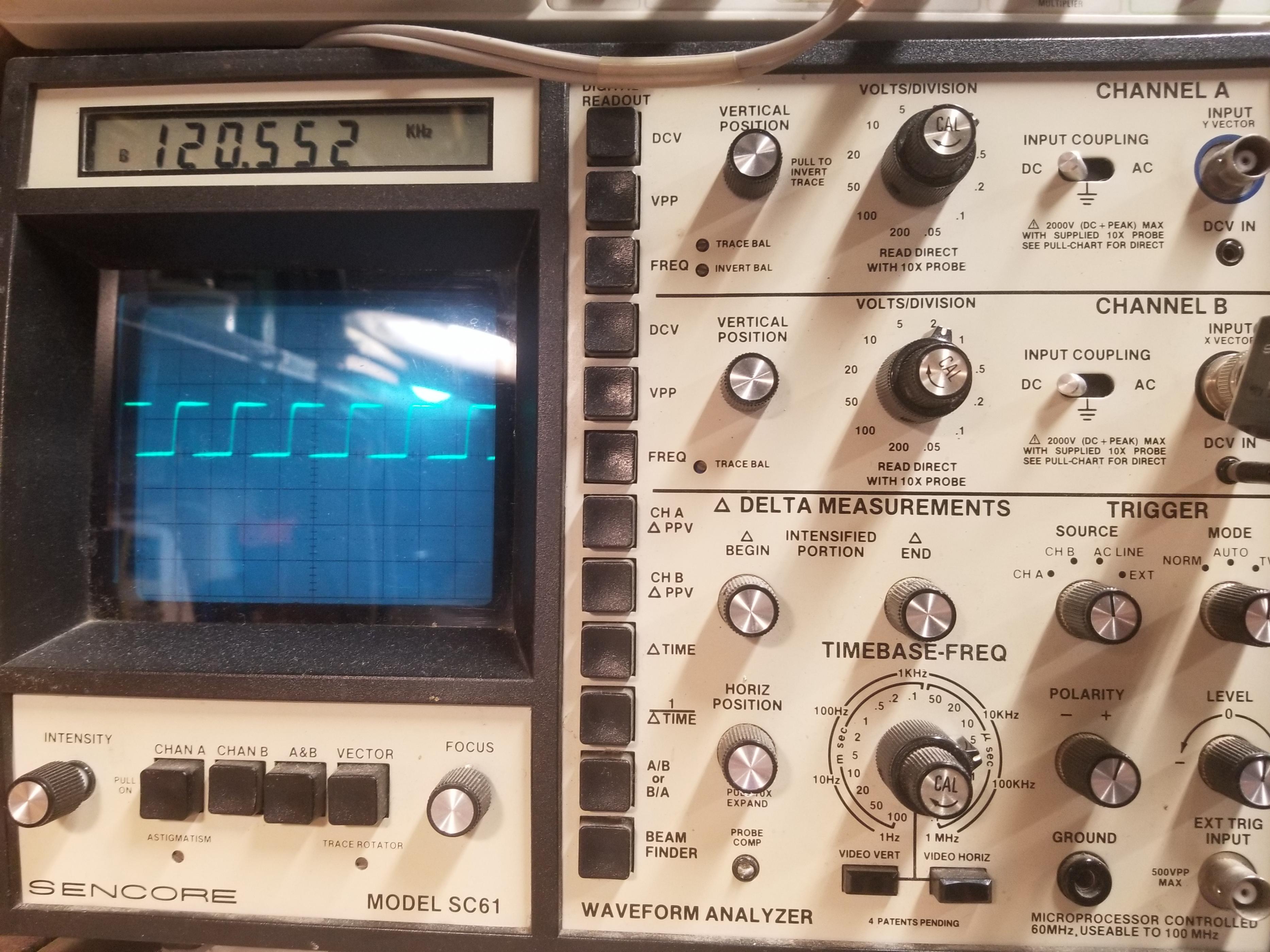

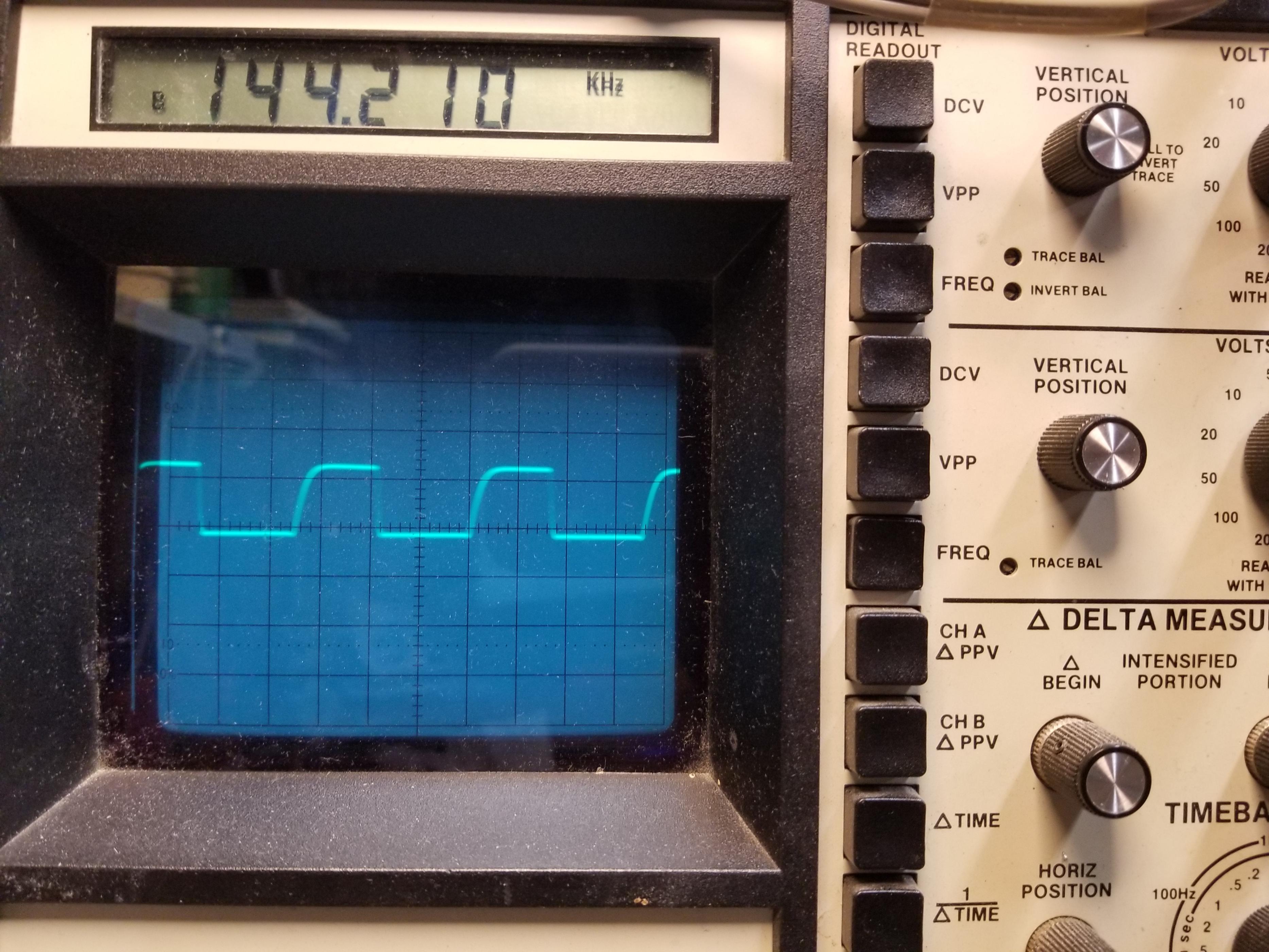

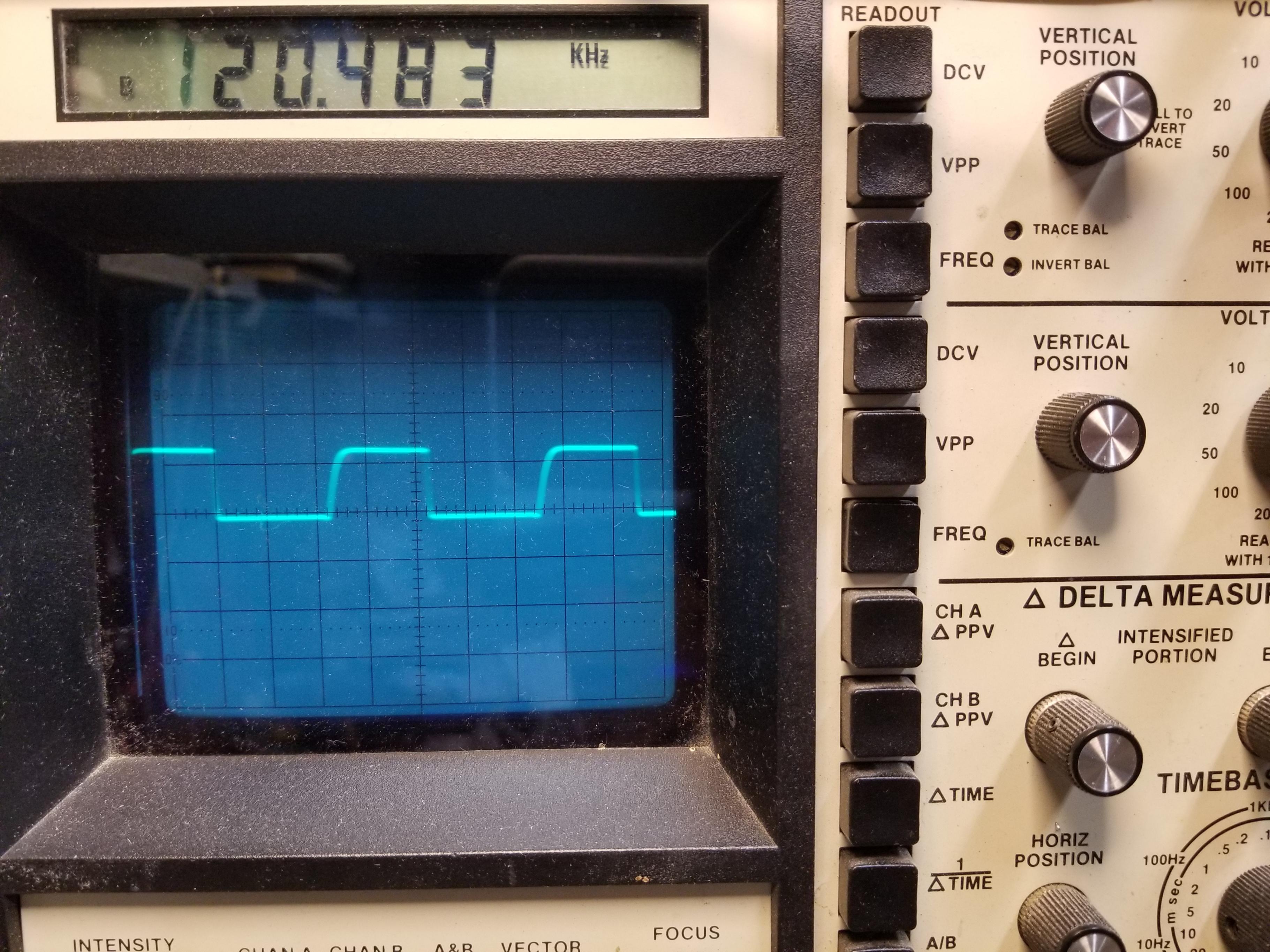

Hi. Working on an Audiopipe ACPL-30001D. The outputs on one amp board are running hot and will eventually short. The other board runs fine. I removed the rectifiers in both board to compare drive signals. Both look very much the same. The only difference I see is in frequency. The board running correctly is 144.4 kHz. The board over heating is 120.5 kHz. Gate voltage DC and peak to peak are very close to the same. Q11,12,13&14 driver transistors check good. Any ideas?
Here's pics with no input signal. 144kHz is the channel not shorting outputs. Taken at the gate lead.

I don't see anything wrong with the drive.

Some of this type amp are clocked and some are self oscillating. The self-oscillating ones vary greatly in frequency as the output power changes. 120k vs 144k should be insignificant. If it was 20k or 250k, maybe.

Follow up and hopefully ending to this thread. Drives to the outputs looked good. Put the amp back together. New set of outputs. Idling at 100 watts. Pulling 15 amps. So far it's playing fine. Not over heating on the outputs. Inductor seems to be heating evenly. Twisting the inductor makes no difference. I will let idle for awhile and crank it up. We will see. Thanks for the help.
