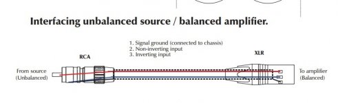

Hypex NC-MP amps are all balanced, but according to Hypex, they can be used from unbalanced sources by using the wiring as in the picture:Many Class D amplifiers hiss when using them like that. The shortest path is both units either unbalanced or both balanced. Any other attempt will cost more money and time.

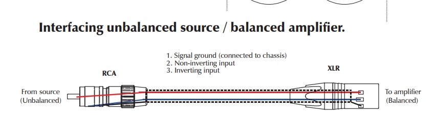

That amp is nothing more than Hypex module in a box, so it could be that RCA version is the same as using XLR version with basic adapters. To be sure you could contact audiophonics to ask how RCAs are wired. Recomendations from Hypex are in this NC400 datasheet
Theres also a good article about ground loops which also shows how to connect unbalanced sources to balanced inputs: https://www.hypex.nl/img/upload/doc/an_wp/AN_Legacy_pin_1_problems.pdf
That said, I have this exact amplifier in XLR (chose it for future proofiness). I was thinking about making adapter cable as described in Bruno Putzeys article above, but tried it with basic RCA to XLR adapters and have no issues with them. Although it might depend on your source, mine is not grounded, so theres no ground loops and therefore hum.

@Cerniu: very good links, I knew and saw the NC400 datasheet but the 2nd link with the proper RCA -> XLR connection is some hidden gem for me, I'll do that cable and go with that, together with the XLR version of the amp. After 1-2 years we can upgrade DAC to a real balanced (XLR) one anyway but until then, the little Topping E30 will be at least connected well to this XLR amplifier. Many-many thanks, I'm grateful for this article mentioned here. (Just for peace of mind I also asked Audiophonics guys but I'm pretty sure this pin1-problem article's method is the right way to go).

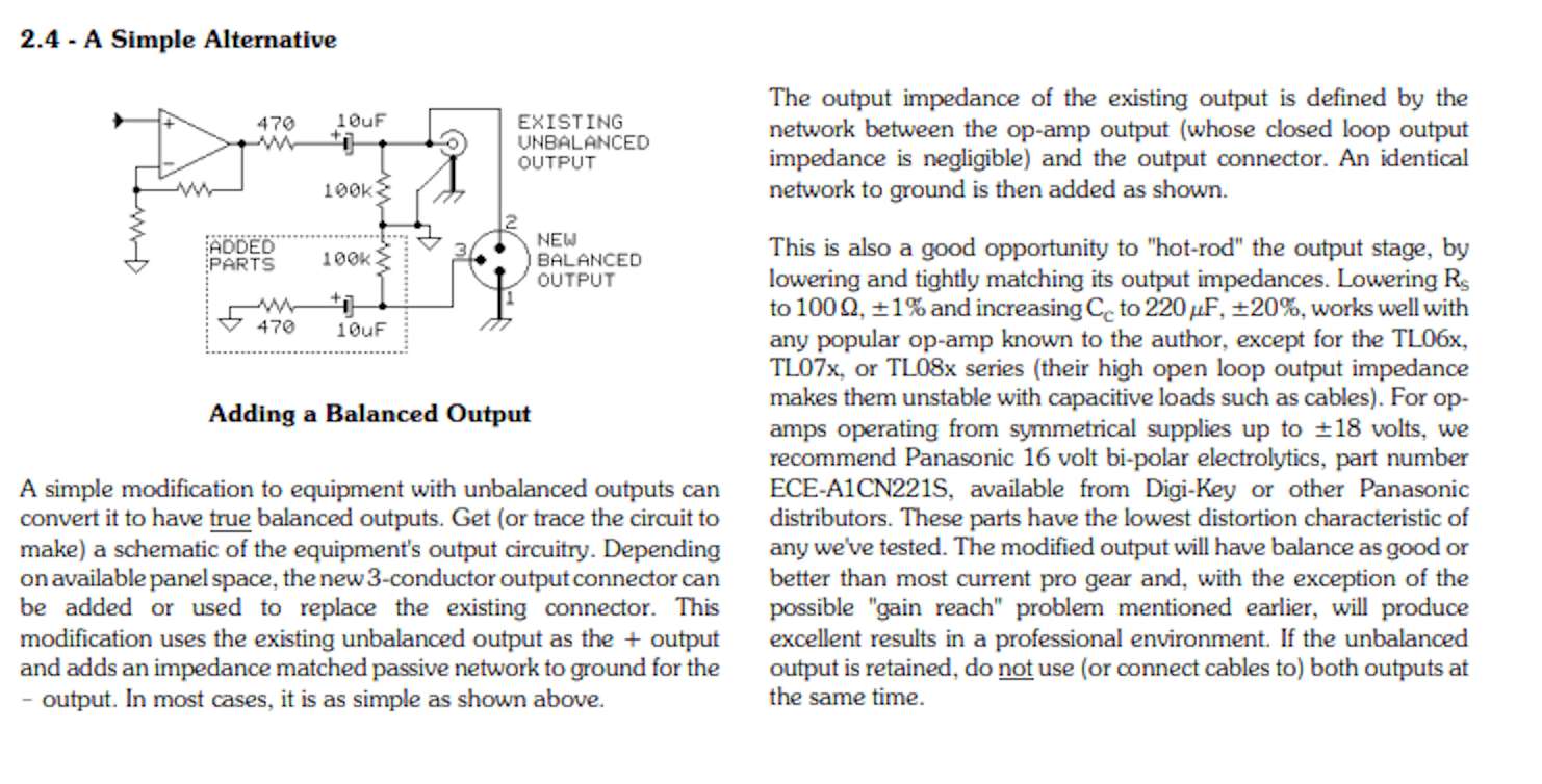

Just for reference - if we're talking about unbalanced to balanced - I just found a "Unbalanced to balanced - Jensen impedance correction circuit.png" in my DIY folder from many years ago.
It converts an unbalanced RCA output to truly balanced XLR output. Of course it's intended for device modding/DIY.
Don't ask me where it is from, I just put it here for all those who're interested. 🙂
Ah, here it is. (Long PDF, full article)

Audiophonics confirmed via email: even the simplest RCA to XLR cable is working flawlessly with the XLR-input Hypex.
