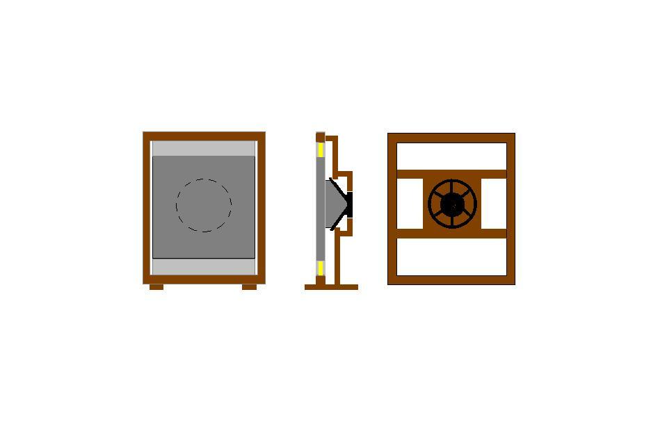

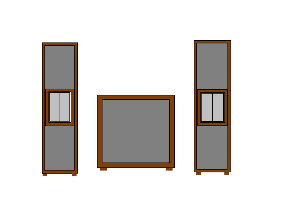

A long time ago, Dali, made a smaler brother to the Skyline. As far as I remember it had a dipole ribbon down on side and a 6.5" in a closed flat box, same hight as the ribbon (probably some 90 cm in hight).
The special about it was that a film membrane was stretched over the intire front of the bas cabinet (some 25 x 80 cm). The bass driver was then coupled to the membrane by the closed air between driver and membrane. This way they tried to get a more line source like radiation ..... if it worked? .... I have no idea .... but on the face of it I think it seems a bit far fetched ...
