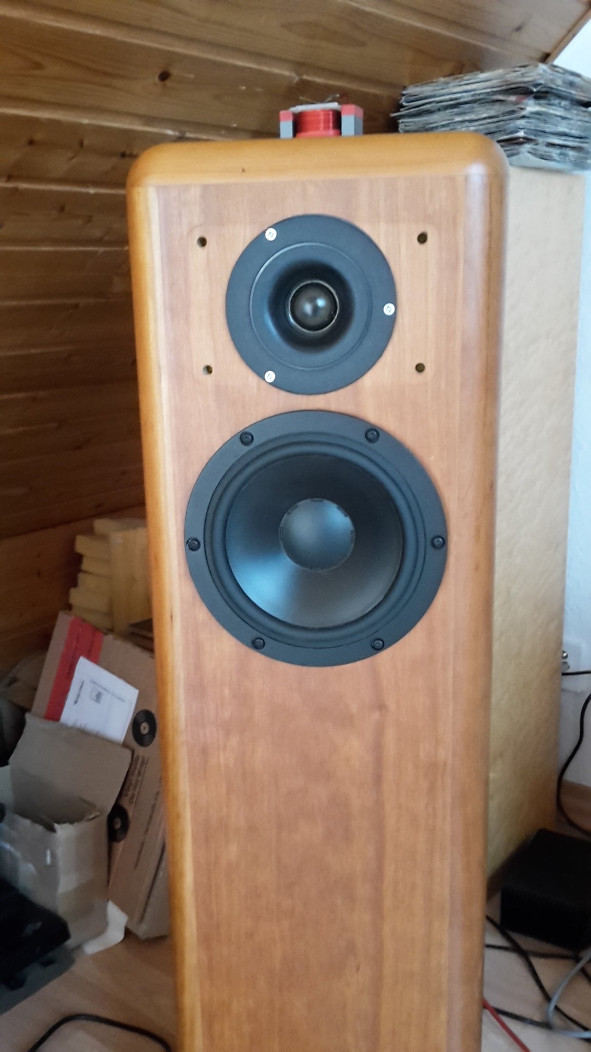

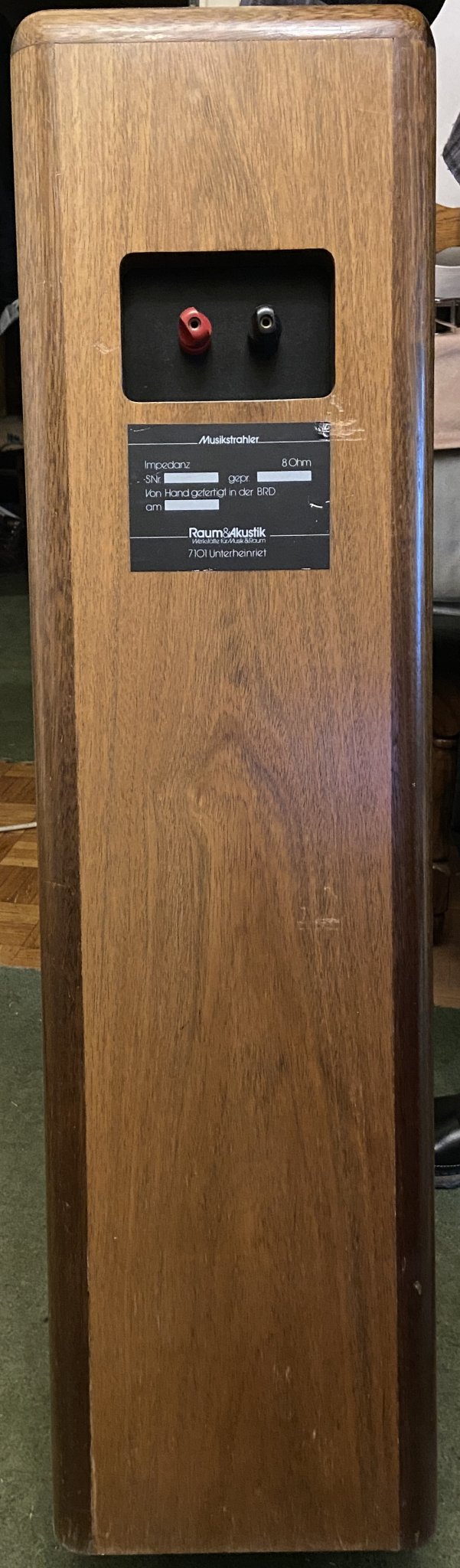

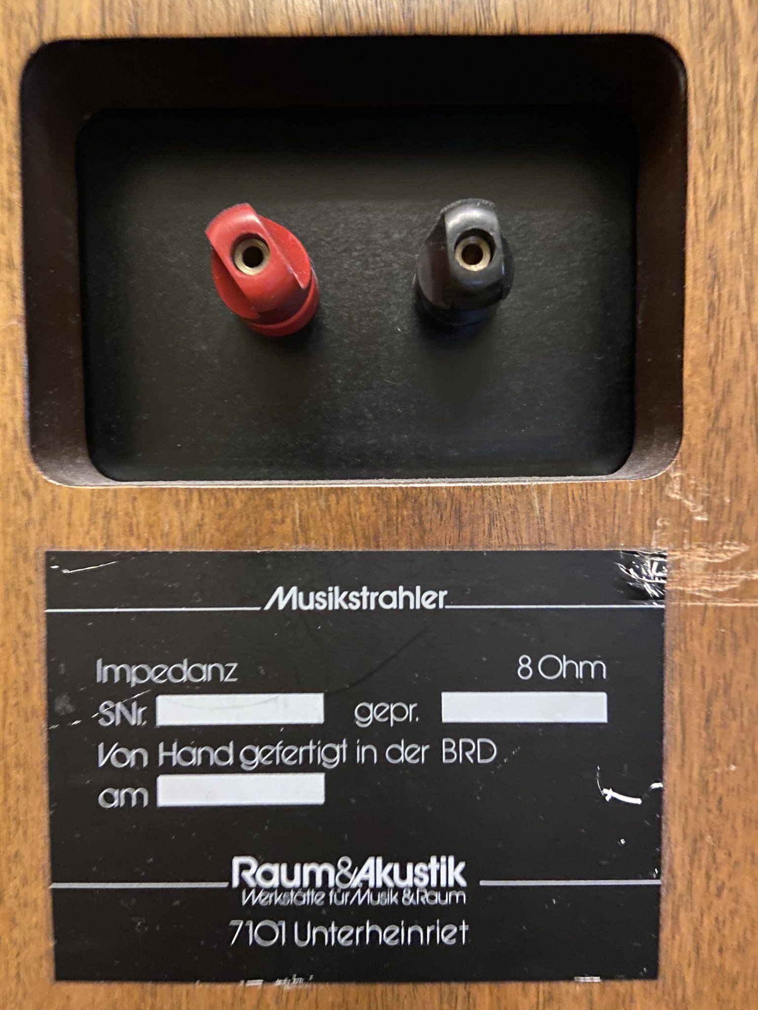

A friend of mine and myself got hold of a pair of AUDIOLABOR SPONTAN speaker boxes. The boxes and units are in good shape, but the crossovers were heavily messed with and it appears that not much (if anything) original is there - so, we need to rebuild from scratch.
Searching for info, we found the archive page maitaineb by Mr. Andreas Schubert https://audiolabor.de/index.php/2015-08-05-14-38-29/spontan and basic tech. reference https://audiolabor.de/images/audiolabor/info/spontan-info.pdf From what we;ve understood, it is a first order with cut frequency at 1600 Hz. Not able to get info on the origin/model of the speaker units from them.
' Would appreciate if anyone has any additional data on the units or the original crosover data/schematics.

True (besides the coarse image on the provided link) - they are a rare beast. They are at my friends premises currently - will try to make few shots.

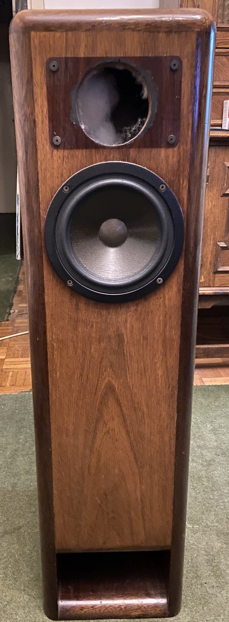

I managed finally to get to my friend's place and took few shots of the loudspeakers.

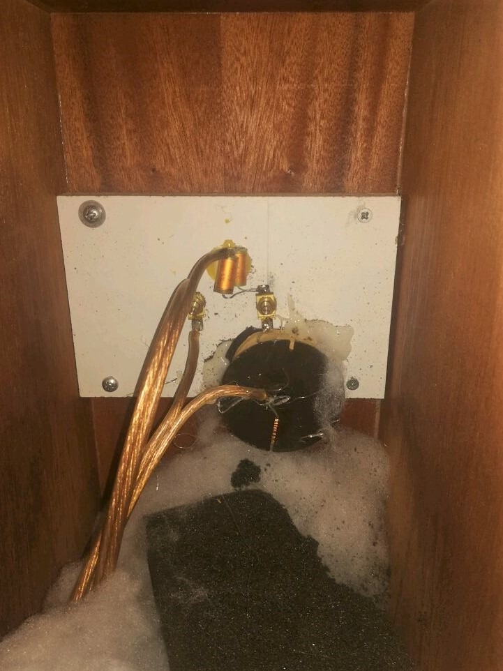

The last image is of the crossover.

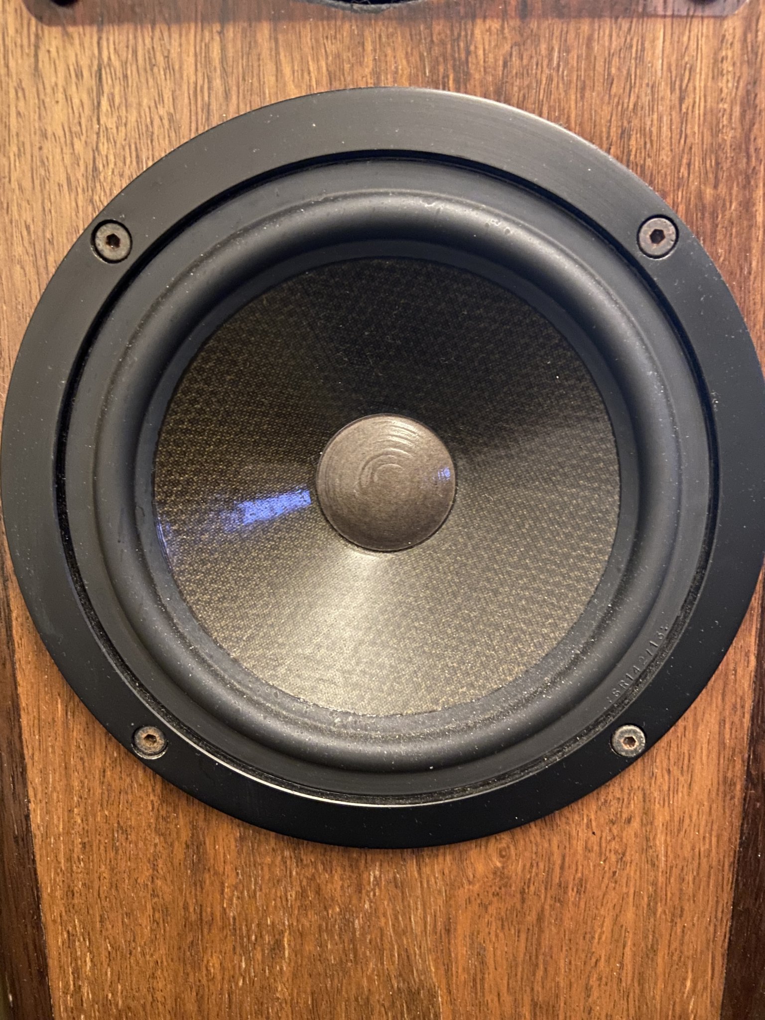

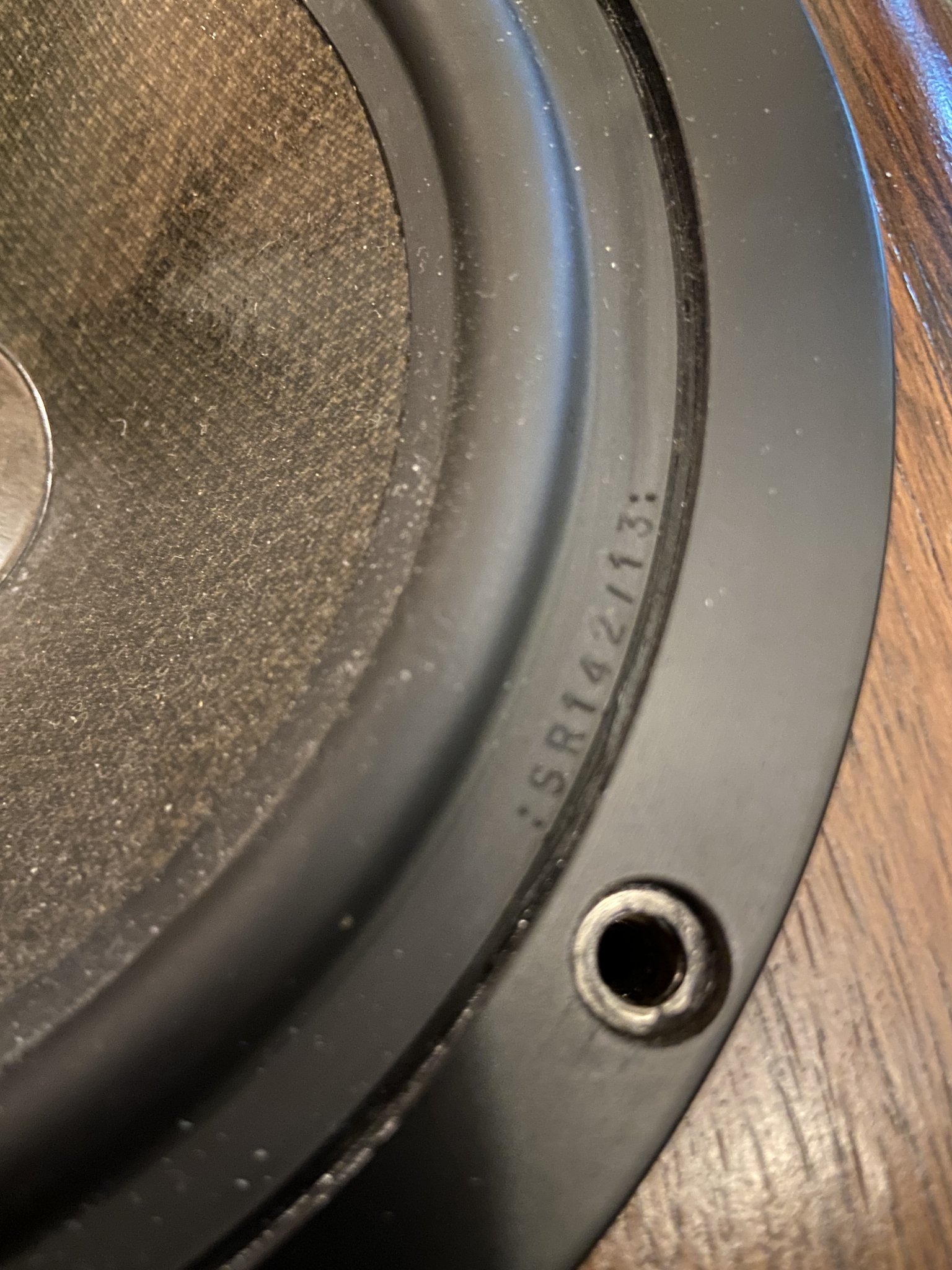

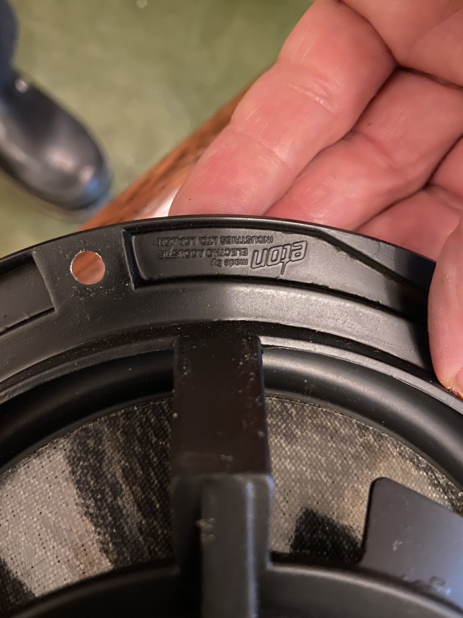

On bass/mid I found on the rim engraved "ETON made by ELECTRO ACOUSTIC INDUSTRIES LONDON" on the (back) and "SR142/13" (front).

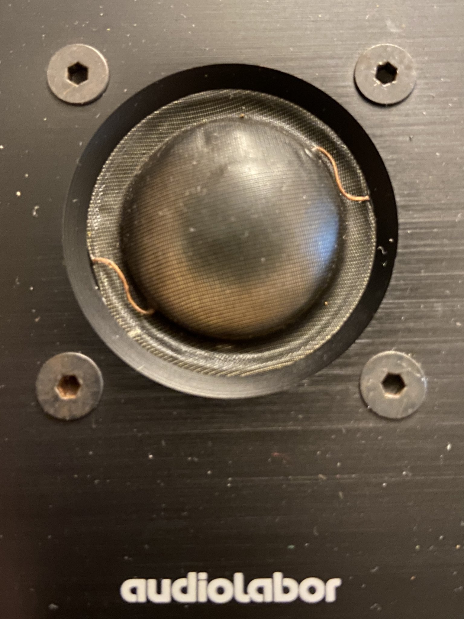

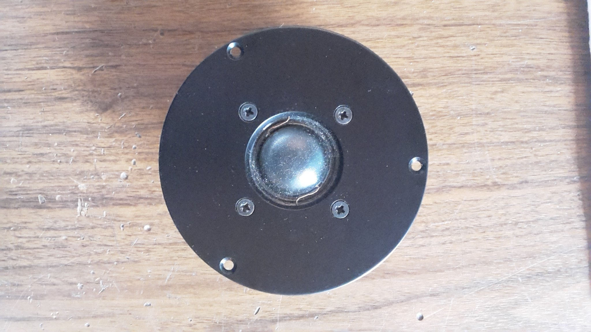

On the tweater I found no additional info.

We ususally don’t see Etons much due to the highish prices. The tweeter looks custom-made.
The XO looks like a simple C on the tweeter and a single L on the woofer.
Tweeter wiring (at a minimum) is WAY too fat.
Any indication of what thw inside of the box looks like? OInternal partition? Terminus?

With regards to the tweeters: I'd bet these are relabeled Dynaudio D21AF with a custom faceplate. The characteristic "s"-shaped strands to the voice coil and the rear shape of the magnet and pole plate are giving them away...
https://img.aussieaudiomart.com/upl...ew-dynaudio-d21-af-tweeters-wanted-to-buy.jpghttps://img.aussieaudiomart.com/upl...ew-dynaudio-d21-af-tweeters-wanted-to-buy.jpg
Of course there could be other modifications to the normal D21 like a different (or no) ferrofluid, but magnet and membrane seem to be the same.
The tweeter in the picture is seriously damaged ... and all old Dynaudio tweeters have ferrofluid that is soaked over time into the fabric/glue joint so the aluminium former is no longer firmly attached to the surround!
Dynaudio in Hamburg/Germany sells replacements but be prepared for shocking prices!
The original D2106 by Dynaudio is still unbeaten til today (precisely machined metal parts by hand) but the glue joint was a weak point of this driver .
By looking at the photo it seems with a 1st order HPF this tweeter was driven way too hard!
Even if you can clean all parts up inside you need fresh ferrofluid (the right amount and type) the distorted surround shape and partly deformed fabric dome means you still get a half-dead driver!
Better buy a similar tweeter and adjust the filter network to your taste! (measurements will help)
Is the other tweeter in better conditions?
Good luck!

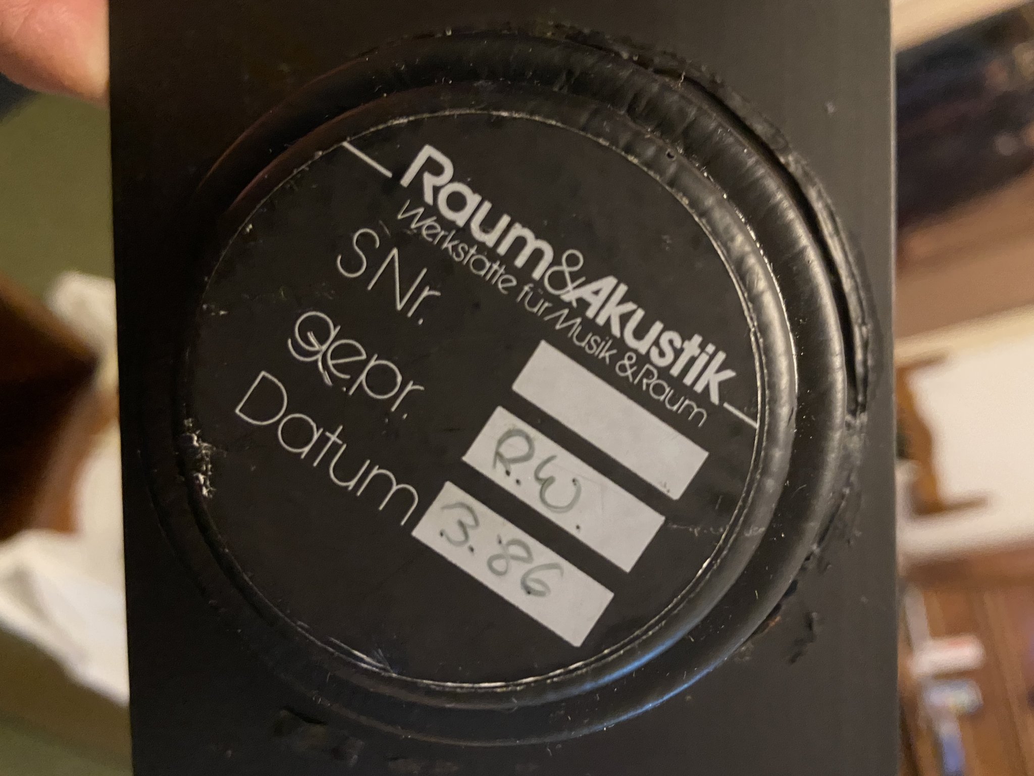

Re post 8 : the label in the 5th picture shows "6DC335" - this is the designation of the speaker used.
The print on the rubber surround in picture 7 does not show the speaker model, only surround type.
Re the crossover it is a simple first order, L 0,82 mH and C 3,3 μF with an additional resistor of 1 Ω in
series with the tweeter.

Tnx. We were aware of the crossover being 1st order - the question was if what we found inside was different from the factory provided. In the end we concluded it was not modified.
Tweeter is a Dynaudio D28AF!
Crossover is 6dB : 1,2mH for woofer and 6,8µF and a Resstor to match the highs to the woofer frequency.
Crossover frequence is 2200Hz .
A newer matching tweeter will be Morel MDT30 or MDT33, but than you need another custommade Tweeter faceplate.
