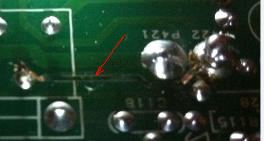

Having used my Audiolab 8000p on the previous night, it now appears to have stopped working on both channels.
When powered up I can hear the transformer hum, yet I do not hear the relays clicks as the once did.
I took the lid off to find one of the track wires which runs from relay RY301 to P422 to have burn't out.
Is it possible that the relays have caused this problem?

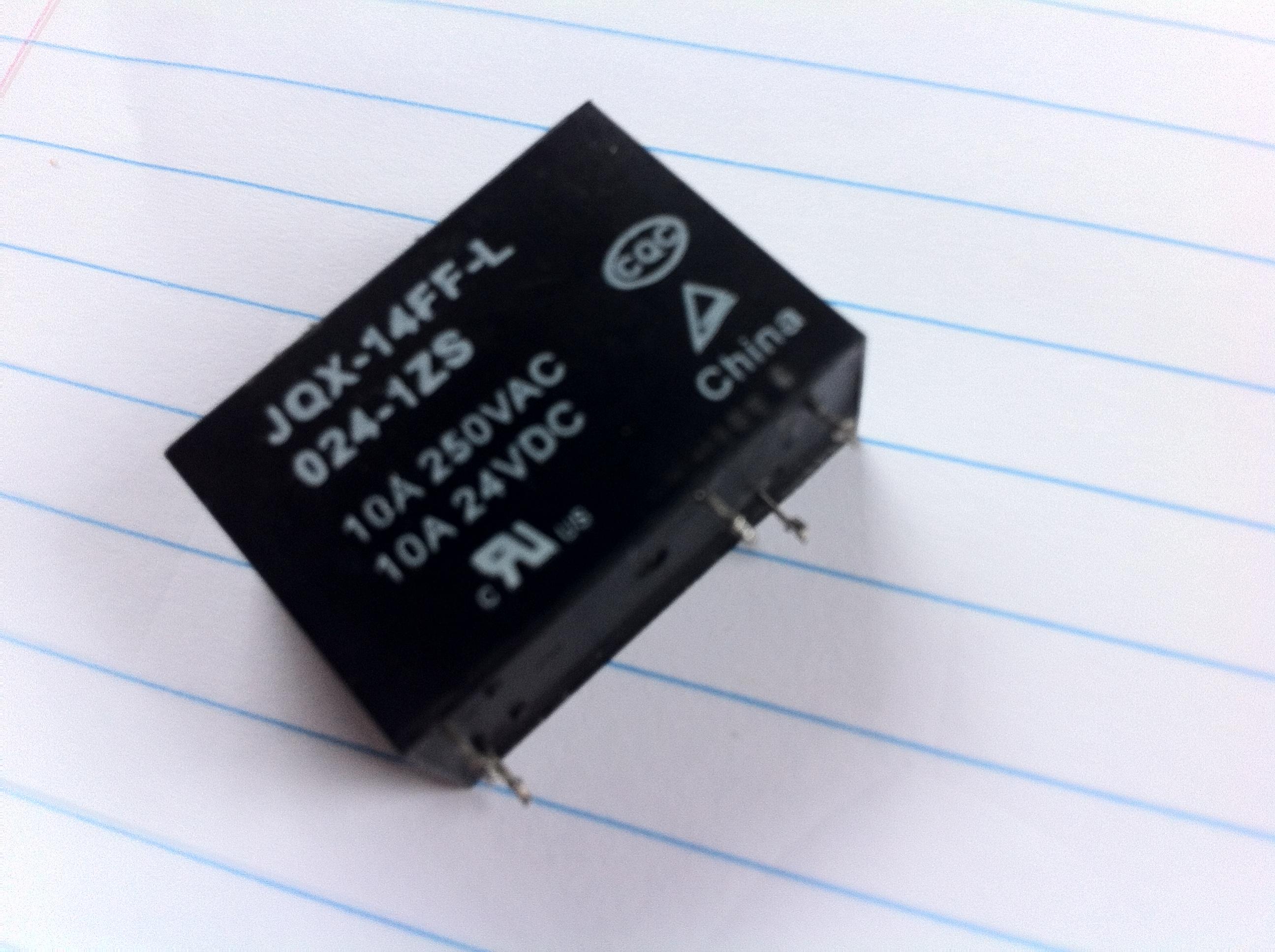

I have jumped the gun a little and ordered 2 x OMRON G2R-1 DC 24V 5PIN in hope this could be the case.

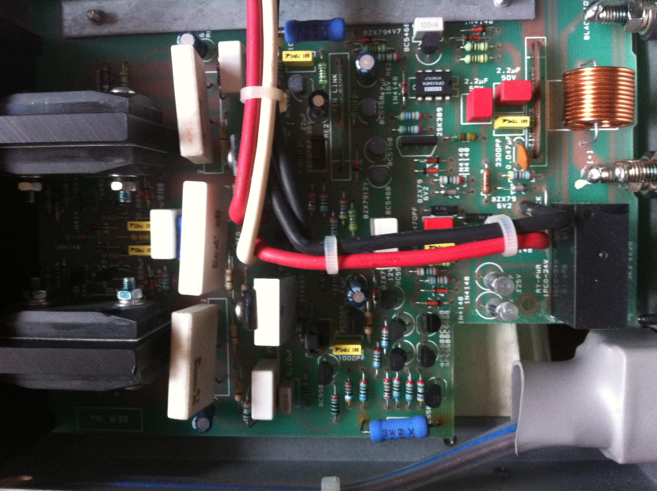

Have you measured the output transistors to see if any are short circuit. That would be the very first check really. Without seeing the circuit I would guess the relays are probably DC offset protection for the speakers.

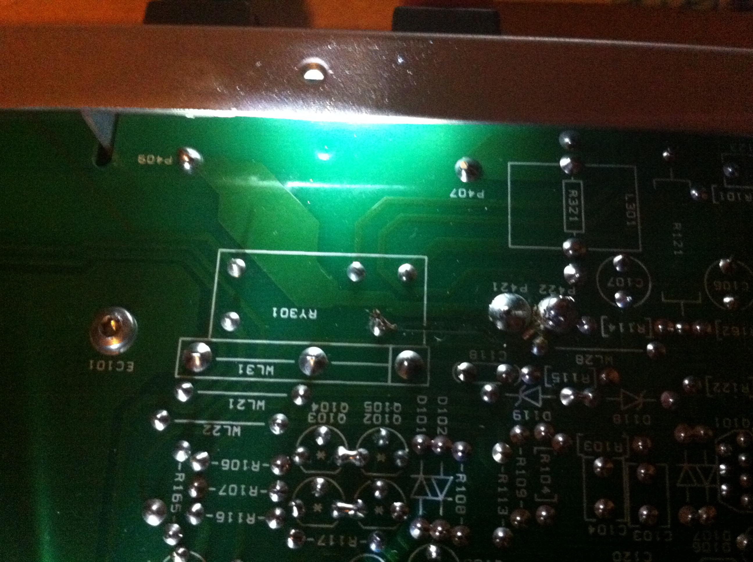

is the burnt trace going to the coil or one of the terminals?
Not sure, here is a pic of the relay's side.

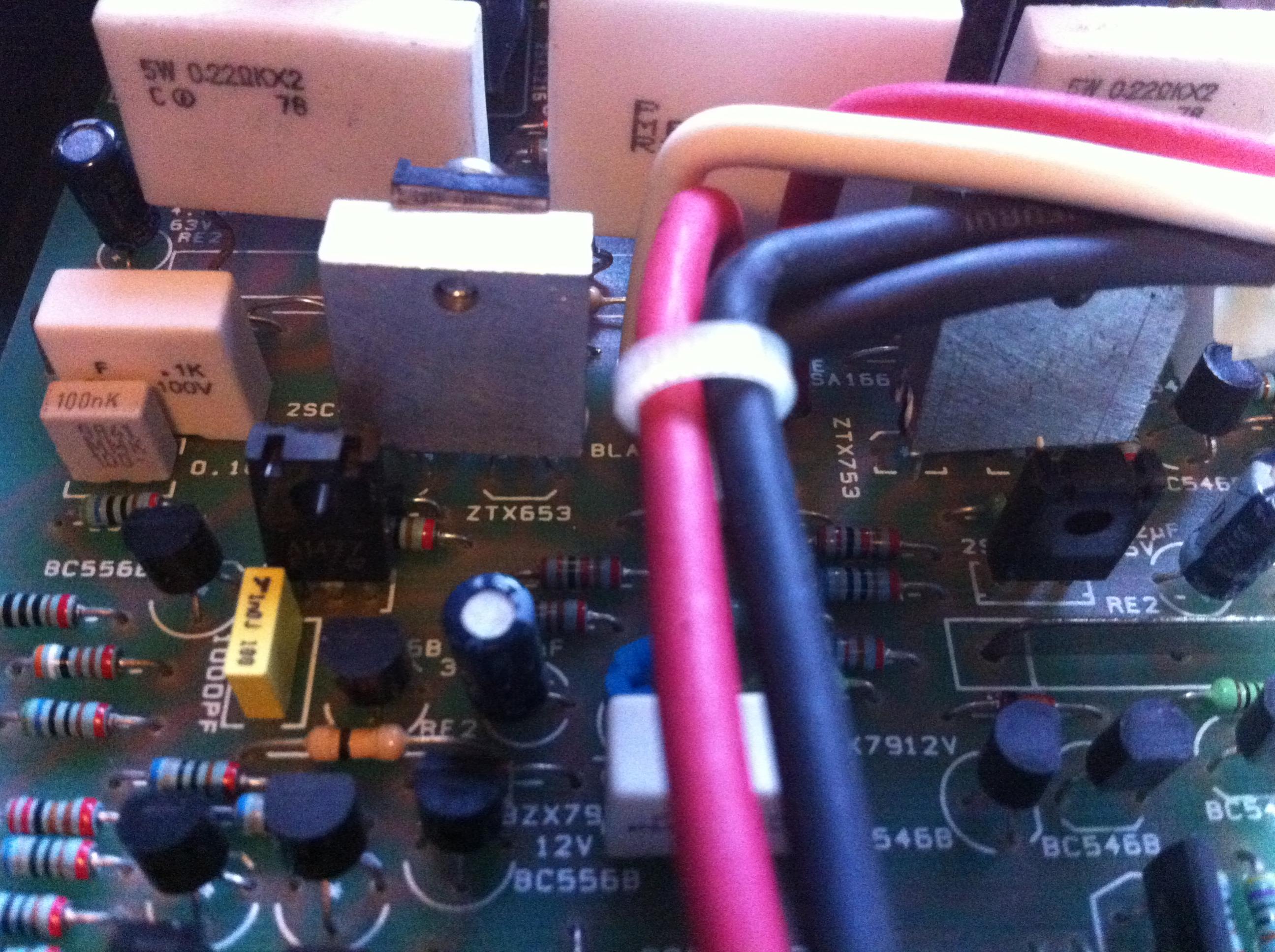

How would I measure the output of the transistors, and what am I looking for, where about's on the PCB? Sorry, I'm OK with a soldering iron, have a multi meter, just not very electronic minded.
The Audiolab was driving some Jamo THX speakers rather hard the night before. I came in the next day, started checking my levels with test tones, heard one of the Jamo's make a funny noise, then found one of the speakers woofers has fried as a result, also the Audiolab would not output.
You need to check the output transistors for being short circuit as a first step. Also locate that print on the circuit and see what it really connects to and what components it links.
tbh the relays would be the last suspects although if a substantial current has passed or been "broken" by the contacts then they may have suffered. They won't be the cause of the fault though.
I was driving some Jamo THX speakers pretty hard the night before last, when I came home yesterday I checked the levels with a test tone, as soon as I tested one of the Jamo's it made a quiet funny noise then smell, I tested this with a multi meter and found that woofer driver had fried. Output from the Audiolab had also stopped.
Not sure how to test Transistors, any tips? They show no sign of browning.

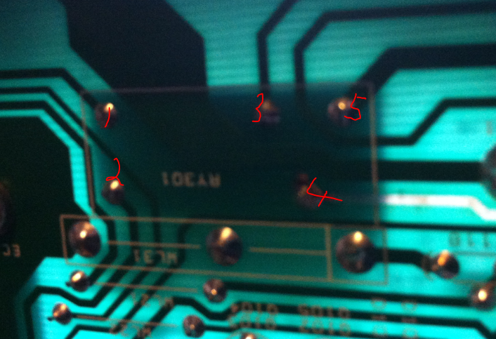

Not sure, I have posted another pic.
From looking on line I guess the coil is on the 2 pin side, so this must make it the terminal side.
Looking at the relay from the back of the Audiolab's pcb, 2 pins on the left 'coil', then 3 pins on the right. The Right hand channel 3 pins bell differently to the left hand channels?
So it seems the right hand is welded open?
see pic.
Right hand pins 3 & 4 bell out
Left hand pins 4 & 5 bell out

I've checked the Transistors, they are all reading between .453/.656V
The relay contacts are changeover or SPDT type. The amplifier output will be connected to either of the 2 grouped terminals. It will be difficult to tell what the relay position is supposed to be if the contacts are welded (and welded means welded together). Remove the relay cover carefully with the aid of of a thin knife point to simply verify that the relay action is free or stuck in one position.
As you have spares on order, the bigger concern is the output stage. i.e. output transistors, driver transistors, associated resistors, rail fuses and power supply fuses. Don't assume all is well there unless the transistors are working in circuit or at working currents. The output transistors are expensive and difficult to come by. Some large service parts distributing companies in the UK and represented elsewhere, seek to make high margins supplying those big Sanken semis.
It is better to find out the bad news now, as Mooly indicated, rather than later when you have wasted time and money on the wrong problem. In any case, the PCB trace is repairable with an appropriate length of enamelled copper wire, so long as it is restrained from movement and causing later woes.

Transistors seldom fail with visible signs, perhaps because of brief fault duration. Power resistors, such as those fitted to the emitter of either output transistor, can be ceramic encased and show no sign either but the round, coated types do show visible signs since the wire winding is visible through the thin coating. Small carbon and metal film resistors may show only tiny holes or scorch spots or even be reduced to a charred black stick but you can usually check these by comparing resistance measurements with their counterpart in the other channel. Be sure to do this too, when rechecking your transistor measurements.

Whilst you have the relay out, you could flash the output of something with 10-30V DC across the coil terminal to see if it does "click" when power is available. That will also indicate whether it's welded, if the coil still reads continuity with your meter.

I have checked the relays as you said, and the one with the burn't track is not clicking.
Can I still check things or should I wait for a new relay?

The low value emitters, c110 & c210 are both sat on .69V, the other 2 c111 & c211 set off around .3V and rise.
