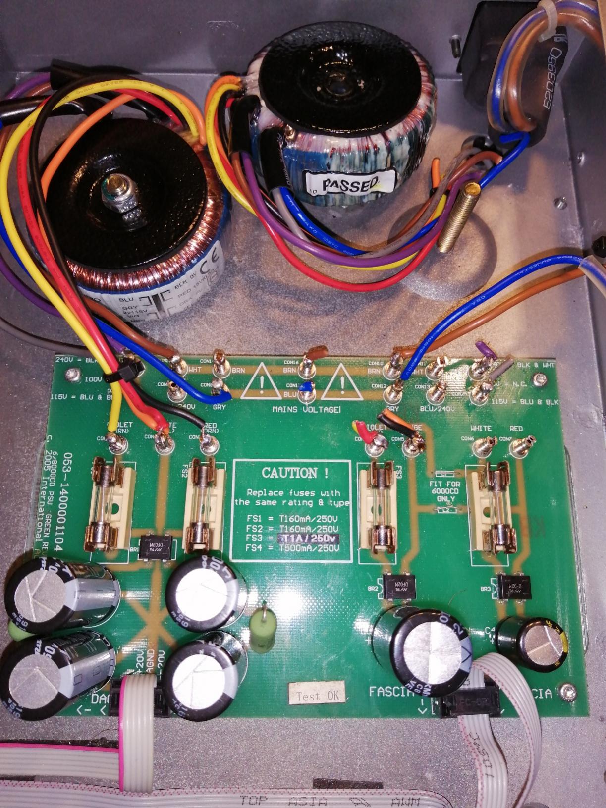

Would appreciate any thoughts on this:
I'm using an Audiolab 8000cde for about a year.
I left my system powered last week overnight.
The CDP was dead next day. Transformer was blowing the 1A delayed mains fuse (also blewafter I disconnected transformer from the PS.
I couldn't see any signs of heat stress etc. elsewhere. Got 2 new toroidals to replace the single, multiple secondary one.
This was fine a for a few days - no overheating, buzzing, no excess current measured through the fuse holders.
Last night the 'Uh-Oh' smell started again.
The CDP had been on for 4 hours, played a few discs, and was just sitting there powered on afterwards when it happened.
Mains fuse blew again and the transformer feeding the digital circuits' power supply was nicely broiled. Grrr.

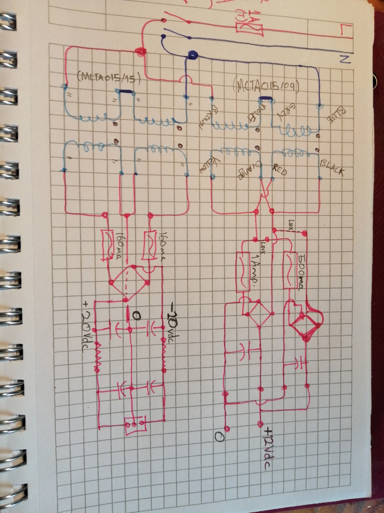

More details: the digital power supply is in two parts, fed from one xformer's dual secondary windings paralleled.
Both sections are fused, one is 500ma and the other 1A. My replacement transformer was specced at 1660ma total secondary output.
Possible conclusions:
I wired it up incorrectly or over tightened the clamp.
The transformer was faulty or under specified.
A component in the digital circuit is failing.
I'm rechecking everything but I do not think it's an installation error, nor a faulty transformer as that would be incredibly coincidental.
Does anyone have any ideas on where to start troubleshooting?

Thanks. To clarify: I disconnected the original transformer to test it separately. It blew a fuse again because a secondary was almost shorted out.
NOTE: The fault is on the 12V 'Digital' supply, there are TWO fuses, bridges and supply caps. Today I see that both these rails are soldered together again at the output cable connector block!
So on the 8000CD, they used 2 separate xformer secondaries, and separate rails.
The 8000CDE has this all linked up. Bit weird.

1. Did you use rubber pads to mount transformers?? Also, see here:
Rasing toroid transformer off the chassis
The metal plates look too stressed... I think you should not tighten the bolts so much
2. The paralleling of the bridge rectifiers is done to increase the total current available at 12Vdc terminal. It should work okay.... but, you could just make a nice bridge rectifier out of 4 soft-switching fast recovery diodes and then you do not need 2 paths
3. You could insert two 1-ohm 10W resistors instead of fuses in 12Vdc line; to measure the current on that line... the other rail (+ and -20V dc) already has two resistors, so you can confirm that the current is within a normal range right across them

The chassis has raised mount areas for the transformers and the replacements were similar inner diameter to suit the mount.
Neoprene pads supplied and used.
I was careful not to overtighten, and the 'remains' do not show signs of compression, but it is definitely possible.
I did a few hours burn in, and tested current across the fuseholder with a resistor - all seemed well below fuse ratings and not enough to be stressful.
Might try a bench supply on that rail for a few hours and see if it intermittently uses a lot of current.

Oh! The fuses are pre-recifier so my current reading may have been incorrect.
I'll try that again with a 1 ohm resistor inserted in series after the supply.

You may have a doggy capacitor somewhere. However, you also have a laboratory power supply which is great. You could use the lab PS for 12VDC rail, and then increase the current until, hopefully, a dodgy capacitor (elsewhere inside the player) will overheat and pop.
That's a good idea, if it tests ok after 24hrs it was my error or transformer factory fail. If it pulls mega current and something gives... convenient way of knowing what, eh, gave after taking too much? 🙂
