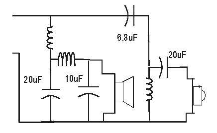

I am building a set of 4pi speakers (2-way with 15in JBL2226 woofer and high frequency horn "tweeter"). If I use Audiocap Theta's for the high frequency driver, what caps do you think would work well in the woofer crossover? The cross-over frequency is somewhere around 1khz.
The crossover caps are in this configuration (woofer caps in parallel to the driver):
Do you think the Theta's will work well in this design? Thanks, David

The Theta will work fairly well. The "go to" would be Jupiter Vintage Flat Stacks, but we are talking a fair amount of coin ($$) difference. If you proceed with the Theta, I'd use the Sonicap G1 for the low-pass.
