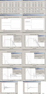

Hi gaz,
Your driver has a Qts not favored(IMO) for quality BR designs even if using a large long slotted port because the box would ring like a bell unless you stuff the entire enclosure including the port.
See the picture and you will understand my points:
b🙂

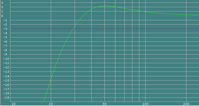

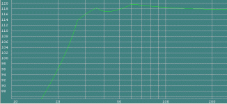

Hi, here's a Bass Reflex 100L box tuned to 30Hz with 1 x 75mm x 150mm slotted port. 1st port resonance @ 432Hz. Max safe power is limited to 400W though, but still !
