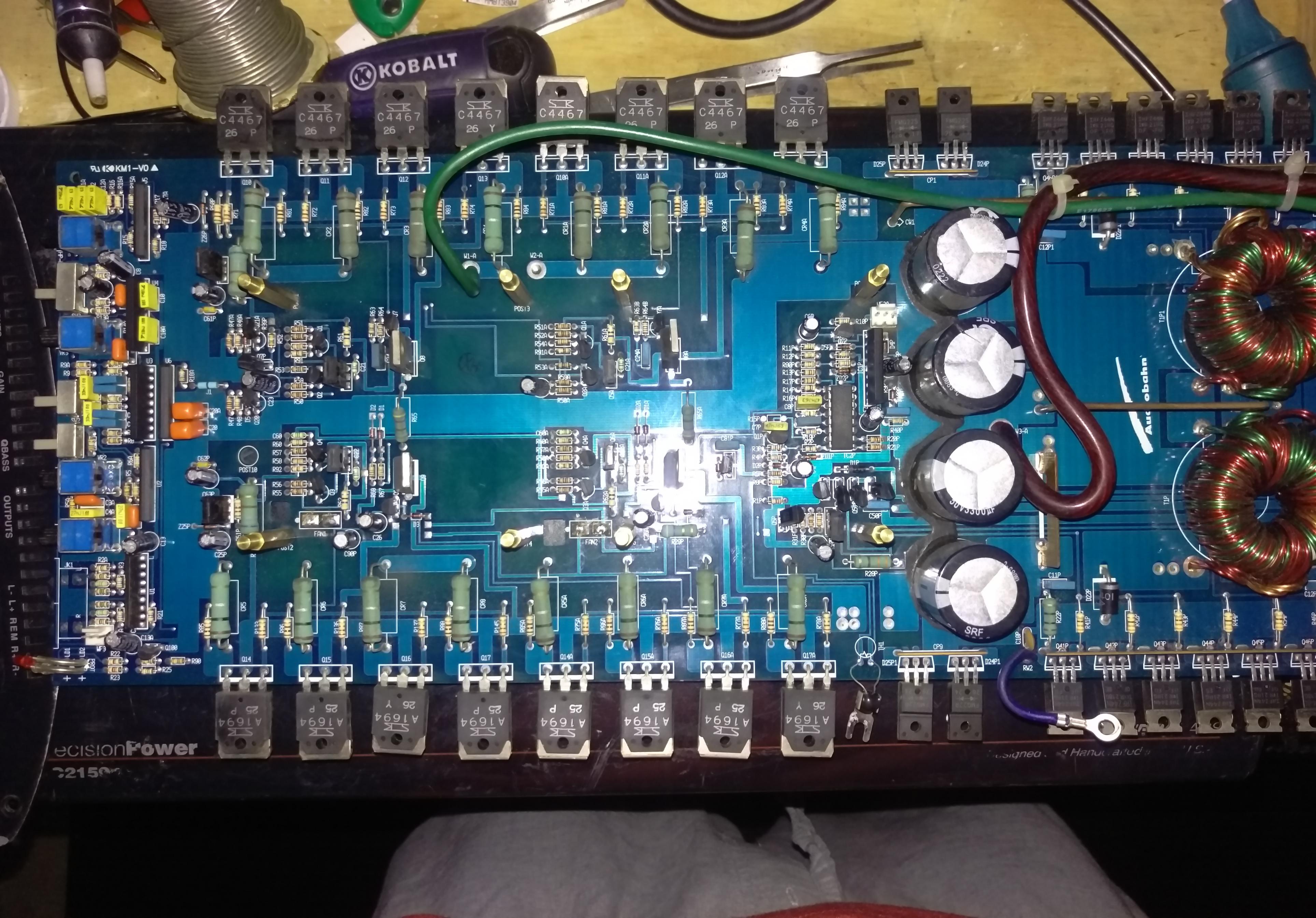

Ok so I blew some dust off a giant monster amp in my shed lol. It's going straight into protection and drawing over 3.3a at idle. No outputs nor the ps fets appear to be shorted or damaged?
Are you sure it's in protect? Most audiobahn amps shut the supply down when in protect.
Post a photo of the board.
That what it seemed like perry when i got the amp the fans where off the riser's and jammed up, so i fixed that and cleaned up the mess from having them. Not sure what they actually do, being on the inside like that? after cleaning it up, it's running, drawing the proper ammount of current which seems high 1.34A idle. Im having issues with the site and posting pictures recently?
