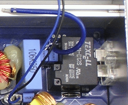

Perry can you show me with your photos on any amp what the relay looks like? and what drives them?
It's the black box in the corner in the photo below.
The drive circuits vary. If there's a diode near the relay, it's likely across the relay coil. You can measure the voltage across the diode to determine if the voltage is being switched on/off as it should be.
