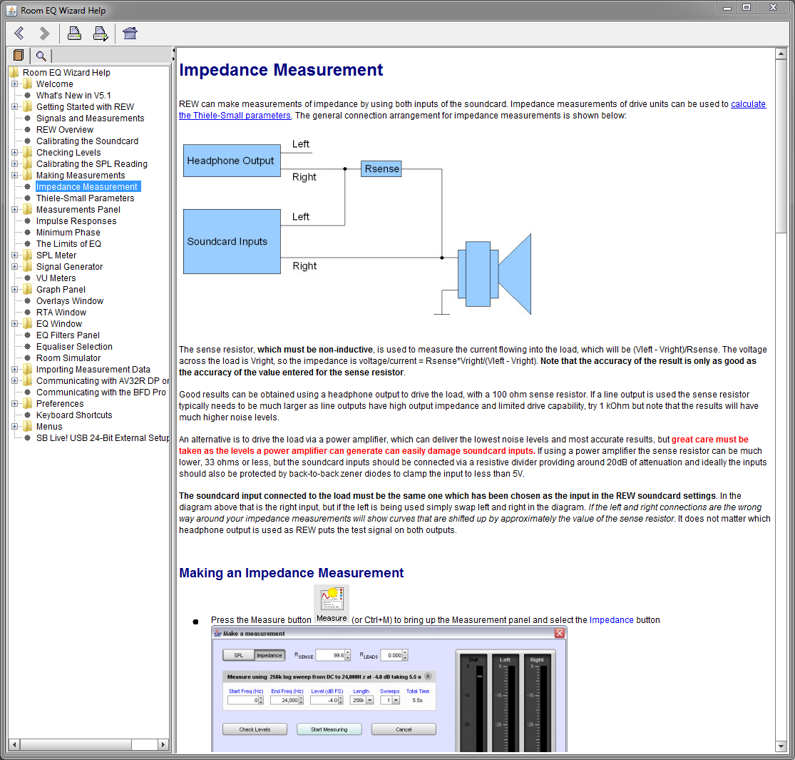

Because i have it use a DATS device for impedance and T/S specs, but free REW can do same via soundcard, see below from help menu.

Thank you, I will check that 🙂.
