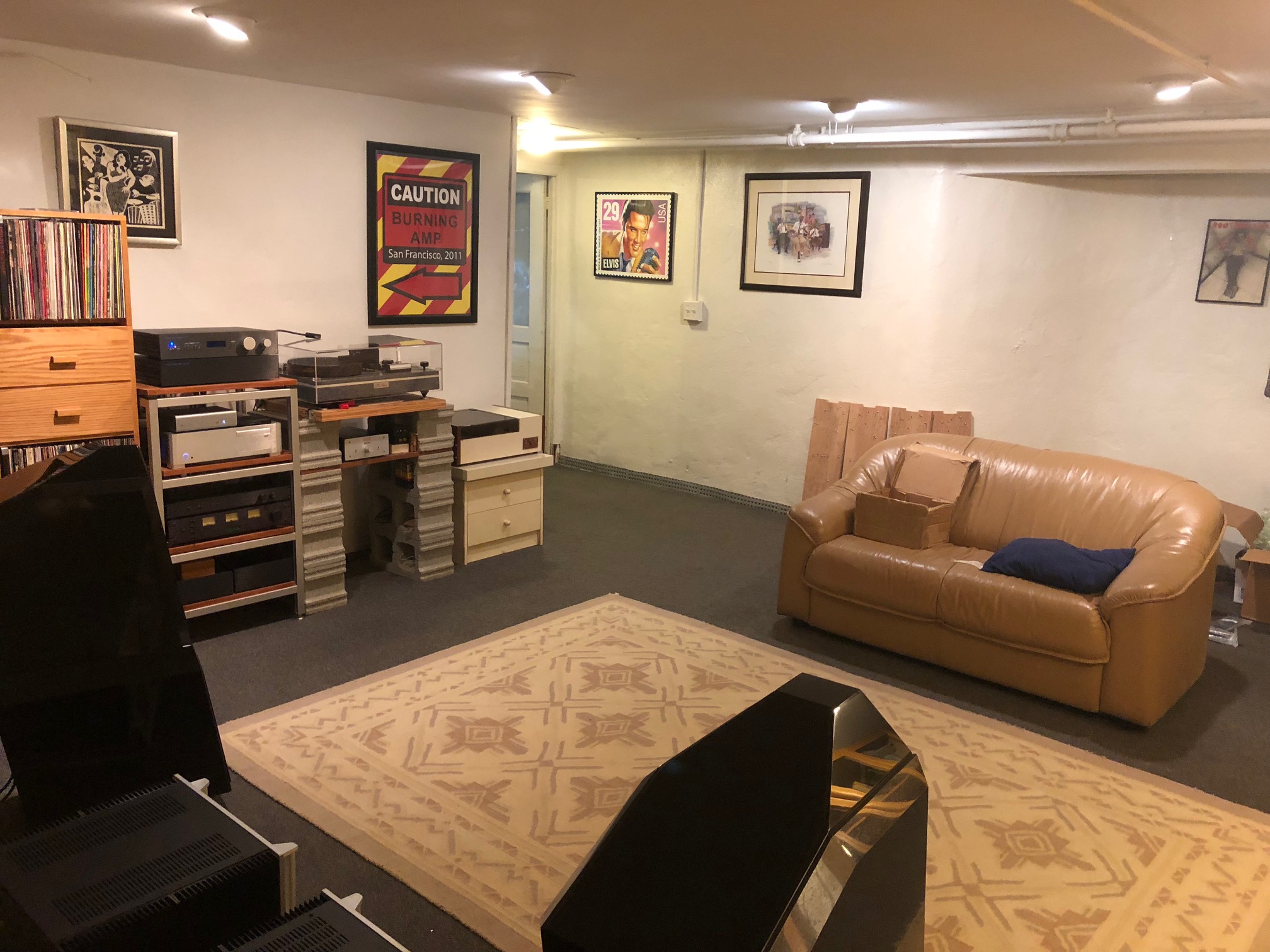

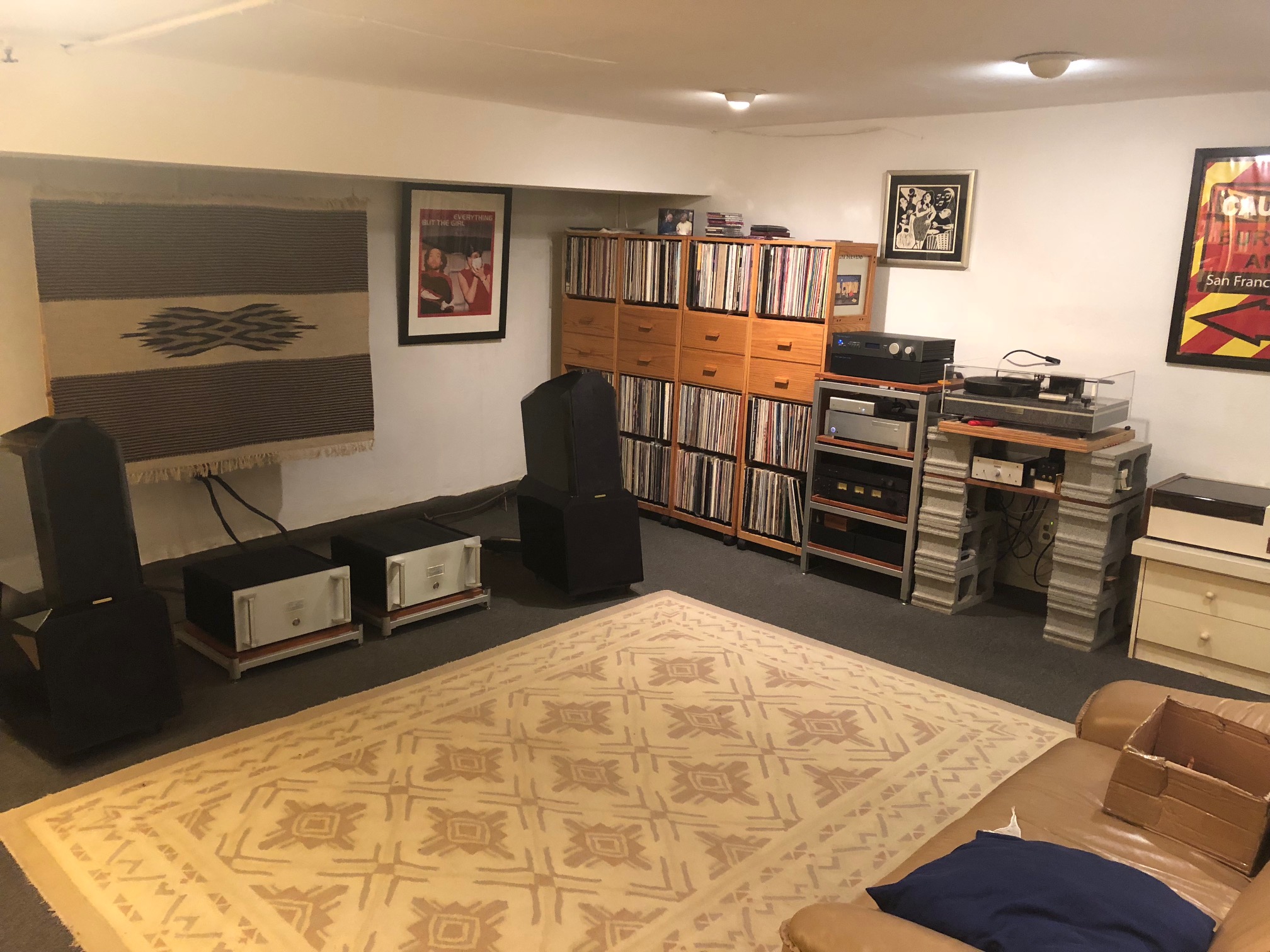

ChrisM91:
I can only speak for myself; I have no expertise other than from personal experience. I built an equipment rack using Bosch Rexroth extruded aluminum struts about 10 years ago; the struts are available in multiple sizes and designs, are used extensively in industrial applications and are also used by many of the commercial manufacturers of audio equipment stands. They are strong, versatile and attractive. The line also includes a variety of connectors, feet and other requisite parts. I got a good deal at the time, but Bosch's products are on the expensive side. Competitors have crept into the market and the struts are now generically referred to as "T-slots." I have since built amp stands and the turntable stands using competing products from 8020, which is priced below Bosch. You can also find extruded aluminum struts and connectors on AliExpress at an additional savings (though I have no idea as to the quality).
Add some shelves and the results can be quite attractive. The photos are of my basement music room before it was renovated (note the cinder block turntable stand). While my speakers, preamplifier and phono amp have all been upgraded, I have no plans to touch the equipment rack.
Good luck, whichever direction you go.
Scott
