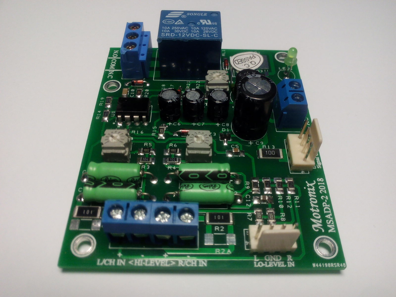

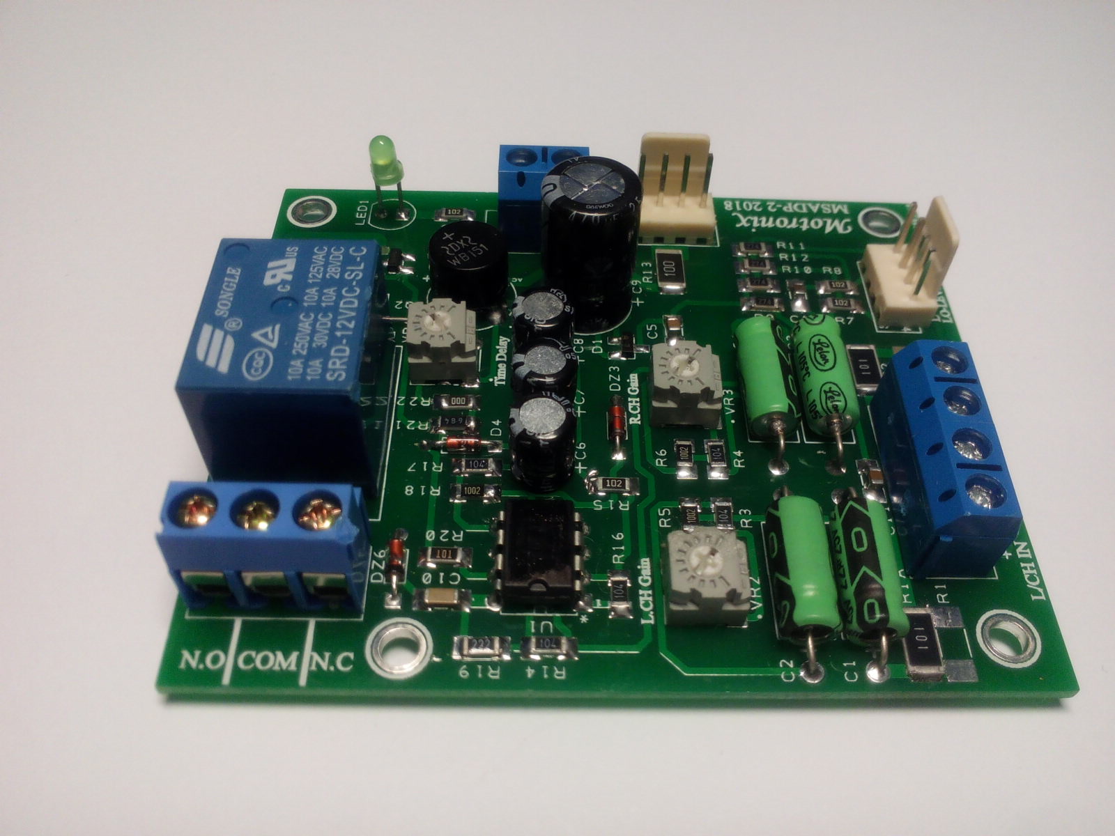

My pcb for this
MSADP-2
Audio Input:
Hi Level & Lo Level
Audio Output: Lo Level with gain control
Turn on delay: up to 6min.
