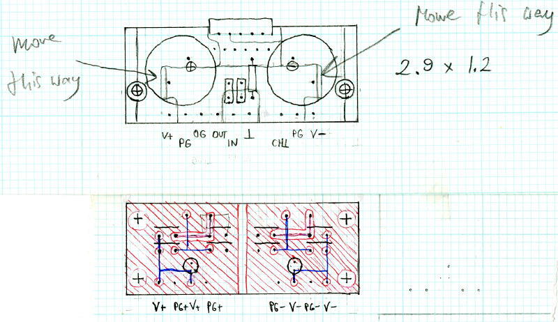

I understand you are talking about old production boards I was selling together with Brian before we split our operations. Those boards were actually designed by me, with Brian doing some final touches. It all started with a simple drawing you see in attachment.
They would be basically the same as the current Audiosector boards, with possible exception of not having Zobel components option.
